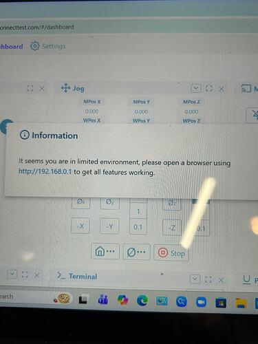

I am trying to set uo jackpot 3 w/o endstops. I get a message abt limited environment & another abt disabling endstops on jackpot 3 . Is there a step by step procedure available to do this ??
The limited environment warning is because you’ve been trying to use the GUI from the captive portal browser popup. That is a highly limited environment, incapable properly operating the Web GUI. You need to close that browser window, and open a real browser and point it to http://192.168.0.1/ as shown in the information popup.
For the other message, we need to either see a screenshot or better still a copy/paste of the error.
Also, from the full GUI can you copy/paste the results of the $SS command from the terminal?
