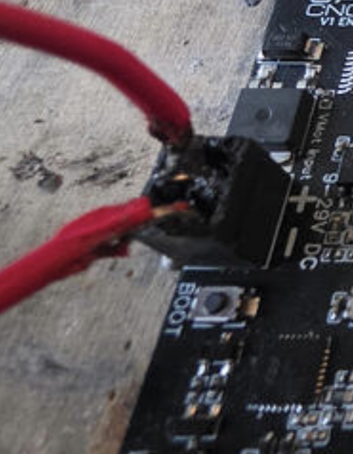

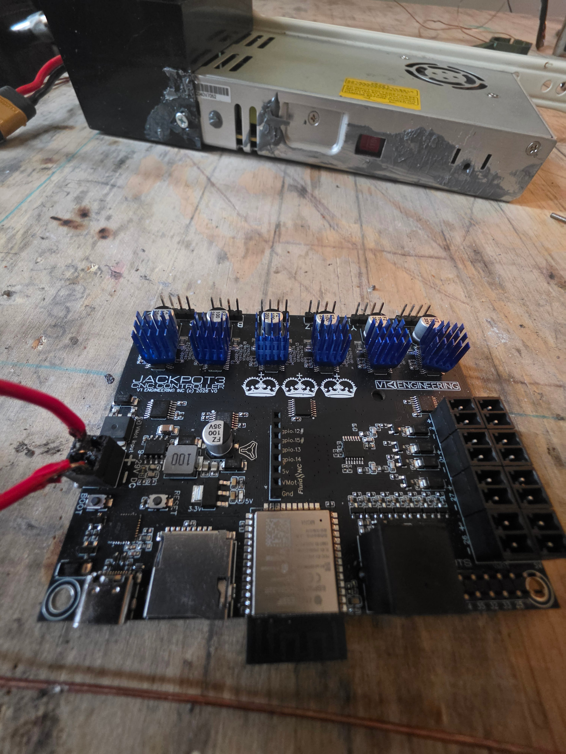

My Jackpot 3 doesn’t not connect to my computer via USB, no wifi or Bluetooth via ‘32 and it get extremely hot around the center of the board only from USB powered. How can I fix this? Is my board damaged? There are no visible issues, even examined with a digital microscope. Please advise.

I purchased it from the V1e. I can provide my order number if needed. I have many pictures of the device, is there a particular location on the board you prefer to see? I
Just a picture of it wired up.
I asked where you bought it because I test them here before I ship them.
What happens when you power from the power port only?
I have tried to power it both ways and the results are the same. No wifi or Bluetooth avaliable no connection via USB. I dont have it connected now but, I have a standard primo. I just powered it up and the board doesn’t get hot when connected to supply, only USB.
What happened to that power connector? It’s melted. Is it perhaps wired reverse polarity?
I can’t tell with two red
wires…
It looks like it’s missing the terminal block that plugs in to the connector
Oh, yup the terminal block plug in is missing. The heat sinks are on so the plugs came with it for sure.
I’m not sure what plug you’re referring to that supposedly came with the heatsinks. I only received the board wrapped in thin pink bubble wrap, along with the small bag of heatsinks.
Also, wire colors what? What polarity? Is it plugged in? :smirking_face:
