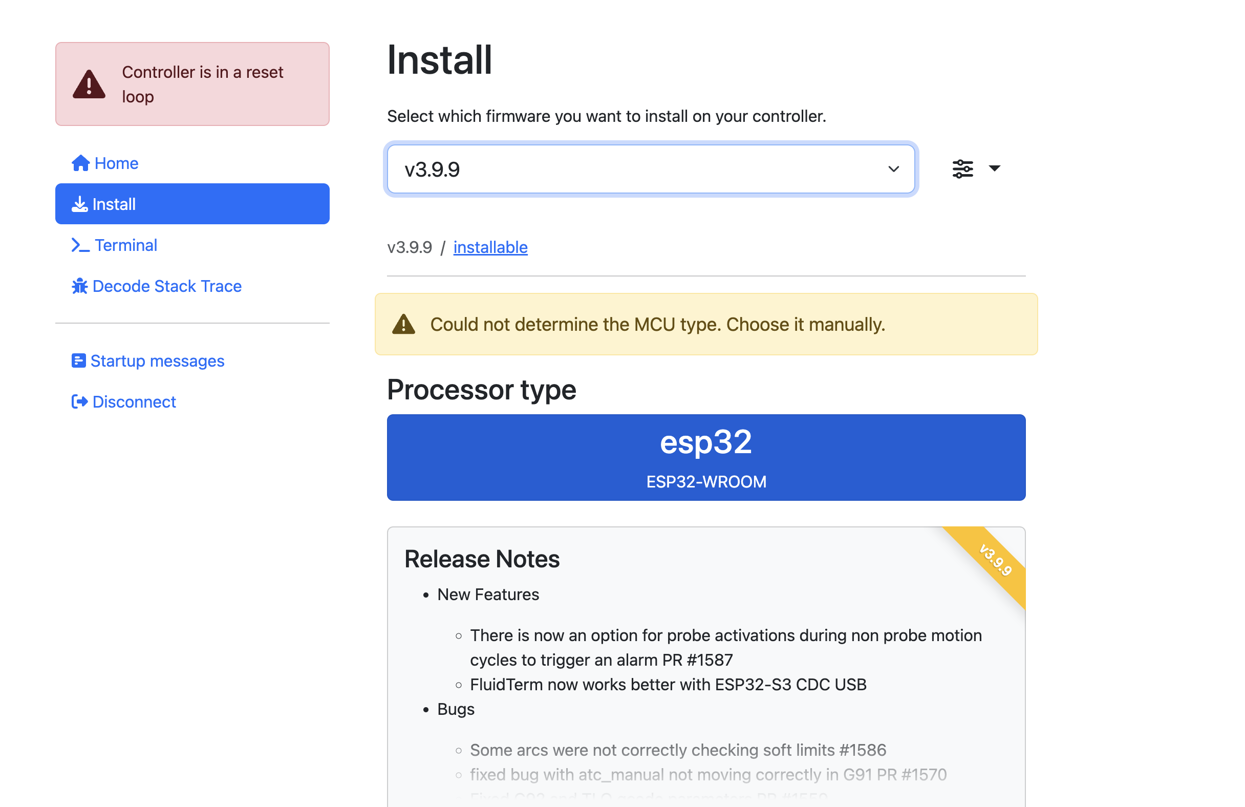

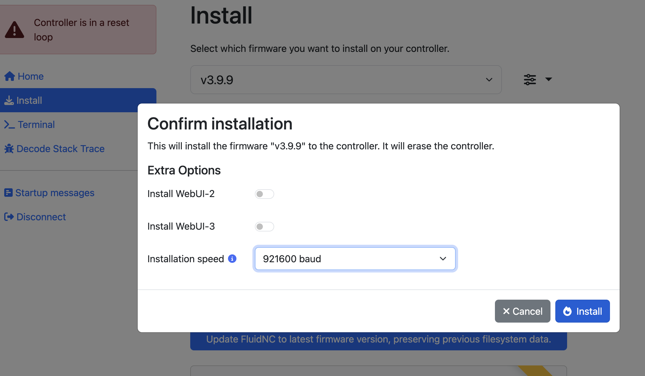

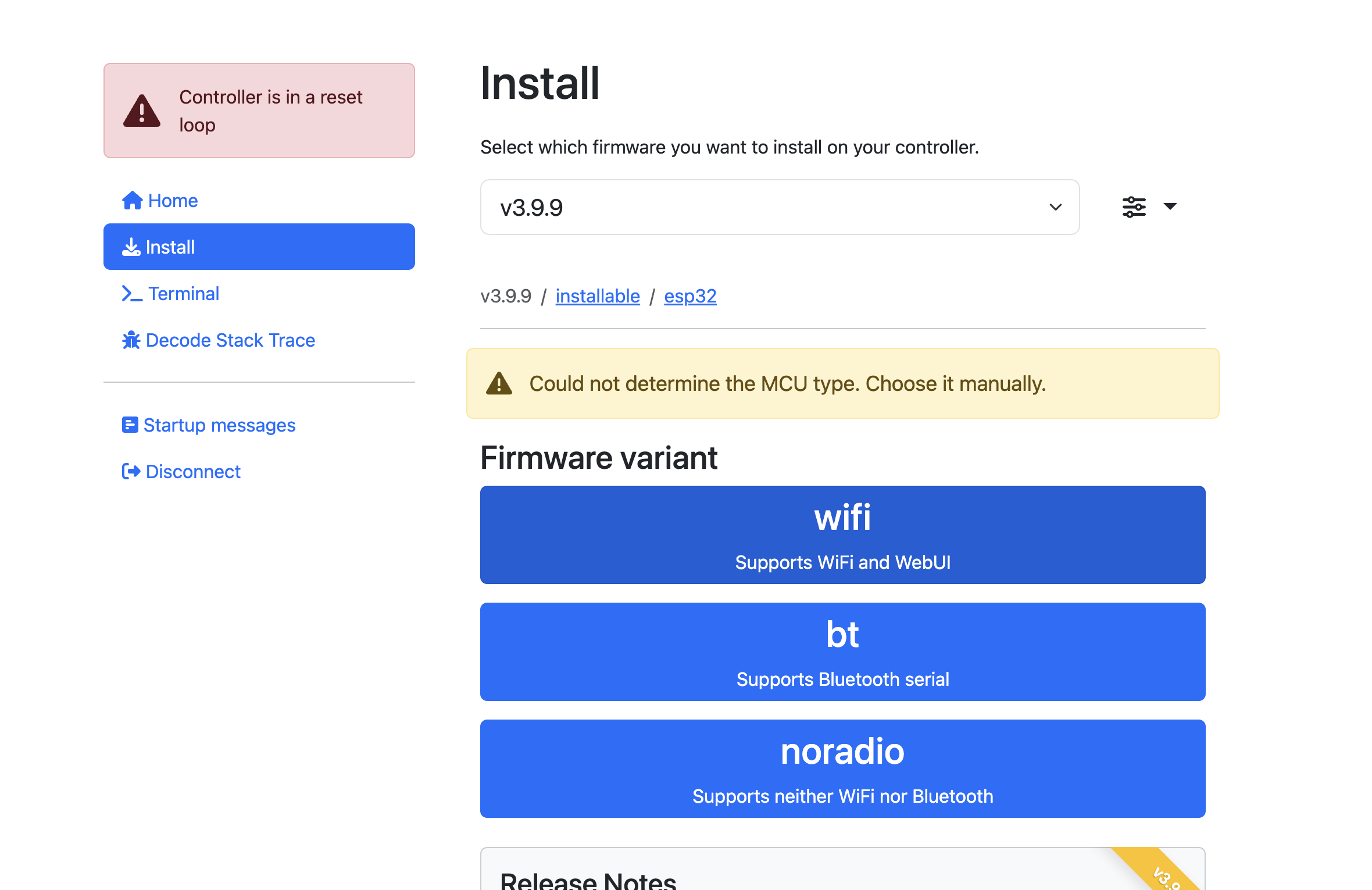

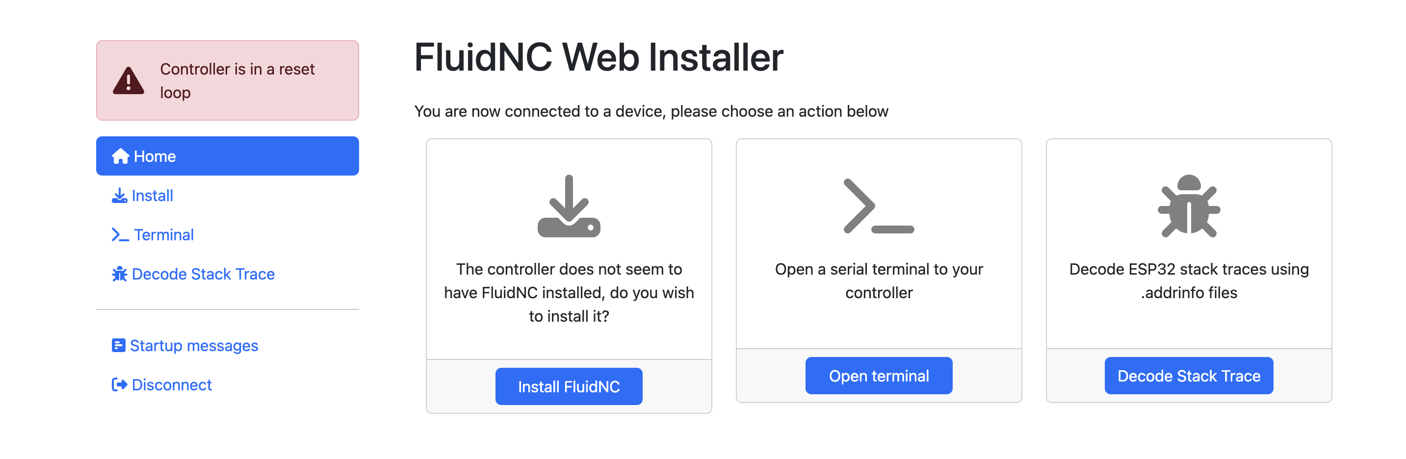

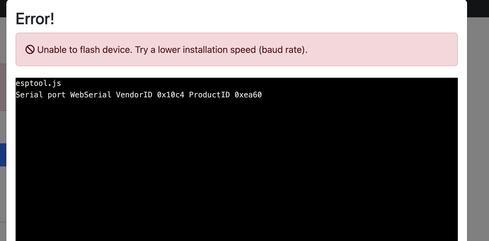

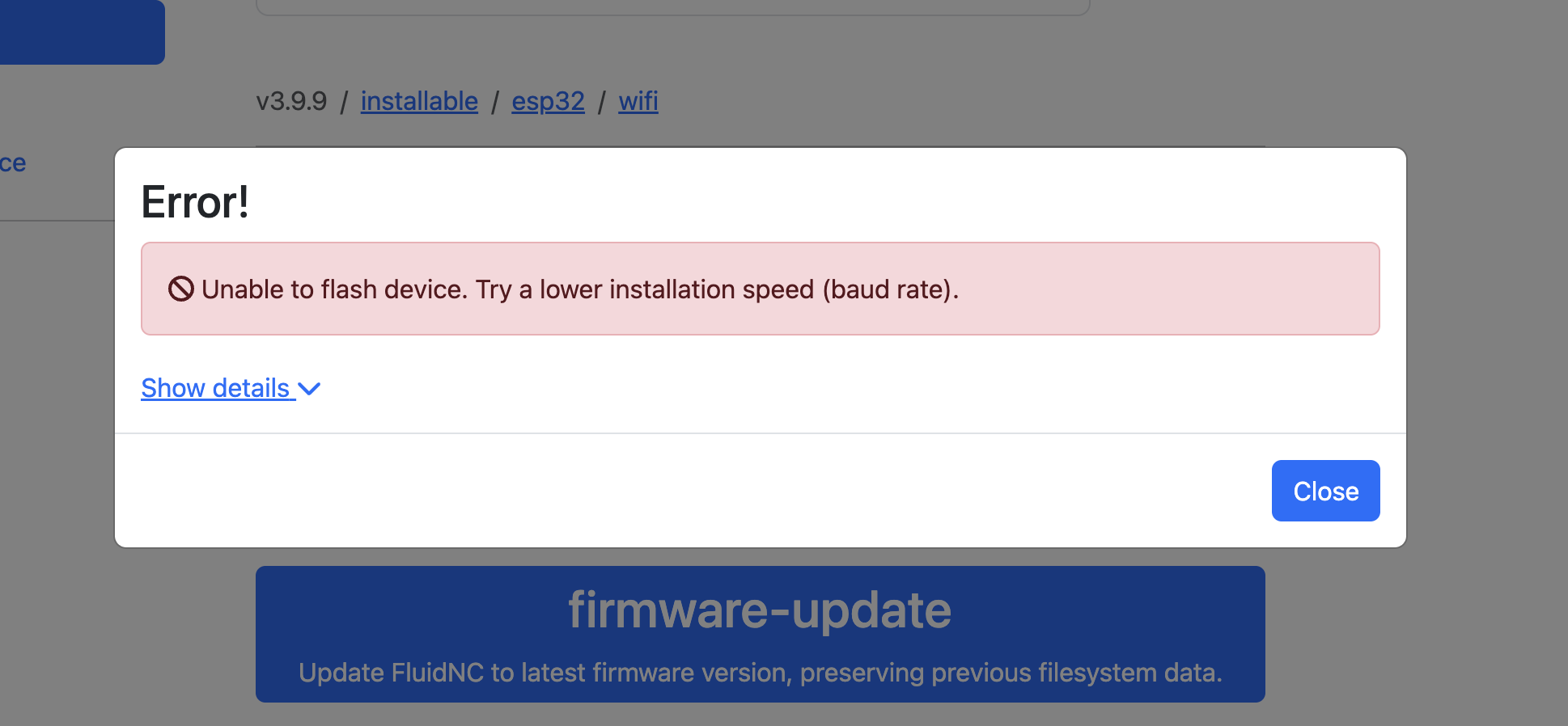

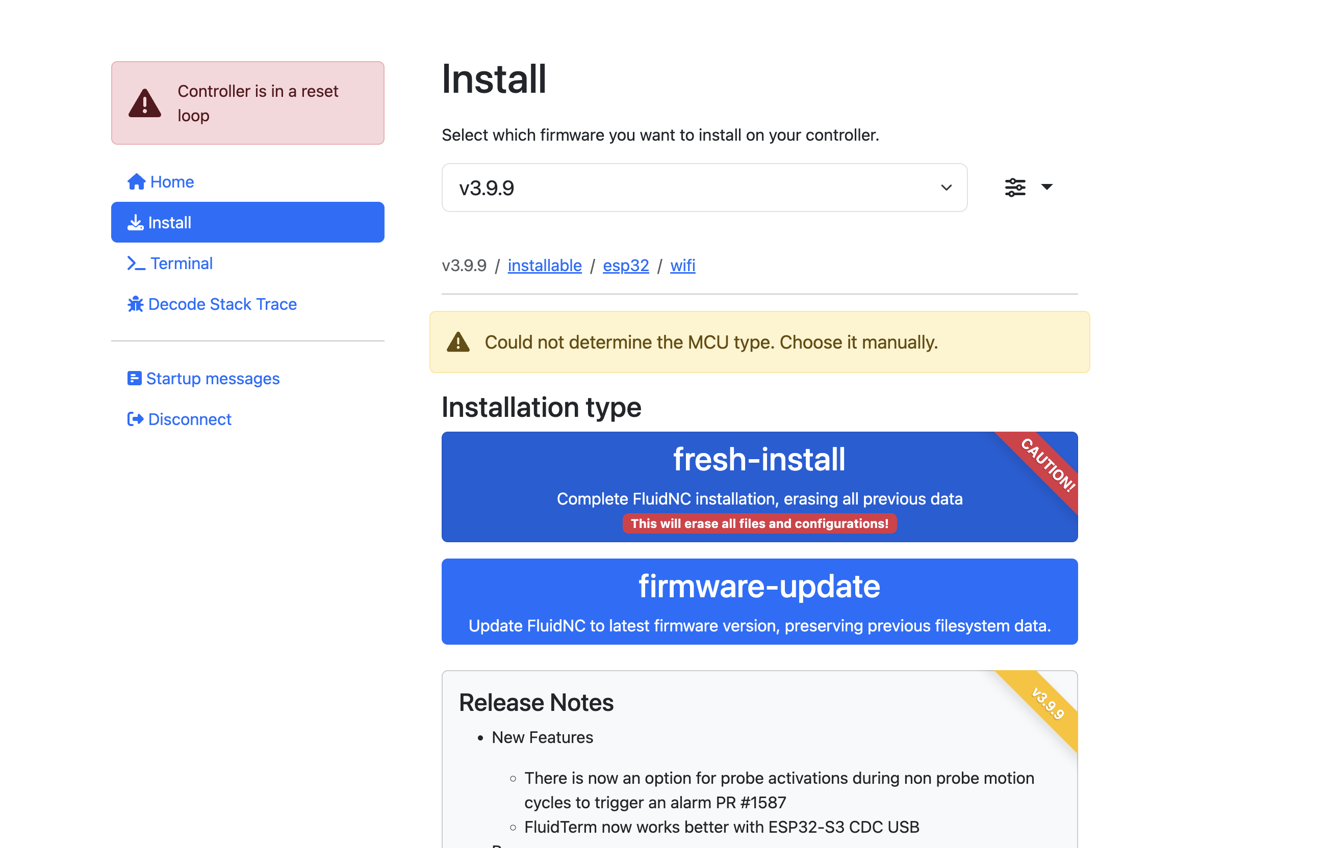

I received my J3 a few days ago and I finally plugged it in last night and was able to jog my machine and everything, but I noticed that it kept dropping the connection over and over to my Macbook Air that was sitting right beside it I did a few config changes through the web UI on the settings page (changed the max X and Y distance and turned on the soft limits) and unplugged it and went to bed, today I turned it on and the green light on the board comes on but the Wifi never shows up, I used multiple devices to ensure that it want the MB, I also tried using the USB cable and nothing when I go to the fluidnc.local. so I tried to update the firmware and the online updater says it is stuck in a reset loop. I tried putting the yaml file from the website on the SD card I purchased along with the board and the LR4 hardware kit with no change, I tried doing the erase and the install on the esp with no luck, when I plug it in I do see the usbserial, and the SLABUSB_toUART connections but nothing shows in the serial monitor. I have attempted the hold boot, press reboot, and release boot. I am not sure what else to try or do.

What browser are you using for the web-installer? Does it let you connect, a pop up comes up for a com port or something similar (I have never used a mac for this)?

I am using Chrome for the web installer. I only tried the other things once this continued to fail.I have tried all of the baud rates as well.

Use the drop down that says “show details”, don’t change the baud rate, if it says use the boot button hold it down for 3-5 seconds and usually a few extra lines come up. At that point it can take up to 4 minutes for something to happen. (if you use bitwarden it takes a bit longer).
the drivers are installed and it never tells me to do the boot part. it jsut goes to this.

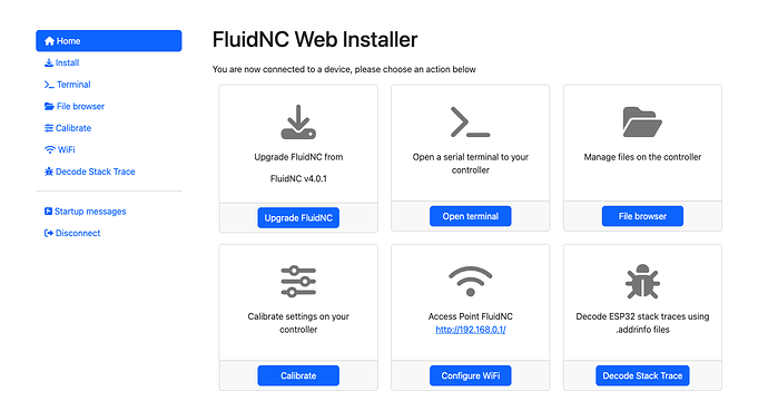

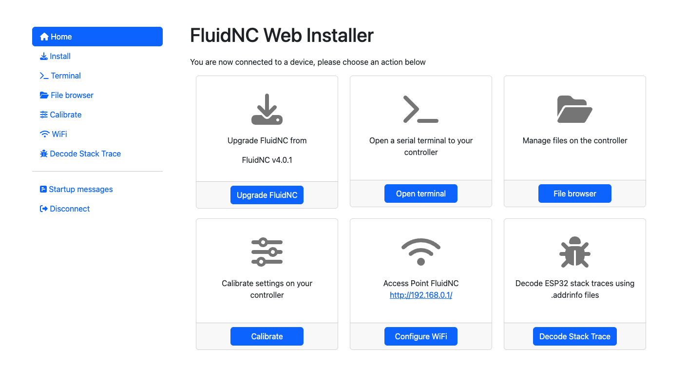

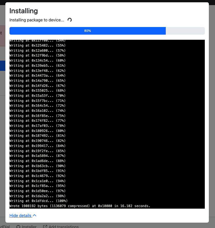

I used the same cable and the webinstaller to install to a random ESP32 I had laying around and it uploaded as you can see in this screen shot:
this shows me that it has to be an issue with the board and isn’t the websinstaller, the cable, or the drivers. So I am not sure what I should do from here.
You haven’t fully cleared it, Web Installer issues could still be present.

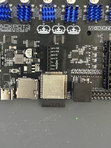

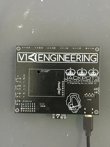

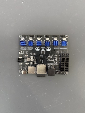

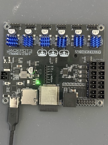

This is pretty strange. I’ve never had an ESP-32 that I couldn’t flash with some combination of the button dance except when I’ve blown up the voltage regulator. That should be nearly impossible on the system and nothing in your post history would lead me to believe that happened.
Can you post a close-up, high-res picture that shows your ESP-32 and it’s voltage regulator after you try that reset button dance?

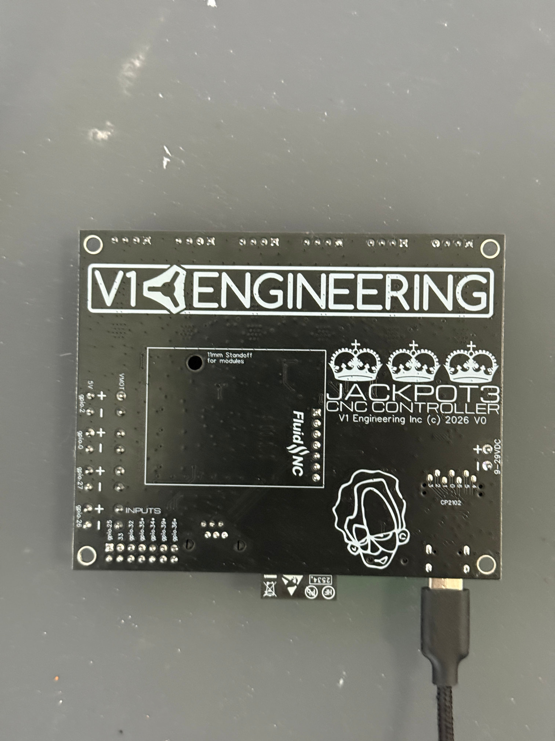

no change with the button dance, but here are the photos of the board
Thanks for responding, those are very low resolution. Do you have high resolution versions?
