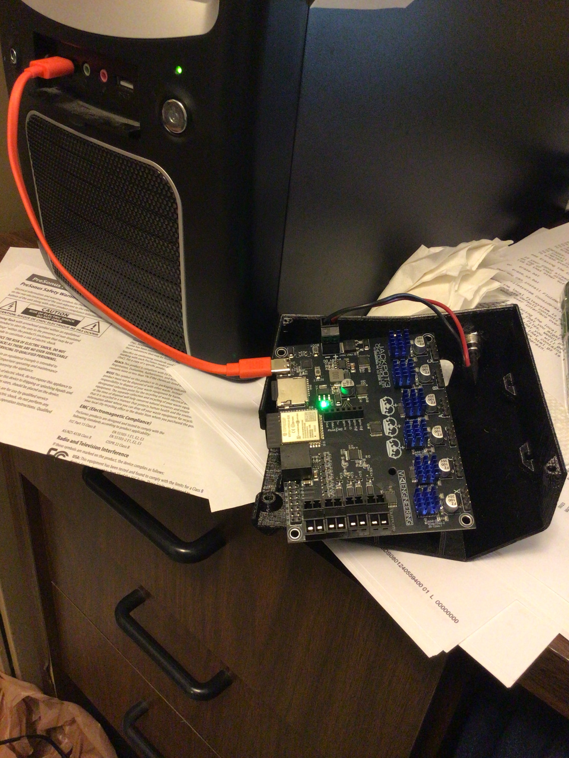

I made a stab at it, but no joy. I downloaded the yaml file for MPCNC but I don’t know how to use the terminal program to up load it. I have put it on the card and it shows up on the board. I have the board on my desk plugged into the usb. The light is on, the power supply is disconnected and I am stumped. I can build a computer but can’t program one. I’m a hardware guy I suppose.

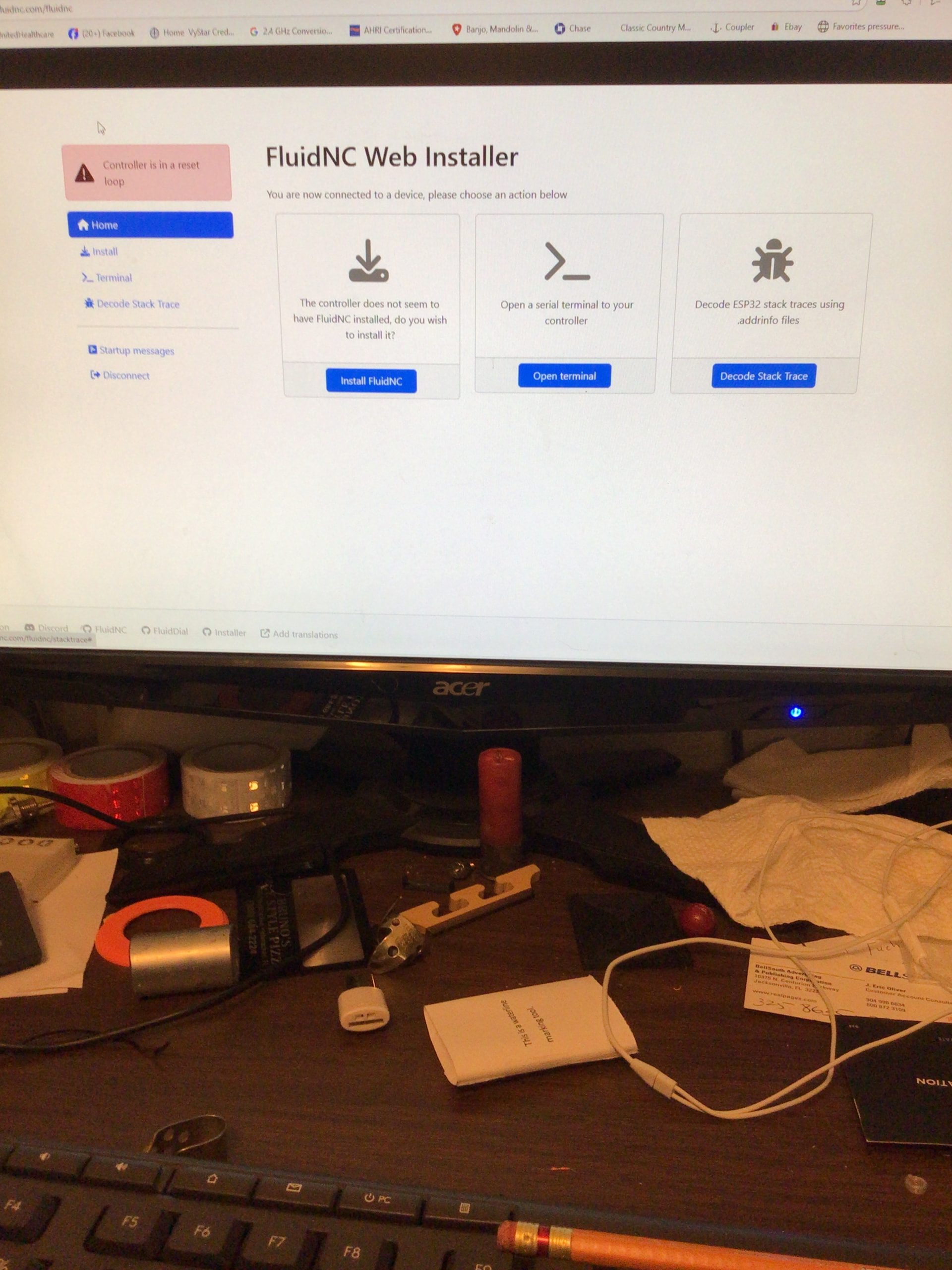

I deleted everything and disconnected the board. Now all I get is a blank page, ESPD3 tool page. Github refuses connection . How is reboot accomplished? I see the boot button on the board. My density knows no bounds here. I appreciate your help. I confirmed I have uploaded the correct version but I can’t get it installed and now I can’t get the controller to connect properly.
No worries it can always be brought back.

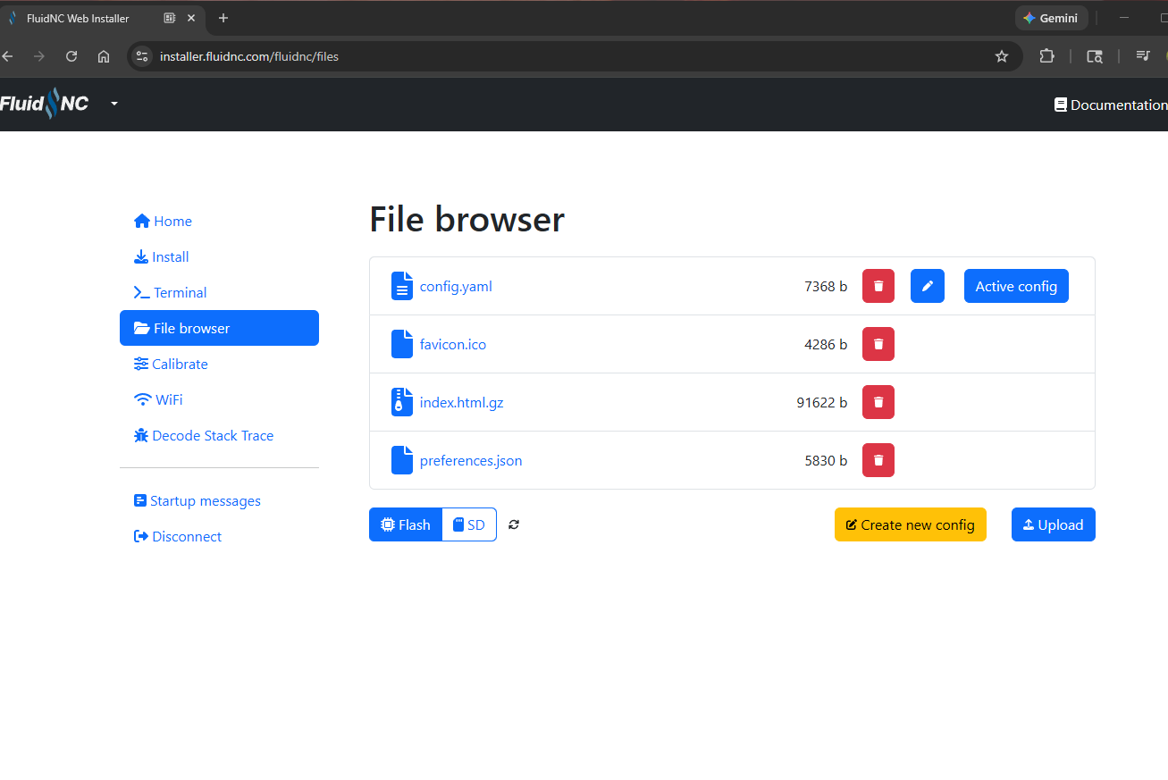

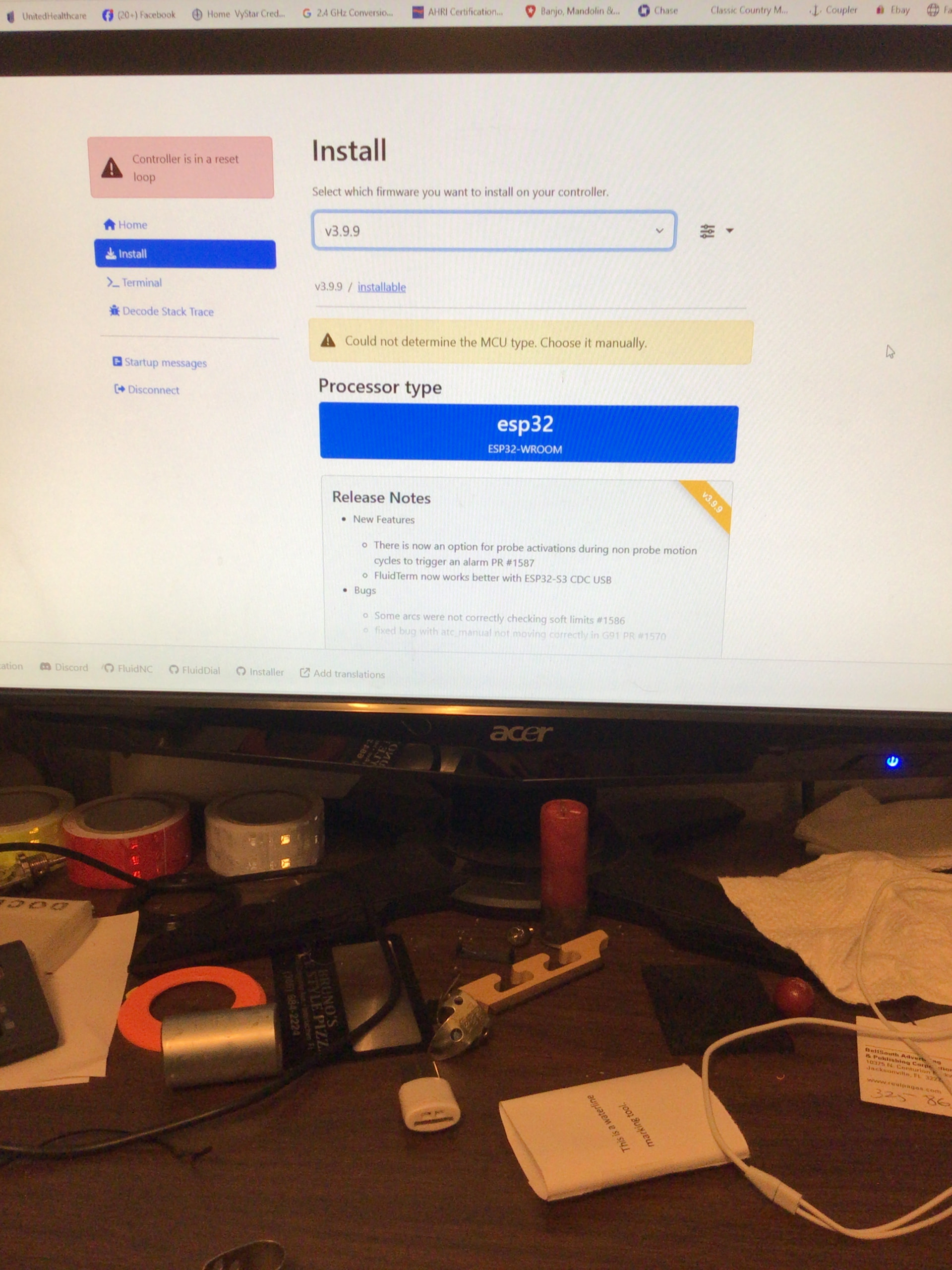

If you deleted everything then nothing happening is to be expected. You will have to connect via USB and use the webinstaller to do a fresh install of 3.9.9, and upload all the files in the mpcnc folder.
It should look like this after flashing and uploading.

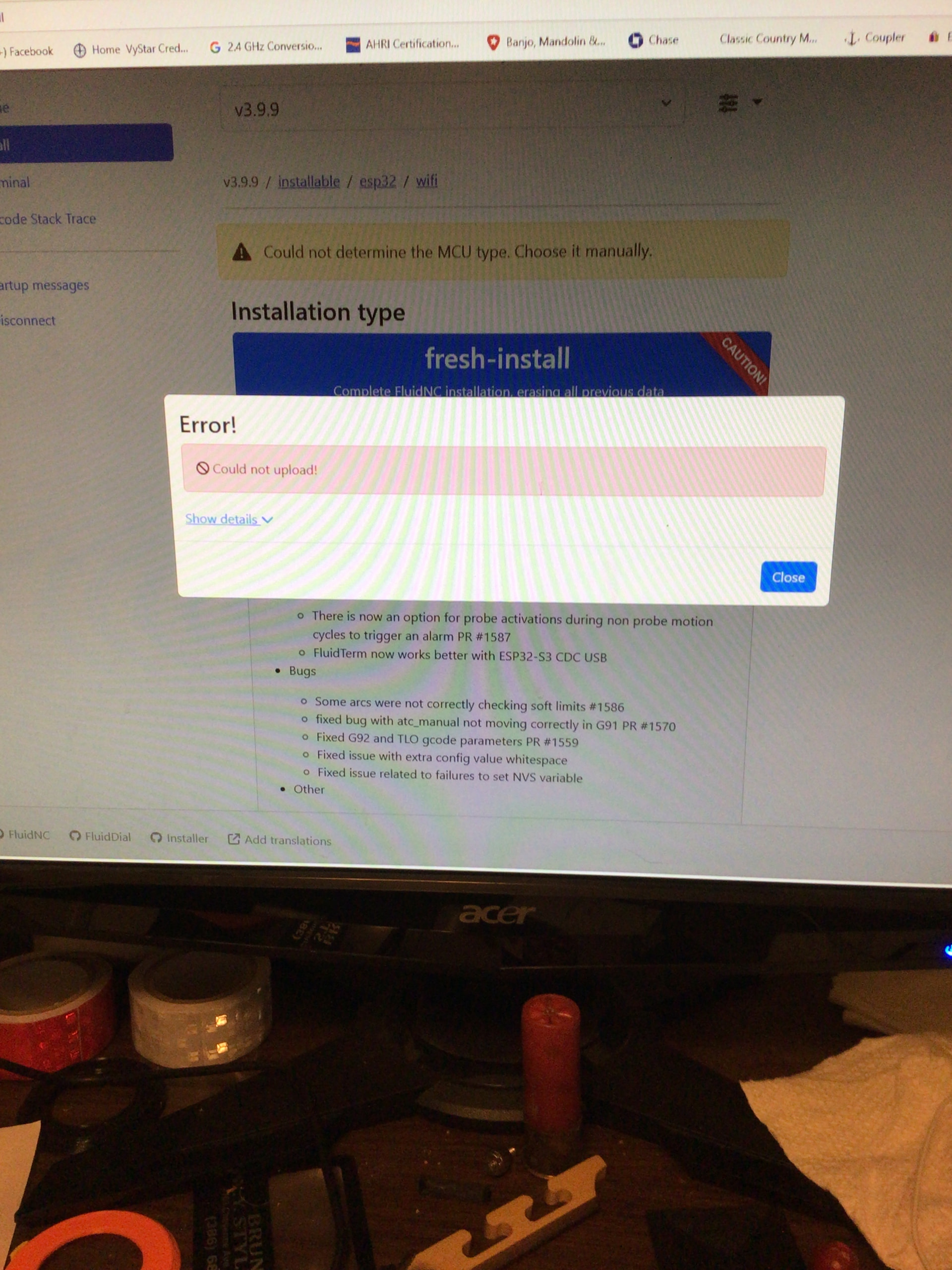

This is where I am

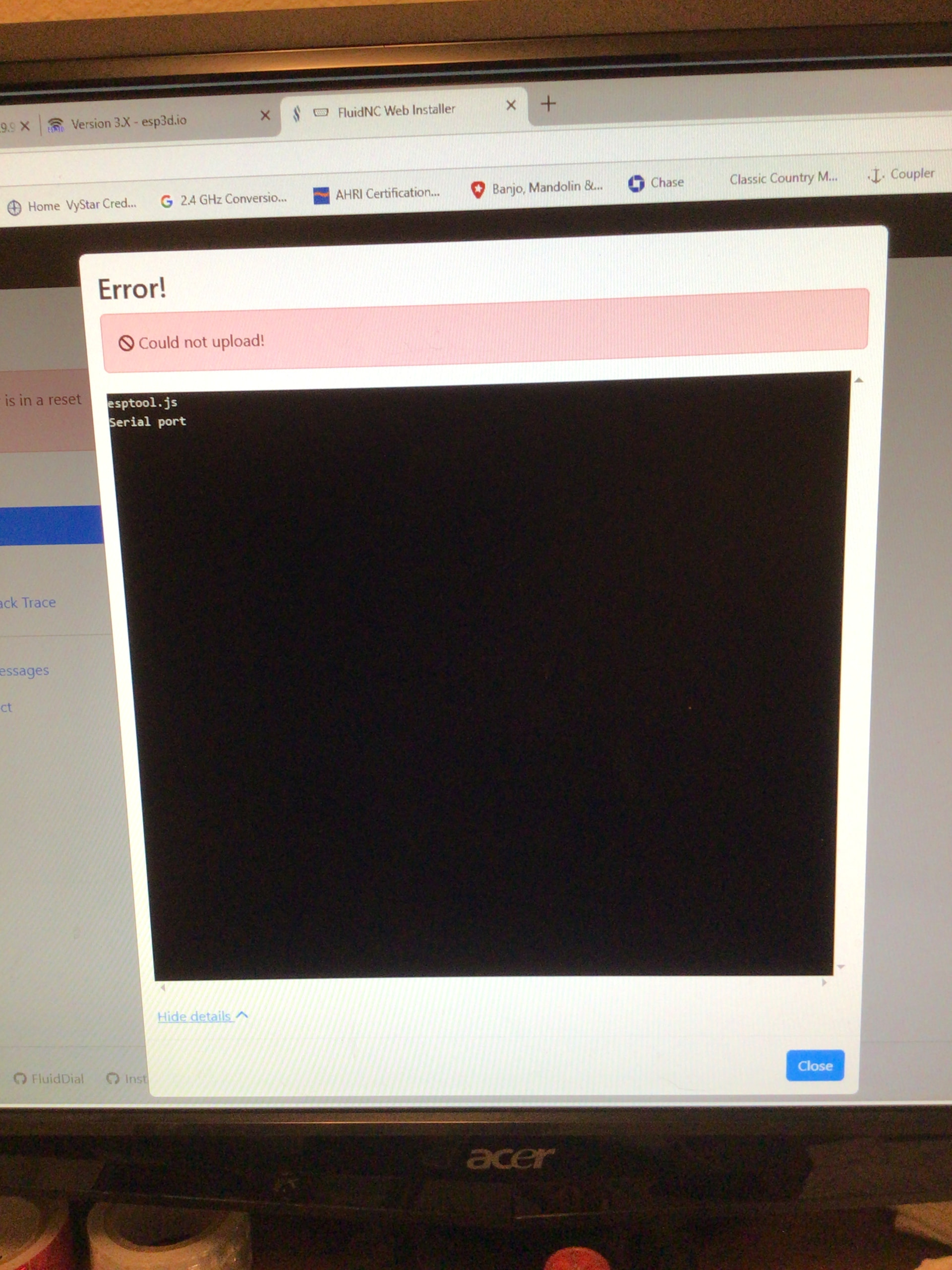

It says use a lower baud rate , but it’s on the
lowest available.
install fluidnc, use the dropdown to “show details”.
You might need to hold the “boot” button for 3-5 seconds.
Still complaining about baud rate. I’m going to find another usb cable. This may not be a data cable.
Yeah, that is crazy common.

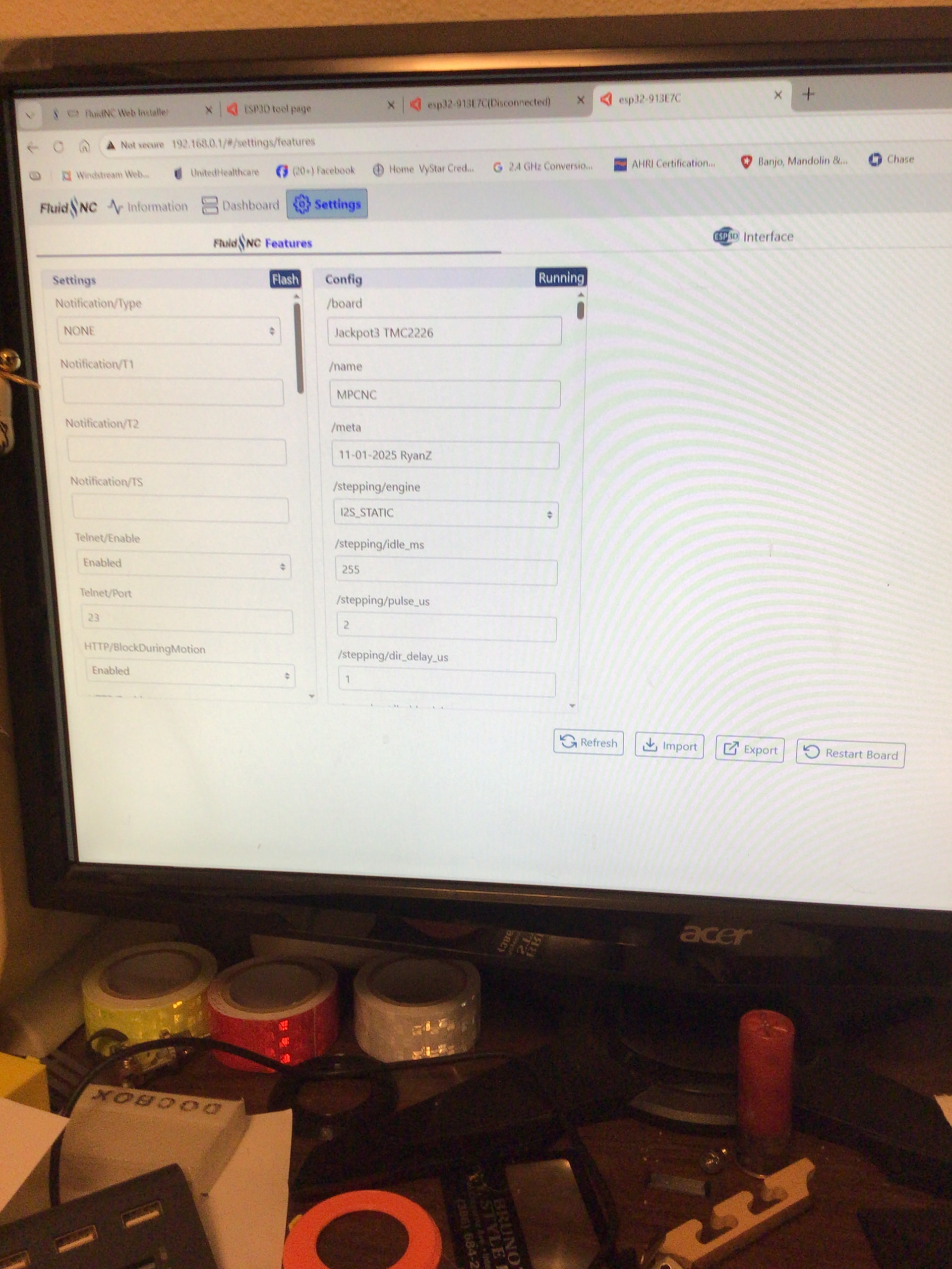

Maybe success. It now says MPCNC and I reinstalled index.html. I’m going to give it a try now that the controller has returned.
Yup looks pretty good. You should have all these files on your flash,
