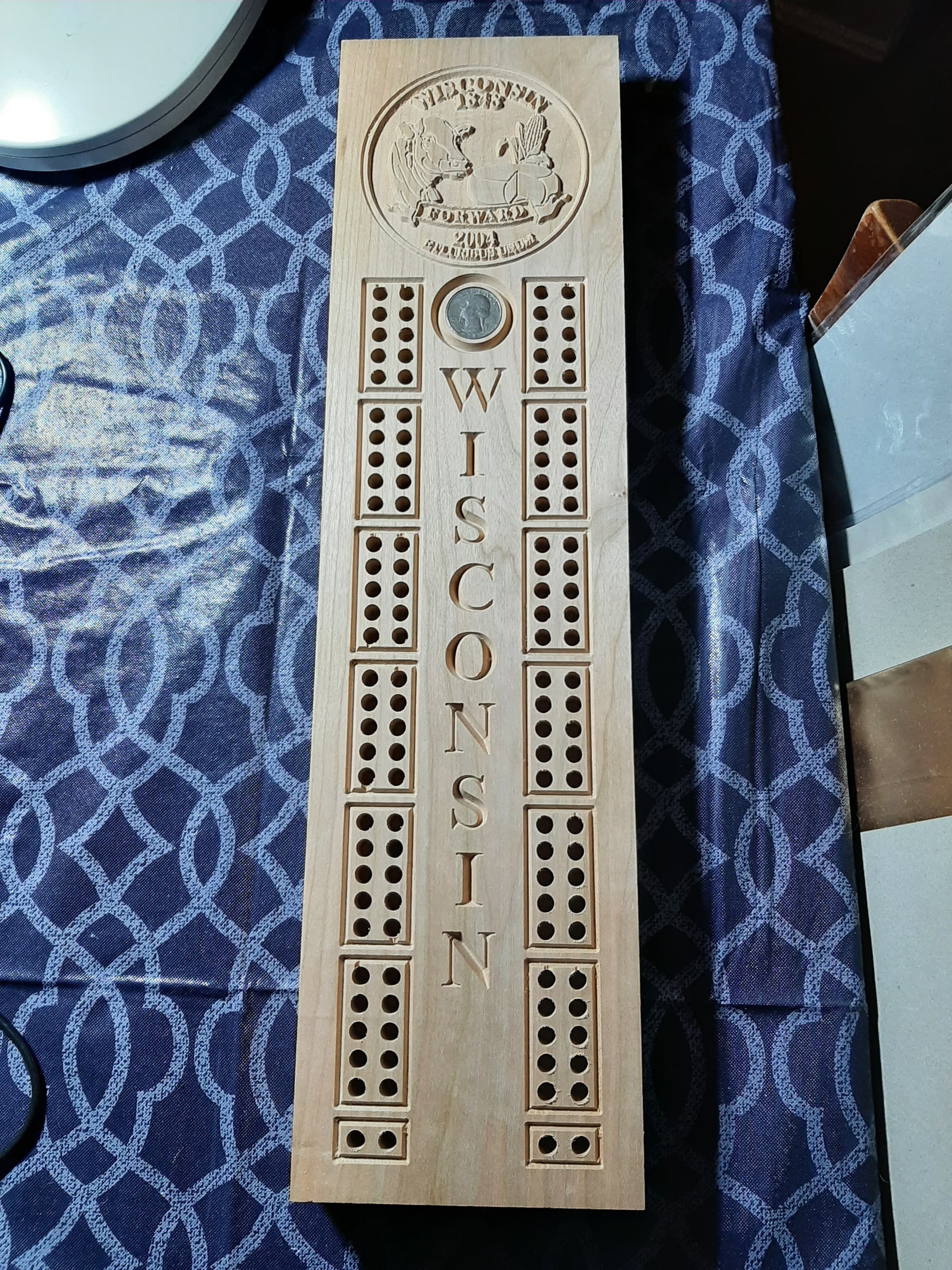

hts_1
All 1/4 inch holes except the custom 410 size board i cant find pictures of atm :tired_face:

Those boards look nice. 1/4" is too big for the holes I need, though. I working with 1/8" pegs.
