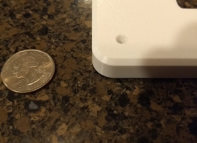

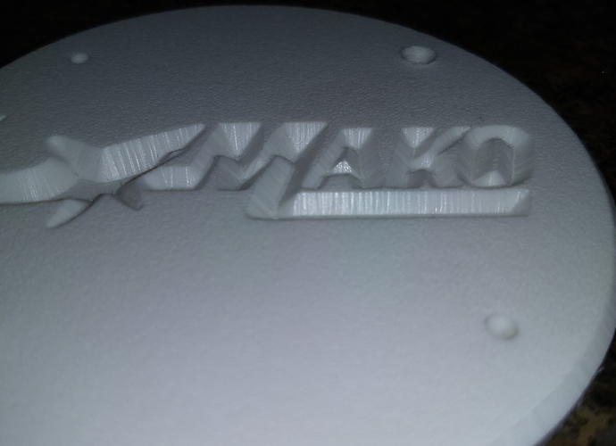

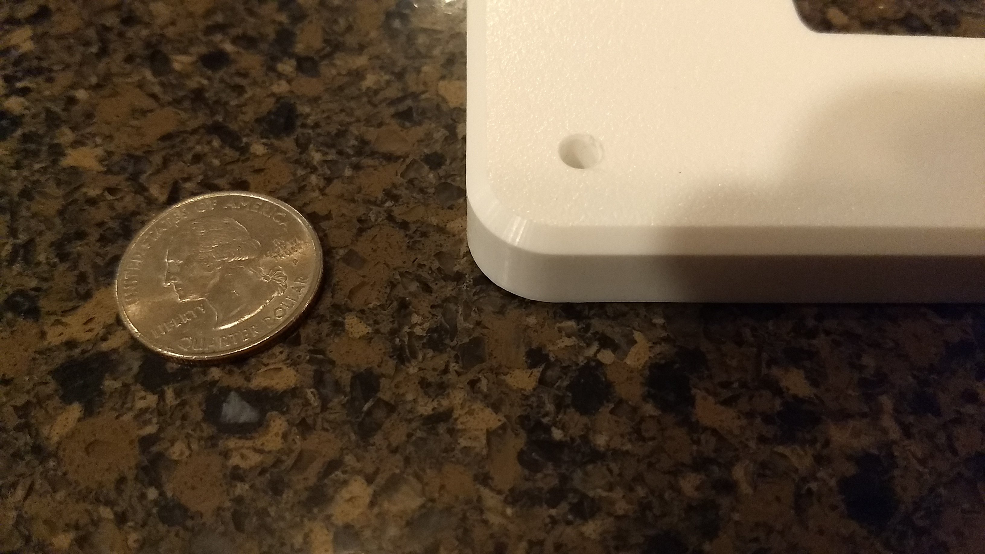

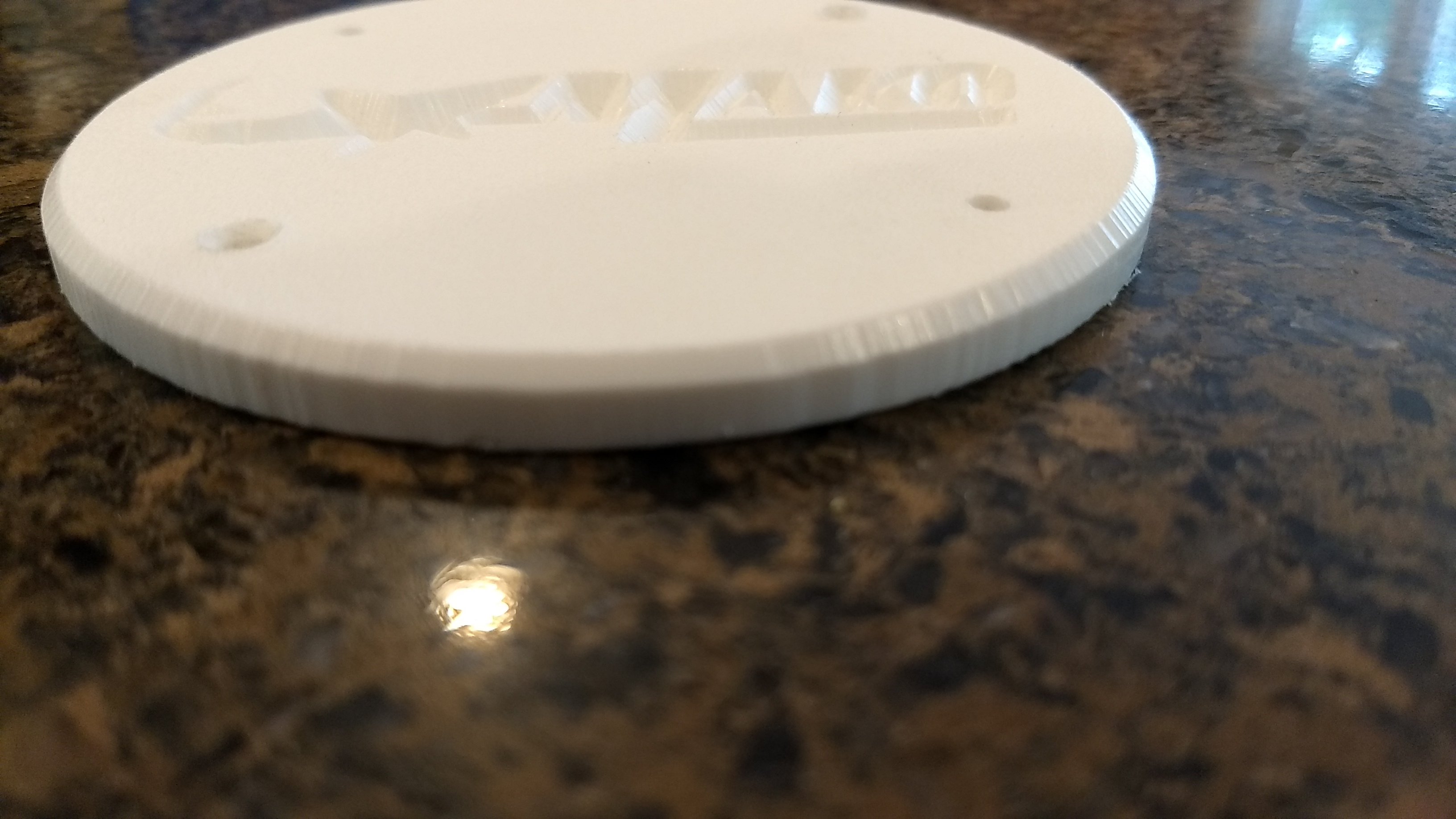

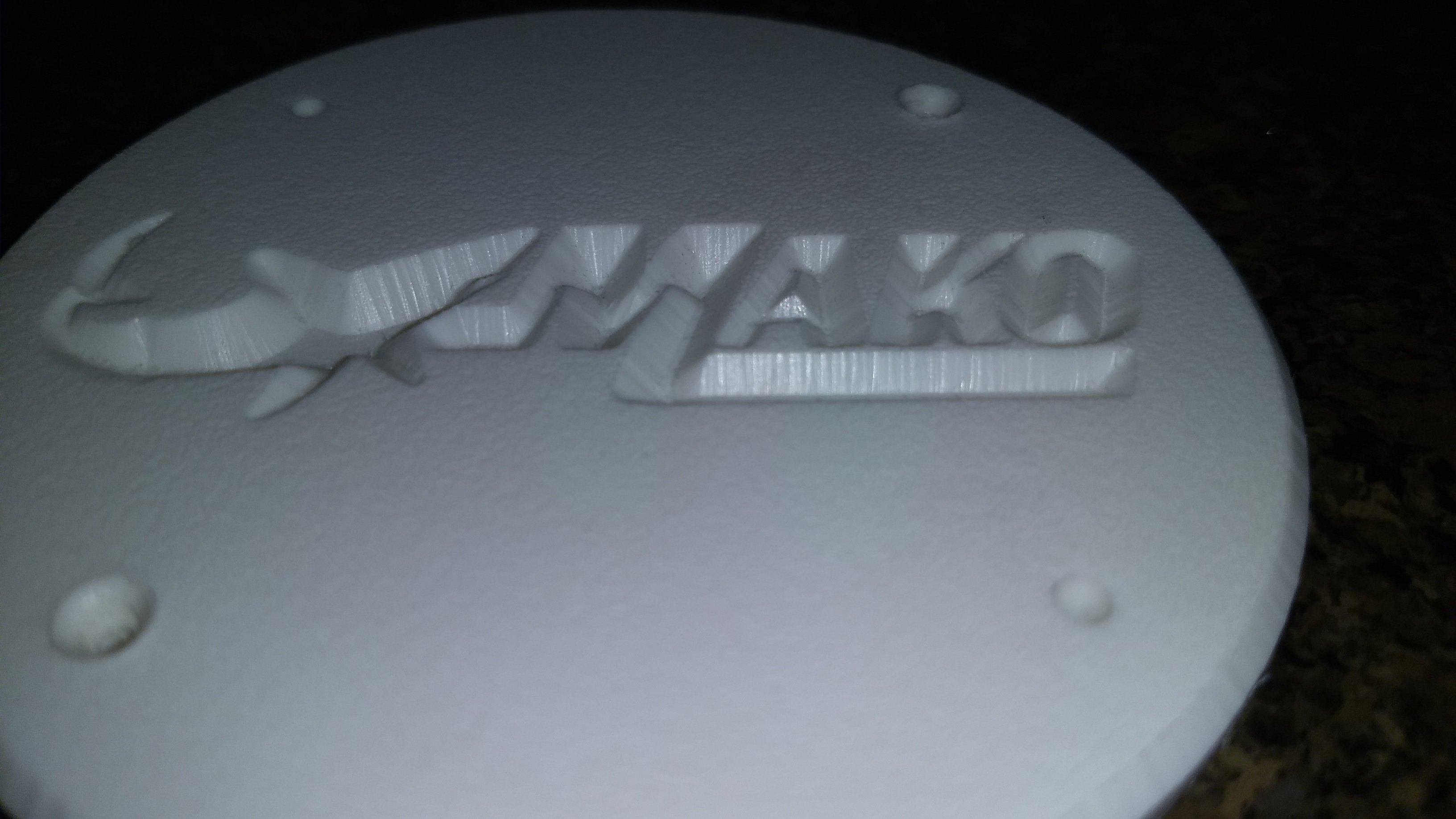

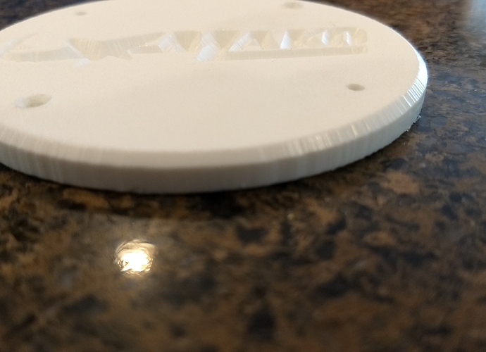

Hi guys, I’ve been cutting a lot of HDPE lately and am having some rough movement of my gantry translate into my cuts and engravings. On wood it is not too bad and can be sanded out, but in the plastic it is very noticeable. I saw a thread here a while ago about this but it didn’t seem to end up resolved. I’ve attached 2 pictures of a part I cut out last night where you can see the rough cuts. It is not from the bits as you can still see the rough movement in the gantry when running gcode in mid air. Straight x or straight y moves are very clean, it is only when moving diagonally or circular that the issue shows up. The circle that is attached has acceptably smooth edges near the x and y planes but is rough elsewhere. Carves are also rough
I purchased all my parts here, 2’x3’ cutting area, stainless rails, dual endstops, all bearings are bolted just until the nuts touch, I have cleaned the bearings and rails.
Should I be changing the resolution of the steppers?
My gantry isn’t perfectly square but the dual end stops square it up perfectly (off by about 1/2" on one endstop)
am I missing something?
Thanks in advance!

That part had a finishing pass. The finishing pass looks no better than the roughing pass.

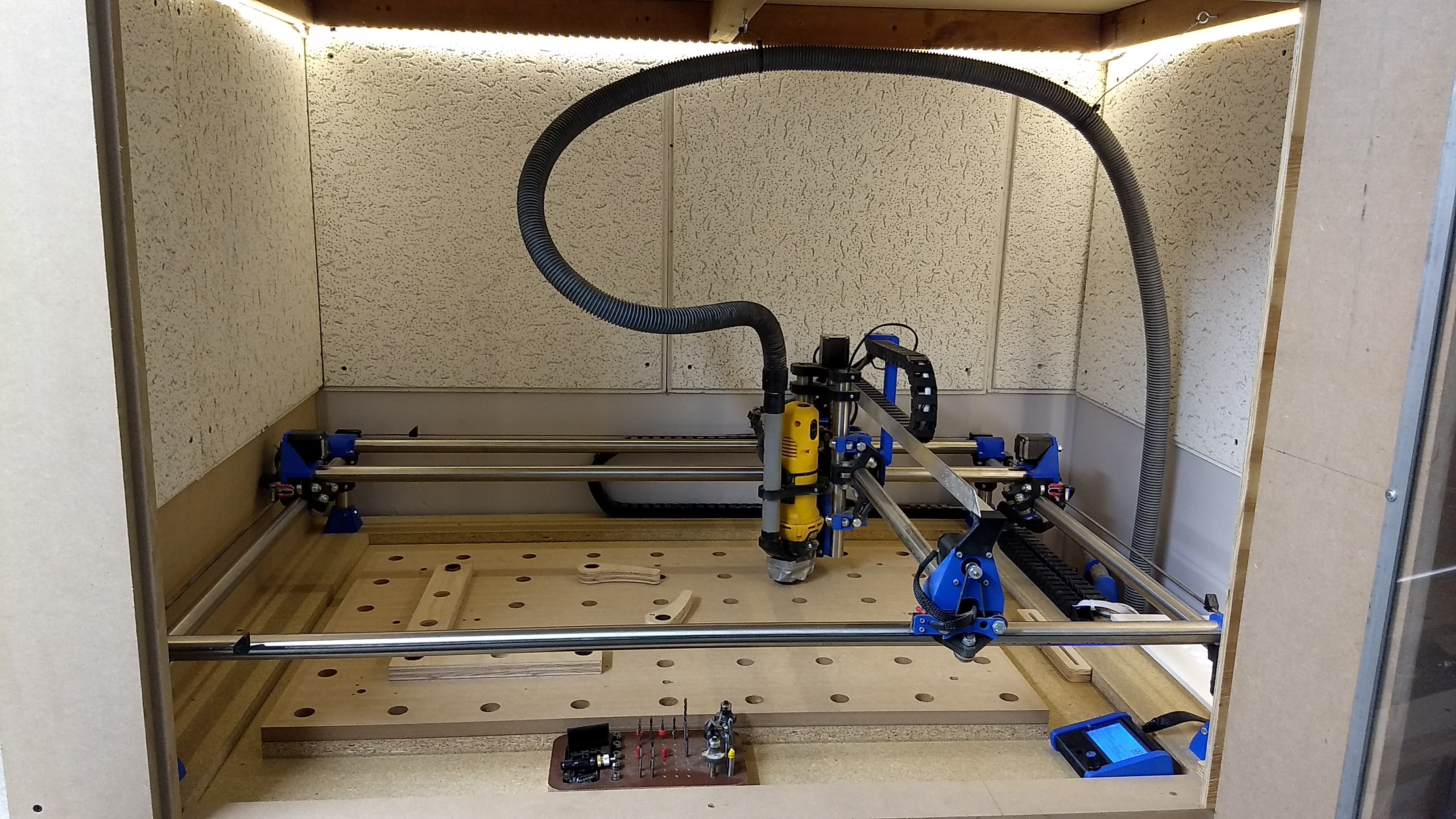

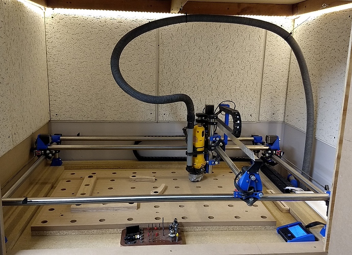

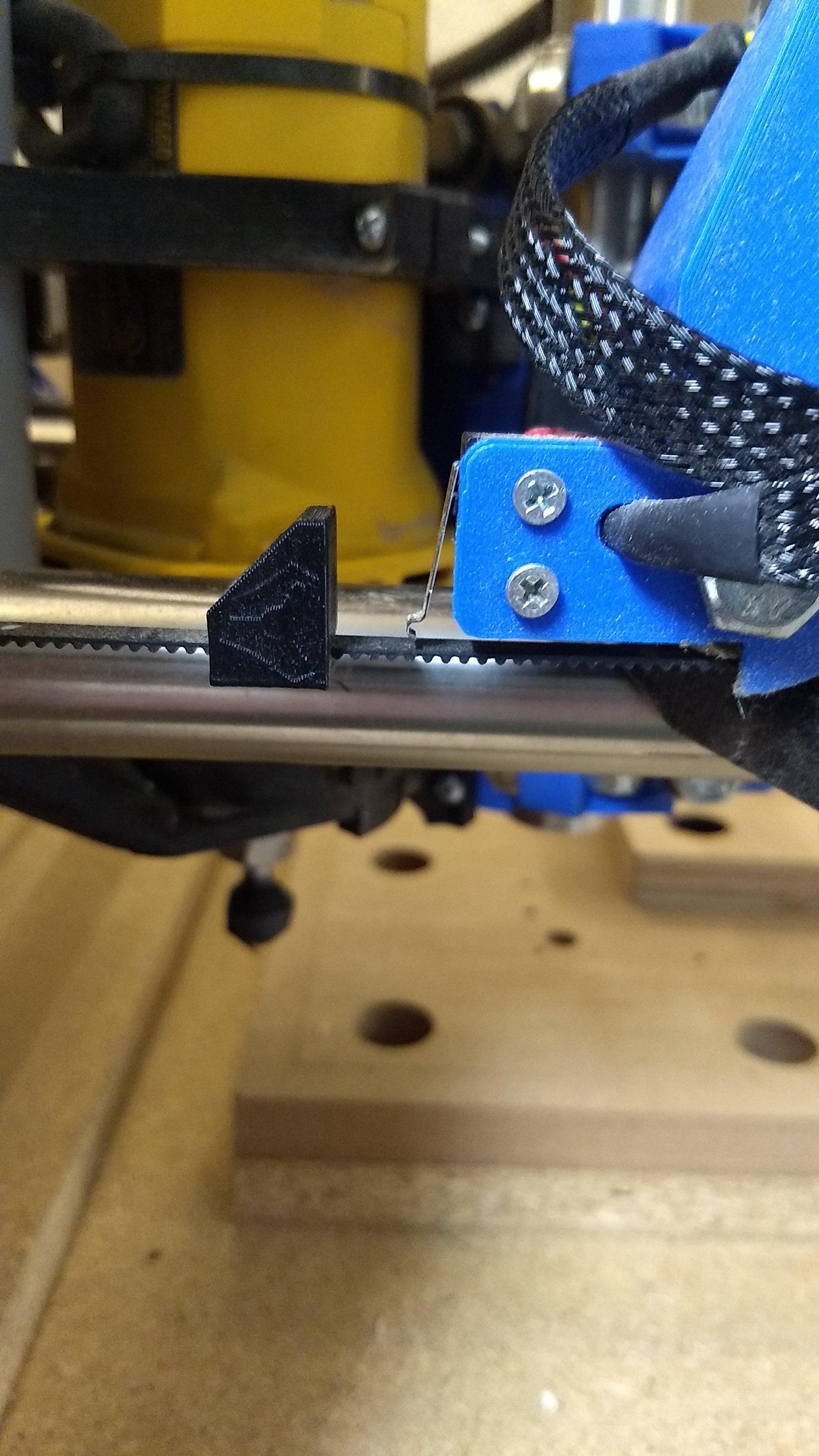

Here are a couple pictures of the build. I did happen to run some sandpaper down the rails on the contact strips for the bearings and found that the gantry now runs smoother than it did. I am hopeful that the cleaned up rails and squared up gantry may fix this issue
Don’t just reprint first, try to actually square up everything like the feet and corners, and check for straightness/bowing of the pipe.
I spent hours squaring up everything when i built the machine. The frame is square withing 1/32" diagonally. The tubing is very straight and I have spun it to be sure. I never could get the center assembly to square up though. When I square it by hand and move the gantry it is much harder to move the gantry around.
Side note: I have run a piece of sandpaper down the rails and it is noticeably better. There were small bits of debris sticking to the tubing from being run over by the bearings. You can still see the gantry shaking as it moves, but it is much better. I have not had the chance to cut anything since

I figured I would give this thread some closure in case anyone else runs into this issue.
Reprinted the center assembly parts and it did not make much of a difference.
I spent a little more time running a fine sanding sponge down all of the rails. I ran a razor blade along the faces of all of the bearings while moving the gantry around. I then used an abrasive pad on the rails and bearings to polish them. It took all of about 15 minutes.
Boy what a difference!
I am now very careful about cleaning the rails whenever I cut wood. Even though I use dust collection, the fine dust eventually just gets smashed into the rails and bearings and starts making the gantry run rough. I’ve actually been seeing the movement get better and better as I cut more HDPE because it does not turn into dust and I believe the bearings I could not reach (inside xy parts) are slowly cleaning themselves.

Side questions…are those ceiling panels used as walls on your table? If so, how effective do you find them at keeping the noise down?
