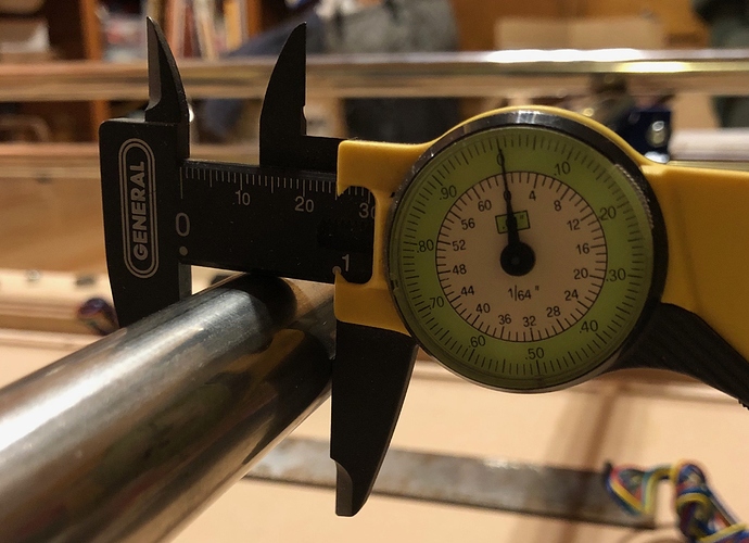

I am building a MPCNC with 1" SS tubing with V1 supplied printed parts.
The gantry angle needed some tweaking, but it now okay until I insert the Z-axis tubes. Each tube opens up the angle by a couple degrees so the combination opens it up by a completely unacceptable amount.
I’m unsure of what to do about this. I put the tubing in calipers and it is right at an inch, so I don’t have a case of mis-sized pipes spreading it.
Help appreciated.

It should be able to be adjusted to very close to 90 degrees. There are a few adjustments as laid out in the instructions. It is supposed to spread a bit, that part should not worry you. If you can’t get it run it as is for a bit to break it in and rebuild the center. This is not all that common of an issue these days the 525 easy to adjust, the Burly is easier.
Make sure you have 25.4mm OD not the other one sometimes sold as 1" that is actually bigger. Make sure your Z axis is assembled correctly. I am sorry there is no simple instructions I can give to fix it. Pictures might help to see if you did something wrong but in general it should work.
