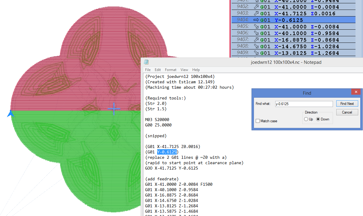

I have a 3d milling project that takes 4 hours to do with a 0.5mm endmill.
Isn’t there a way I can break the gcode up into smaller parts, e.g. insert a stop approx. every 30 min? So if the endmill breaks, 2 hours in. I can start from the nearest stop point, instead of having to mill the first 2 hours again without it touching the wood.
Just break the code manually, thats how i do it.

you can open the cnc program with any text editor and add “M00” at intervals you like.
But if you’re using Estlcam to control the machine this is not necessary - you can restart at any line in the code. You can even click to the point your tool broke in the preview window with the right mouse button while holding shift key pressed and it will jump to the corresponding program line.

I’ve tried to split the gcode into several chunks, I remembered to copy both the start and end code into each. And I’ve split the code when the z axis goes up to travel height.
BUT As soon as I try to upload the new codes the programs lock up and I can’t use them. Is notepad not ok to use? Or should it be notepad ++?
Notepad++ is designed for editing text. Windows Notepad includes “hidden” formatting supporting RTF which can cause problems.
Wordpad does this, Notepad does not. But, yes, Notepad++ is awesome sauce and includes visual features to help maintain spacing, etc.
