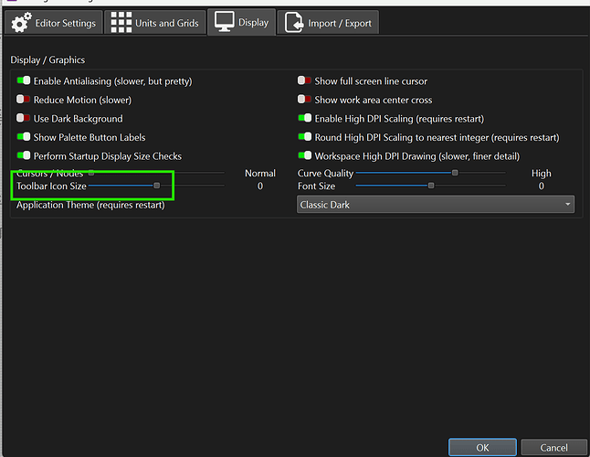

And I still don’t understand why they can’t fix the DPI issue. This is the same issue that has plagued LightBurn (and Carveco has the issue too). I always have to do the work around. If you aren’t familiar, people with high dpi machines get super small icons on the top and side. They are unusable at that size. You have to go into the shortcut and change the dpi settings. No other programs are like that. This isn’t a machine problem because it has happened on several laptops I have had from different manufacturers. Rant over.

You can adjust the size of the icons in lightburn and millmage…
Under Settings - Display - Toolbar Icon Size
You can also change the theme to dark here as well.
That is new. That must have been their “fix”. Granted when I first discovered this issue 4 or 5 years ago, that wasn’t an option (neither was dark mode). But normal size should still display normal size because to get “normal” size on a high DPI machine, you have to set it to the highest setting. So, they just band aided a fix. But that is good to know that they have addressed the issue finally. Thank you for that information.
Yeah I don’t like the “use dark background”. That changed the work space dark but leaves all the icons and stuff light. I prefer the opposite of that with everything else dark but the work space light lol.
After playing around with those settings, that actually have “enable high DPI mode” listed right there. Once enabled, it fixed it like my old hack. :grinning_face:
I was wondering - when you said “why can’t they fix the DPI issue” I started 2nd guessing myself. One of our devs spent an absolutely ludicrous amount of time chasing all that down.
It’s funny how I’ve just assumed it was never fixed because every time I would install it on a new PC over the years, it was still “broke”. And I would just go in and apply the “fix”. But I never once noticed it was fixed in the settings. It is too bad that it can’t be automatically applied like other software.
It actually does apply the correct default if that setting doesn’t exist, but it initially didn’t work that way. We learn as we go. :slight_smile:
