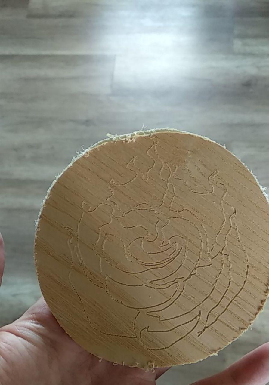

The kicker is: it came home perfectly to X0Y0, I changed the bit to an engraving vbit, and cut the drawing, and it did it perfectly, and again came back to zero. Just to clear up that it wasn’t the spindle wire causing an interference on something.

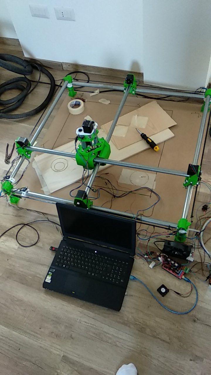

The machine has a 60x60cm usable area, 7cm Z axis, everything was self sourced.
Make sure the set screws on the steppers are tight.

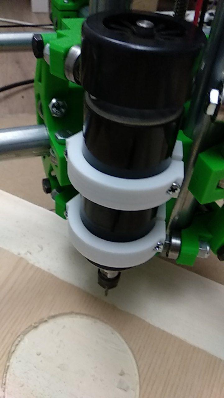

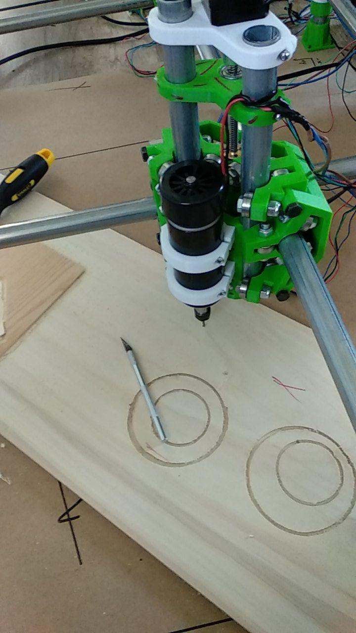

Picture of your machine,
What endmill are you using, how many flutes up cut or, real or a drywall bit,

Here it is.
[attachment file=69401]
[attachment file=69405]
2 flutes, upcut, real endmill. I’m using cheap chinese bits, so no names. They do cut fine when I use them in dremel though.
It does pretty well, I don’t have any photos though, since I haven’t mounted a pen in a while and it takes quite a bit to remove the spindle. The engraving on the second piece is meant to show it though
I did test the crown when I built it and it was fine, but I didn’t bother taking a picture, and it was a lot of time ago, so I don’t have it.
500W, 52 mm spindle, ER11 collet, air cooled. Mounted with two brackets.

Too hot, PLA gets soft you are going to melt your motor mounts.
Those cuts do not looks even close to good, something is very wrong but you are saying all the right things.
Your Z coupler should be touching the bearing.
Your corner tops are on backwards but that won’t effect anything.
I would put my money on that spindle being cruddy (much less than 500W) somehow or your tension bolts are all too tight.

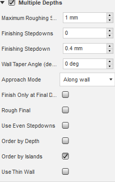

Tried that cut, using a contour.
[attachment file=69415]
[attachment file=69416]
[attachment file=“2018-09-16 19_29_17-Fusion360.png”]
And yeah, terrible again.
Again, it came back to 0 perfectly, but each pass did it with it’s own approximation of a circle.

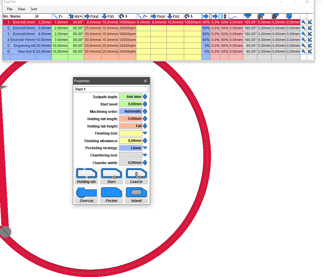

Please use estlcam to troubleshoot. There is no way for me to solve fusion issues. There are more than 5 tabs of settings. Plus your endmill settings.
From the screen shots you showed you are changing the wrong settings. Please, estlcam is many many times easier. I can’t help with fusion at all.
[attachment file=69443]
[attachment file=69444]

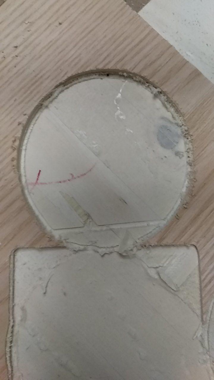

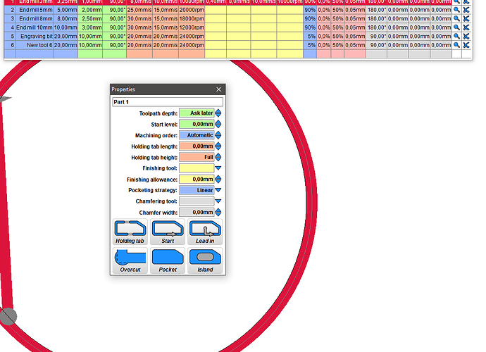

Ok, new photos. This were made with Estlcam, using a lead in (the reason because the piece has a part cutout).
As you can see, it does well in straight lanes, but it is terrible with the circle
[attachment file=69445]
This are the estlcam settings I used.
Diameter of 3.25?
Plunge of 10mm/s is too fast try 3.
Your Z finishing DOC is 0.4…try the full depth.
You do not have a finishing pass selected in your path details.

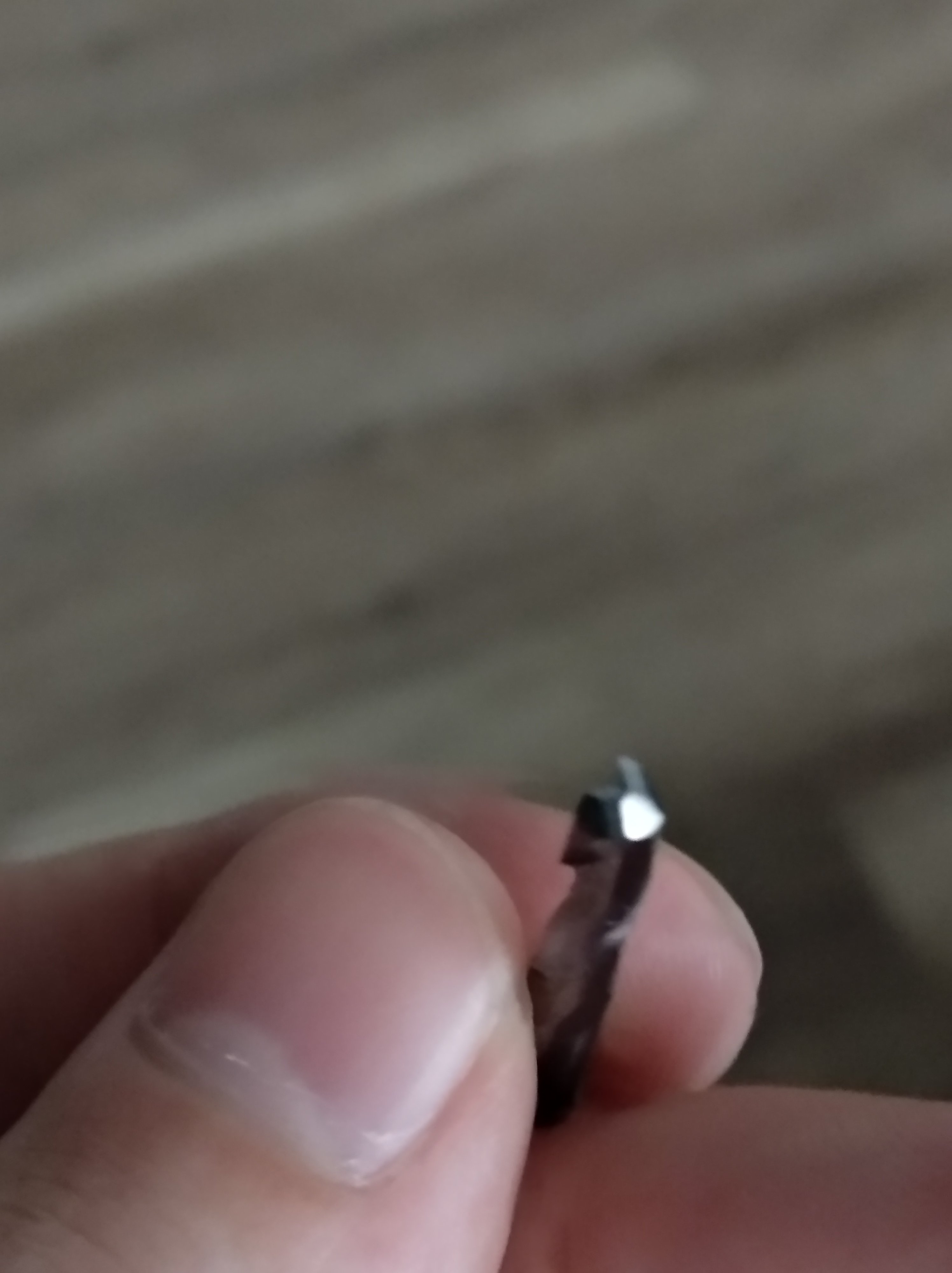

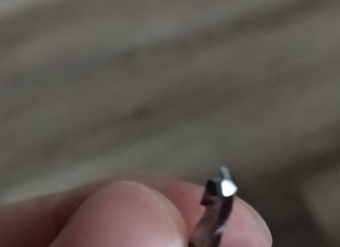

How old is your bit, can I see a picture or a link?

And you don’t need a lead in. If you don’t want to plunge use Ramp instead.
Yeah, 3.25. I’m using that diameter bits simply because I have a ER collet for dremel bits already in, and that’s the diameter it’s rated at.
I’m going to try 3mm/s plunge, sure, but what problems could it cause? It went the correct distance, and the bottom finish is the only good part of the cut.

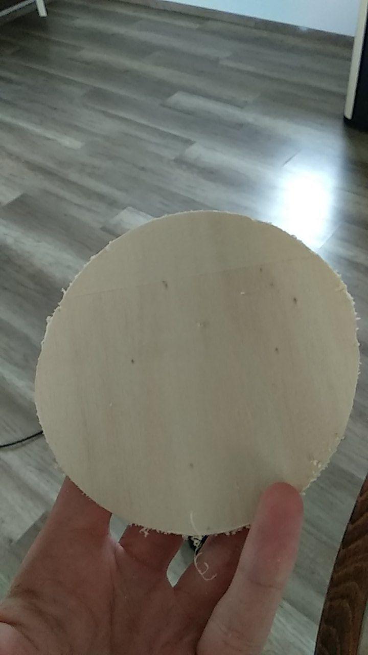

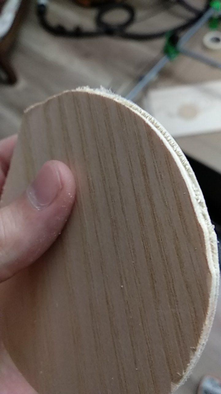

The piece has a decent finish, but the issue is that the stock around it is terribly cut, and it’s not round.

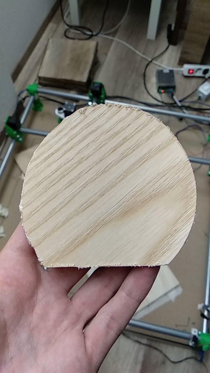

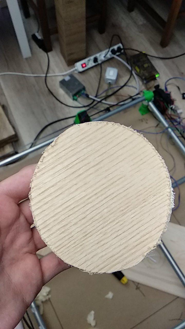

Here are the photos of the piece, it’s still inacceptable.
[attachment file=69454]
Also, the shape is clearly squished, and not a circle.
But yeah, there are less vibrations on the edge.

Something is wrong. Drastically wrong. Your spindle is moving all over the place. It should be obvious if you can wiggle it. The low res pictures you put up, I can’t see anything other than what I pointed out.
I sense you are getting frustrated but all I can do is ask questions and give suggestions. The gcode changes are just to make sure you are doing it correctly. Other than that it looks like your spindle is barely on the machine, or your endmill is cruddy and not actually cutting but I can only ask what you are using so many times.
What a finishing pass would do is see if your machine is capable of making a circle. If it cuts a crap rough pass it should clean it up 95% with a finishing pass, if that does not work you need to take it apart and start over make sure you didn’t miss any other steps.

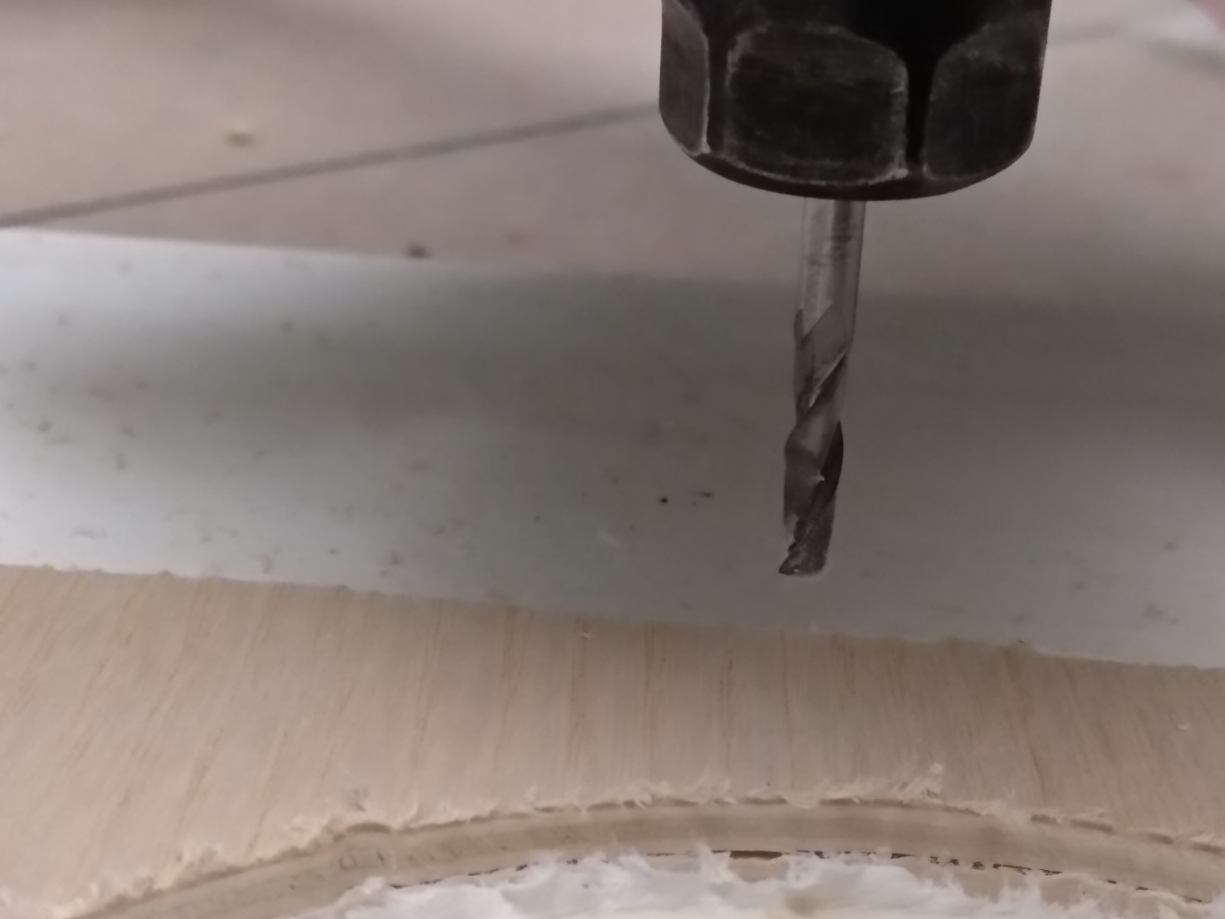

Judging by how fuzzy your middle layer of wood is I would say your end mill is garbage. It is normal to have a fuzzy top or bottom but never in the middle.

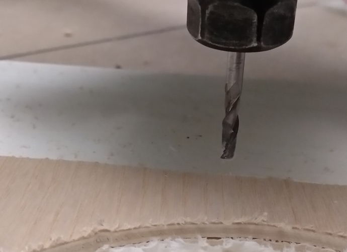

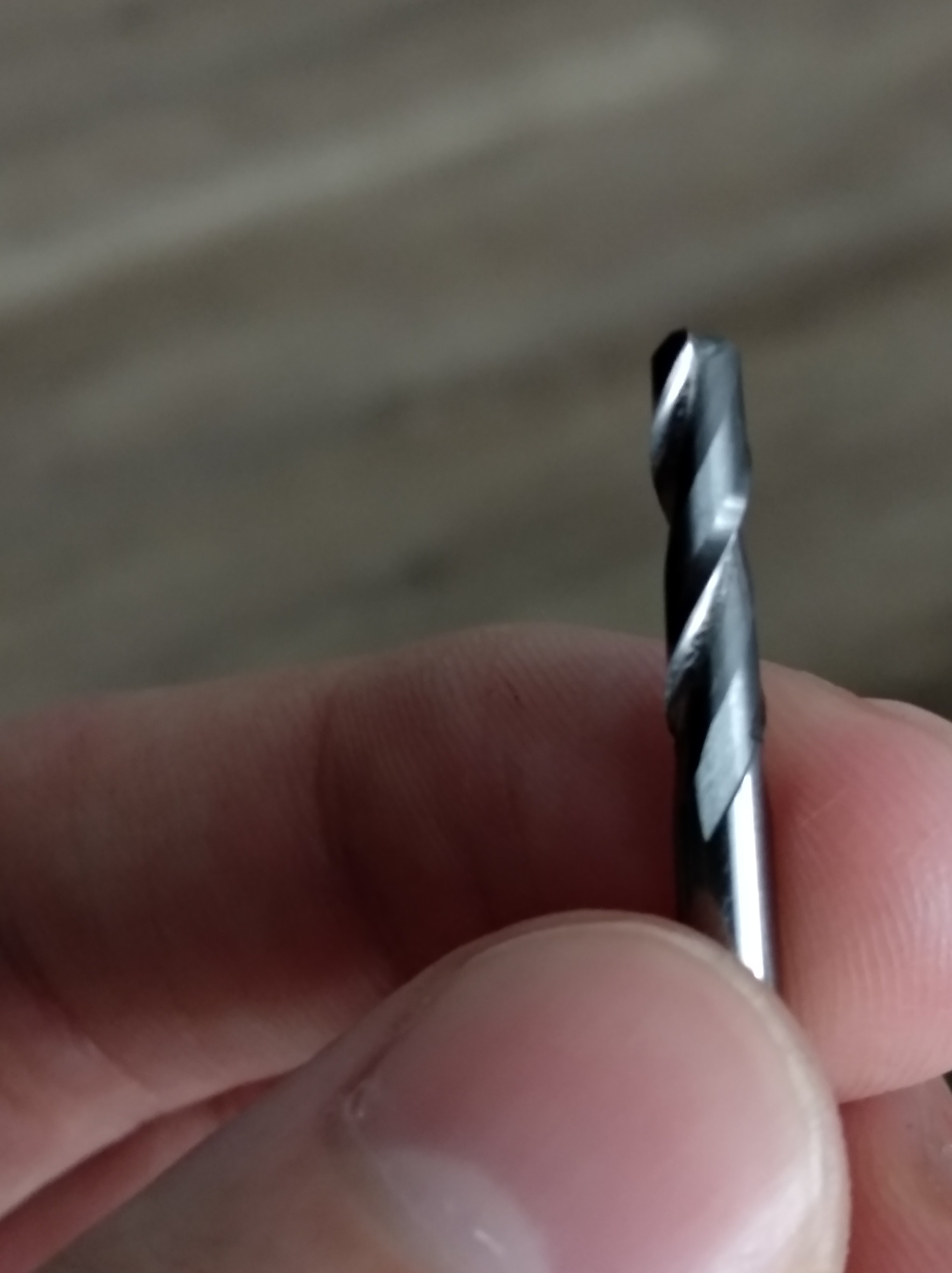

Oh, sorry, I completely forgot about the endmill photos.

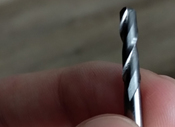

I don’t have a link because the ebay listing is long gone, but here they are.
[attachment file=69462]
[attachment file=69464]
Here is a photo of the one I’m running, at the minimum distance I could focus.
[attachment file=69463]
It’s not covered in adhesive or something, which was something I was worried about with the tape method.

The fuzzy middle is actually a misplaced cut, it’s a shelf it didn’t cut because it went too big (or the previous cuts too low, so the fuzz is actually the top of that shelf. I couldn’t remove it with a blade so, and yeah, in the photos it’s not noticeable.

The endmill looks really suspicious, I am not sure what that is for but it does not look right. The chip flutes look really small. Compare it to this, https://vicious1-com.myshopify.com/collections/sharp-stuff/products/1-8-2-flute-endmill
At the same time it could be dull, depending on how many bad cuts.

The endmill may be bad, I don’t really know, but they are also pretty hard to find here in italy (unless I wanted to pay 8€ for a no name chinese one on amazon), so I’m making due. It isn’t dull though, i’m using a new one for these cuts. The alternative are dremel ones, and they are even more overpriced. Chip evacuation isn’t an issue though. I believe the bit is for metal, because it makes a great chip on plastic (until the machine craps out, of course).
Sorry about the 3d printing terminology, still not used to troubleshooting CNC issues, but I meant that the fuzzy part is the top of a piece of wood that was left behind because the last pass was off.

Well your dimensions are correct, you say the crown was perfect. At this point I have no other suggestions than to get a proper endmill or your spindle wiggle is worse than you think. You are cutting really think light wood. There should be zero issues, you machine is acting extremely poorly and I can tell you you will not get far with how it is.
To lighten the load, you should really invest in a proper single flute endmill, that fits your collect correctly.
