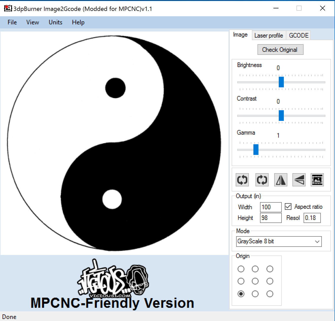

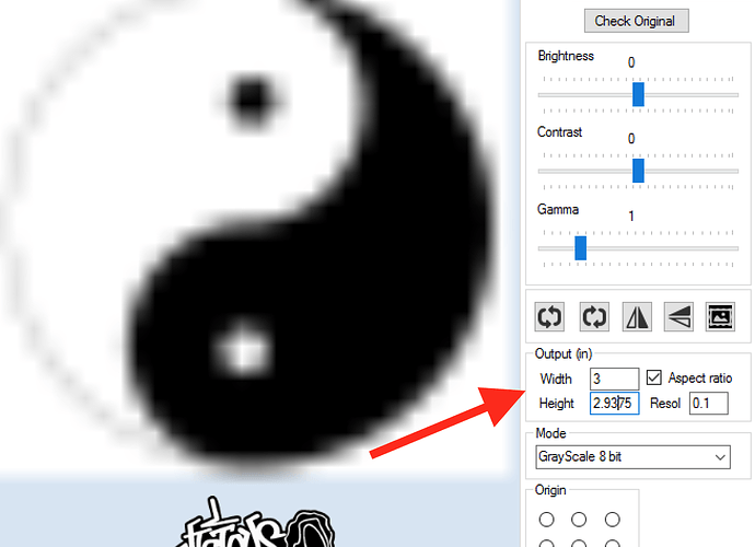

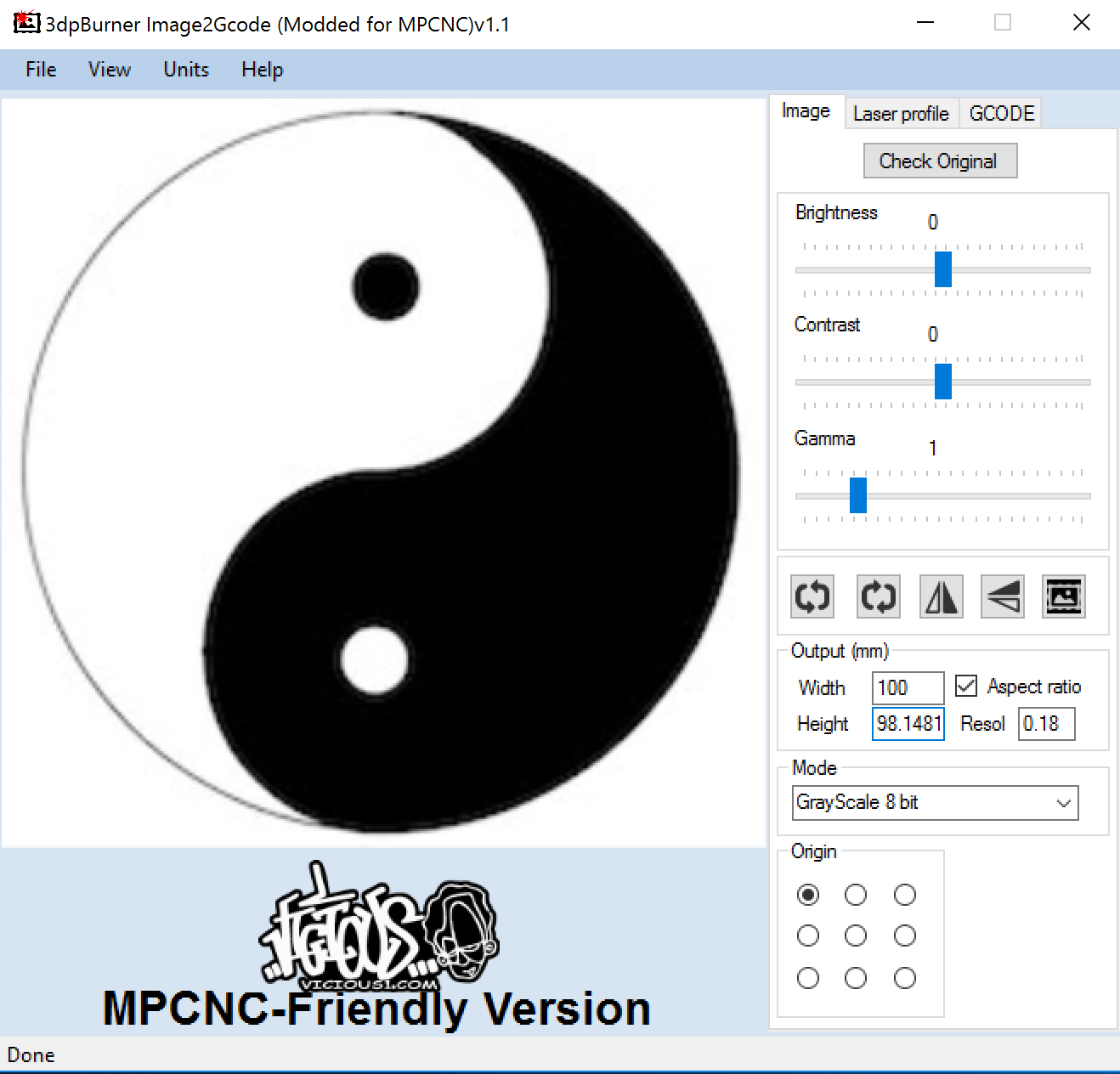

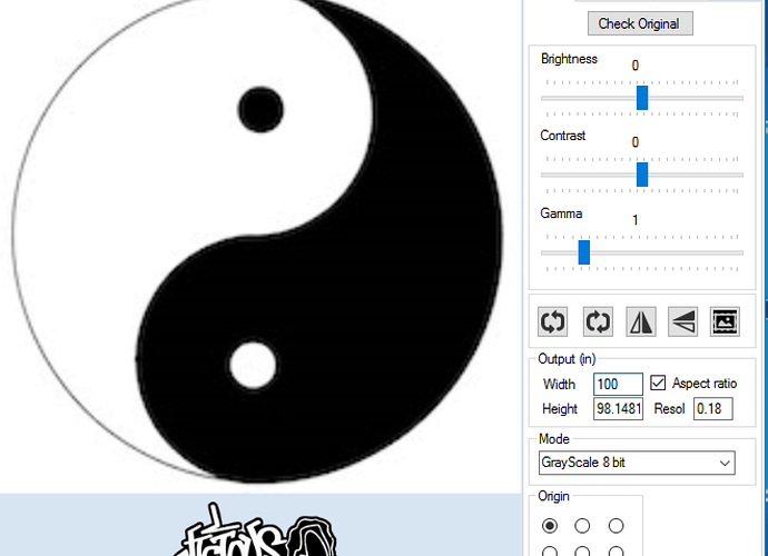

Here is something else getting to me, I loaded a file and the image size is set to Width 100 inch, Height 98.
[attachment file=42196]

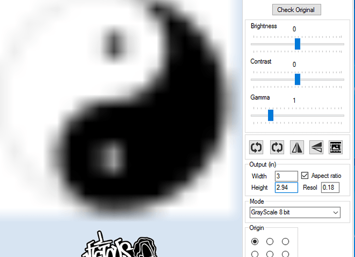

Obviously that is too large, ff I change the size to something more rational the image becomes blurry
[attachment file=42195]
I would scale it with an image editing program first to the dimensions you want.

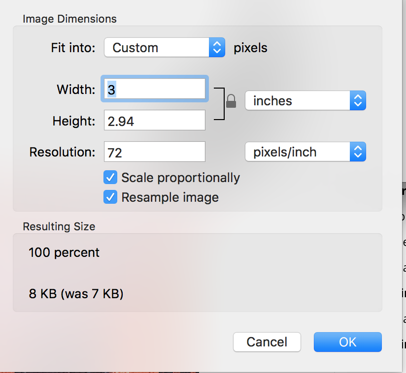

Ok I must be really missing something, I set the size in Preview to 3 x 2.94 inches
[attachment file=42206]
When I load that it still looks weird, if I adjust the output dimensions it makes it all blurry again
[attachment file=42212]
Will this really print out 100 inches ?
Try a different image editing program. Is that a MAC?
Yes sir
Dang it could just be a MAC thing. Most here are on windows or linux. MAC isn’t super maker friendly.
Am also running Windows 10 in Parallels, what image editing software do you recommend? Paint.net? Gimp?

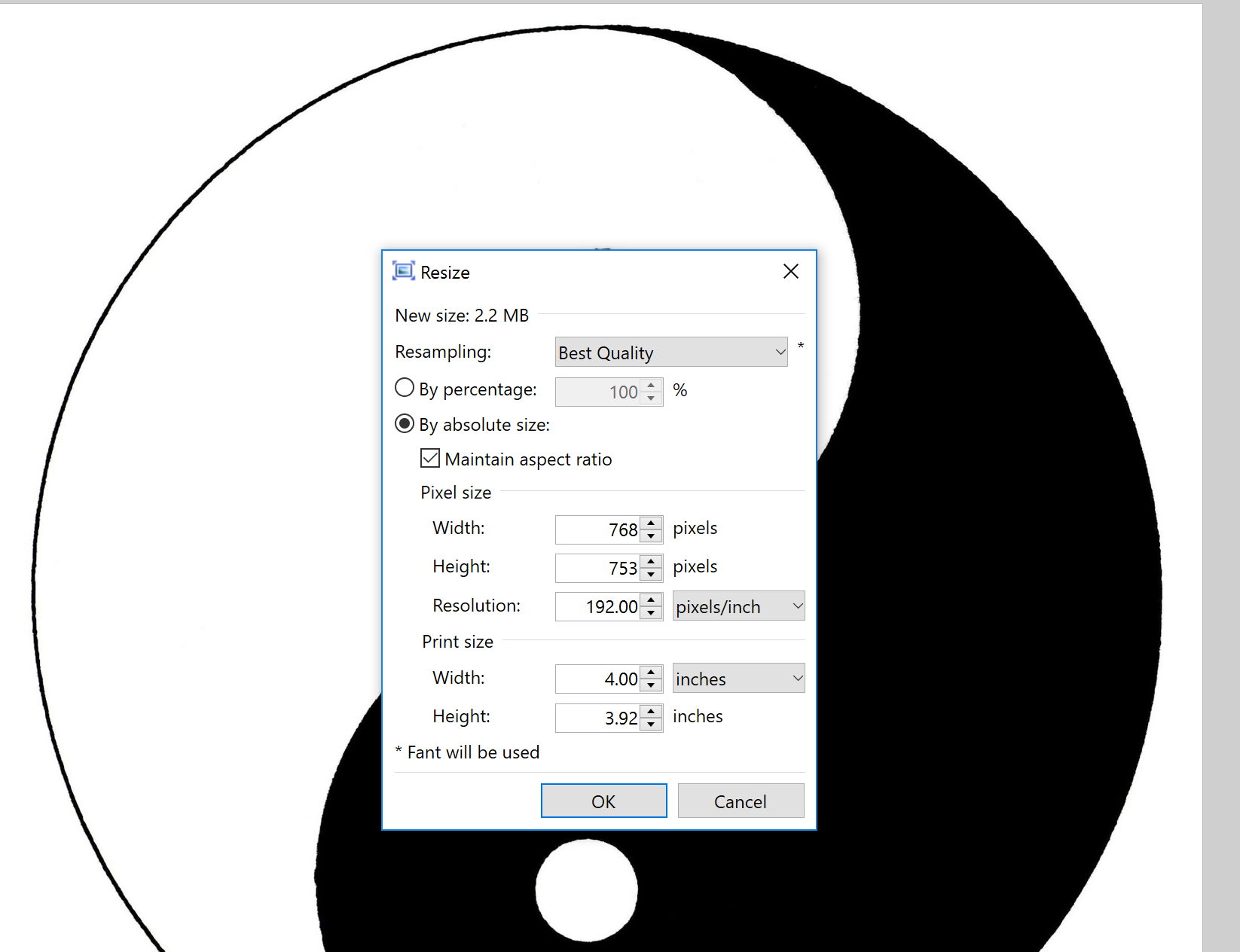

Should I even mess with output size ? Every time I do the image gets blurry
[attachment file=42456]

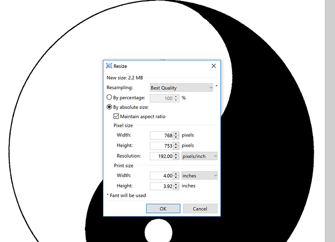

I opened Paint.NET, resized the image to what I wanted
[attachment file=42457]

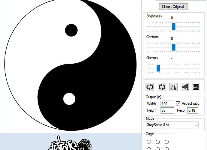

Then open in Image2code, still, only 100 inches displays correctly
