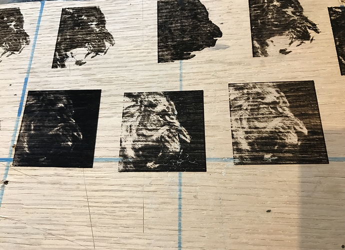

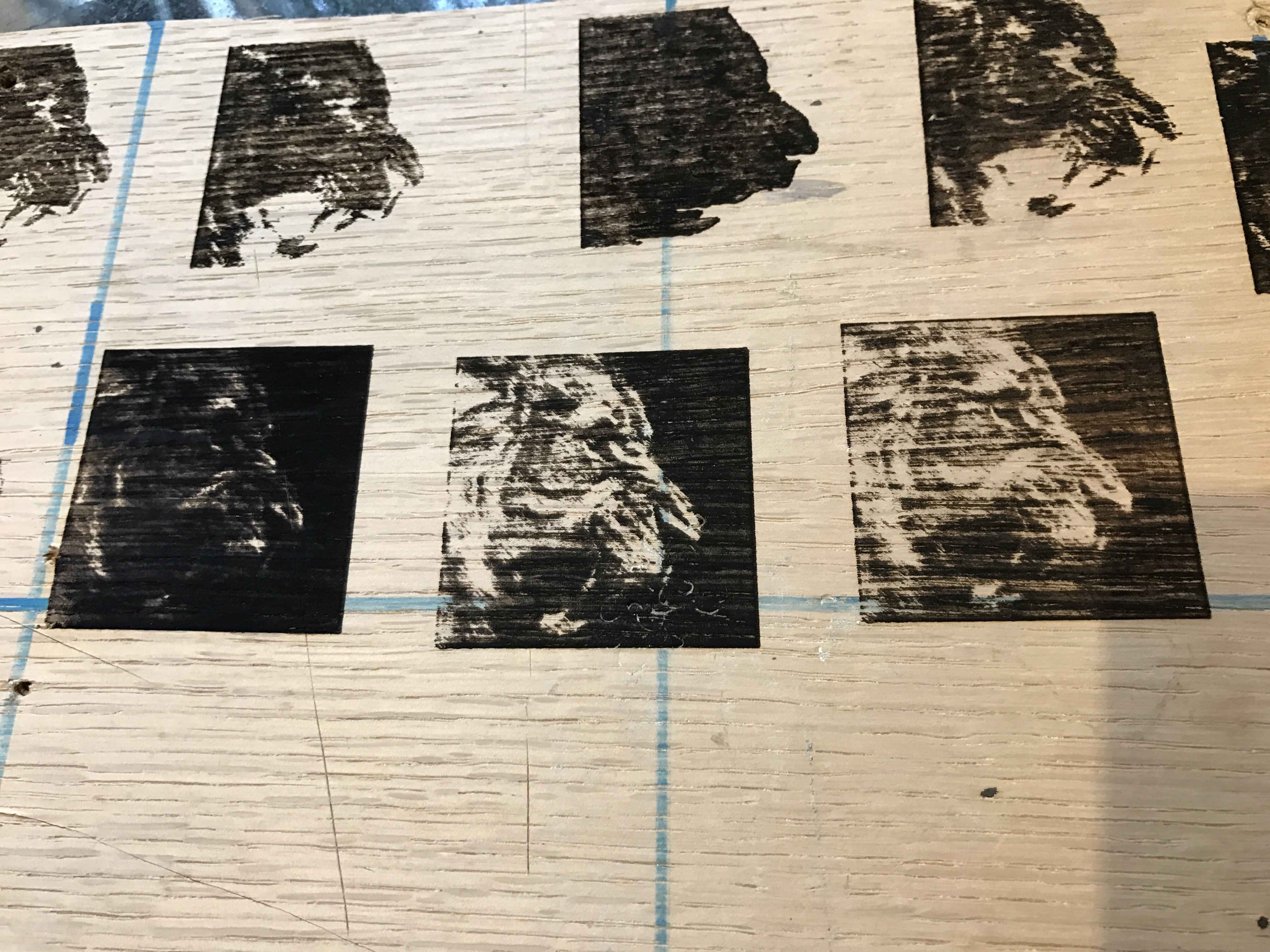

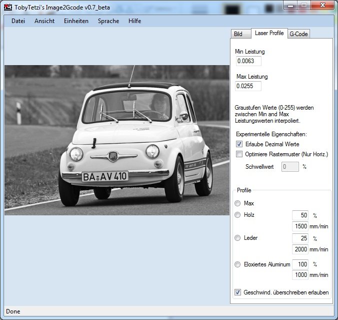

Not sure which version you’re using but the optimized feature was removed quite some time ago.
Have you provided details about the driver and diode you’re using? If you’re using regular 8 bit engraving then your max value should be 255, not 256 as you mentioned. Like Jason said, try without optimization and with a max value of 255. If you still have problems then do some troubleshooting on your own by downloading a trial version of a commercial software like picengrave pro to see if the issue priests. Troubleshooting is a process of elimination, not guesswork. Need to determine if issue is hardware or software related before you continue.
That looks better. There seems to be some sort of issue with either the optimized or horizontal scanning. I’m fine using diagonal. These were all running 3000mm/m @ 100%, 50% and 35% power with the acceleration changes in the header.

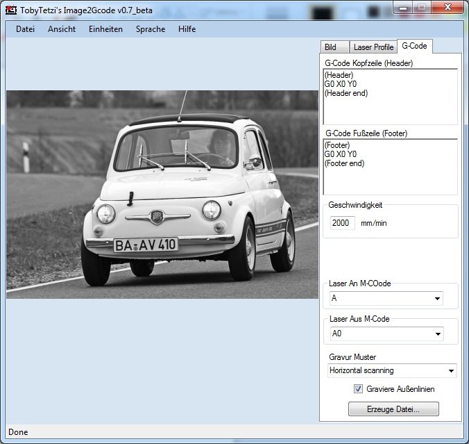

In all of the videos I have seen the laser is moving nice and smooth. When I run my program it seems very jerky in the motions. I have tried slow/fast, diagonal/horizantal, with and without the header (listed below). Here are the settings for the attached link.
(Ignore the loud bangs in the video, kids running around upstairs)
B/C/G 0,0,1 (Defaults)
Resolution .1mm
Mode GrayScale 8 bit
Min 0
Max 255 (Probably too dark)
Header (I have tried with and without this)
G0 X0 Y0
M201 X1000 Y1000
M204 P1000 T1000
Feedrate 2000mm/min (I have tried several values lower than this with no change)
Horizontal Scanning (I have tried Diagonal with no change)
Any thoughts or suggestions?

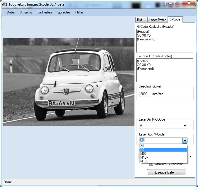

Lots of good info in here. You all have really put some time in. I hate to ask, but has anyone come across a similar raster ability in a Mac native program?
This weekend my buddy and I started to debug why it isn’t possible to use the program with my laser (100w Co2) and using the port P4 (Arduino MKS 1.4)
I’m missing the: G4 Time in ms [P] Dwell / Wait command. Before and after the laser command.
You find this in de code
file_gcode.write(self.options.laseroff + ‘\n’)
First we tried it with the command in front and later with the command behind it. Then we added it before and after the command.
file_gcode.write(‘G4 P0’ + ‘\n’ + self.options.laseroff + ‘\n’ + ‘G4 P0’ + ‘\n’)
First i had an offset, when added it in front the image was inverted. When the commands are in front and after the laser command it solved the problem. I was able to convert a jpg file with the black and white scale (only that) to laser it.
But found out that the MPCNC is to slow to use a 100W Co2 laser to engrave in greyscale

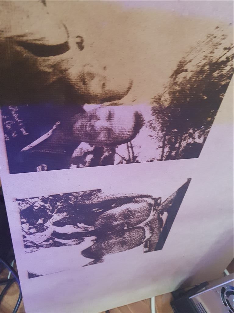

Hi all,
I am witing here first time. I assembled MPCNC and added a 2,8W laser. I can draw nice logo with laser and using inkscape however facing problems with images. I use image2code(MPCNC) version 1.0 .
Firmware is RC7 vicious.
Image2 code many times would like to move few meters out of reach, here I delete the X or Y movements and is ok.
However I miss details on picture, gradient. The quality changes even if I try twice the same picture.
I use 0.18 resolution . Sometimes used 0.15. Using 1000mm/min feedrate and 100% power. I get nice black details without gradient.
When tried 1500 fedarte it jitters too much…
Any help would be appreciated.
P.S. On the one picture I got quite good output. While on others is very bad.
The new firmware might really help, rc7 has the stuttering when combined with the LCD. RC8 fixed that but had other issues. I am hoping the new marlin kept the good parts of RC8.
