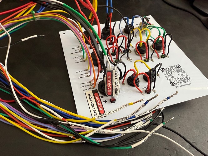

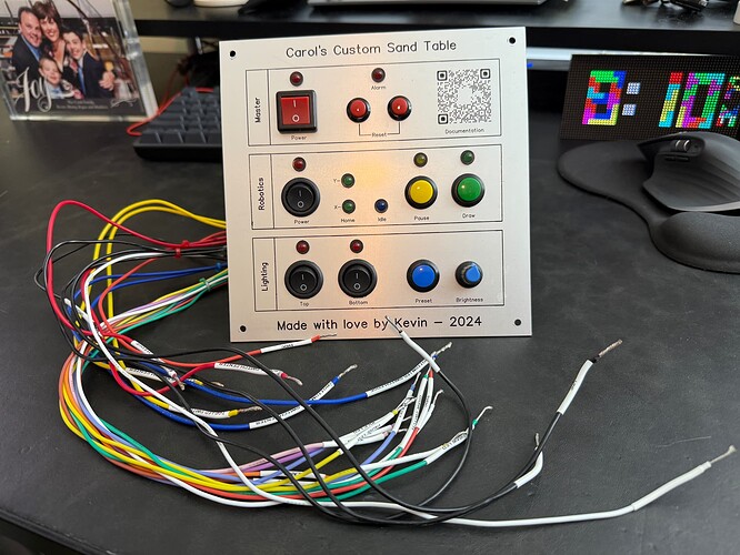

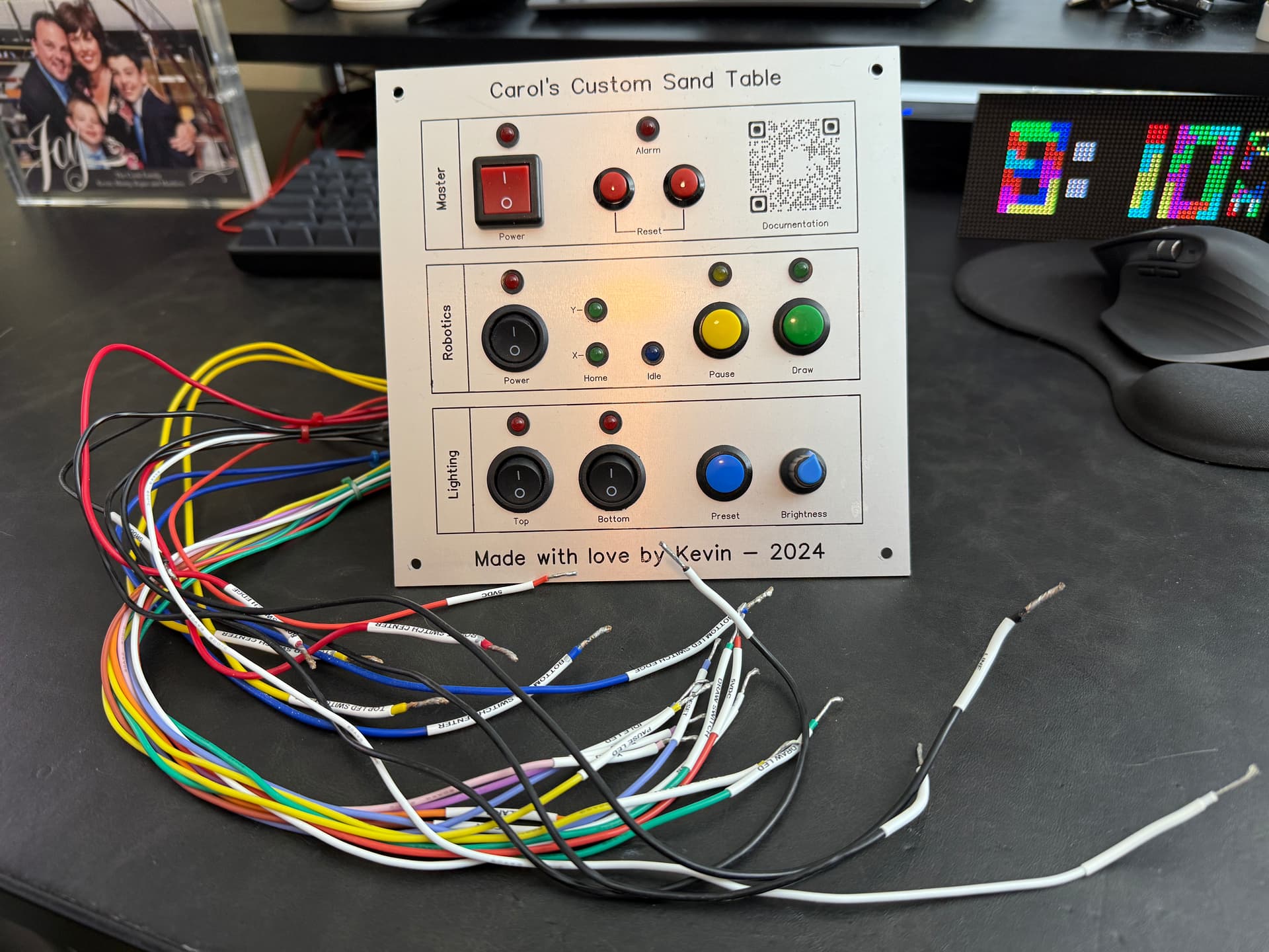

Hey @jeyeager - Here is the control panel in the final wired / labeled configuration.
Wait. Is that panel a PCB of sorts? I was not expecting wires to be directly soldered to it.
Oh yeah, I didn’t notice that. That’s awesome.
@jeyeager - Yes - Exactly! I used a PCB design tool to create it and had it made on an aluminum PCB instead of the usual fiberglass because the dull silver aluminum really matches her table. Since it was a PCB, I was able to save A LOT of wiring and make it cleaner by having a common ground and running just 1 ground wire to it, and then just 1 wire for each input / output. I surfaced the common ground and the I/O traces right next to each switch / led. It made it very clean If I were to do it again I would use a surface mount wago lever lock connector for the feed wires.
