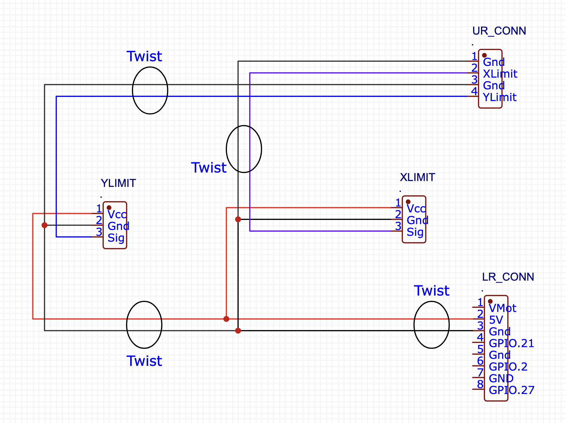

Do twisting of your wire pairs coming and going. Like shown.
Twisting isn’t absolutely essential, but it’s good practice.
If you aren’t able to twist them, at least tape, tie, or bundle them so they’re not random wires in a rats’ nest.
quick question; what’s the best way to make the y=splices required in the diagram you provided? I can solder them together at those locations; I’ve done a little bit of that before.
Just asking, but are the 3 points at ground a good idea? That looks like a potential ground loop to me, though it depends on the length of the ground wires going from the UR_CONN to the LR_ CONN connectors. I just run one +5V wire out to both stops.

OK, all, I got some Y connectors on amazon, wired it as diagramed. I did not make twisted pairs.
Here’s what I find.
When open, each of the end stops is producing a signal on the order of 380 mV. When closed, each of the connectors is making a signal on the order of 4.7 V.
However, I also tested each of the stops when the OTHER STOP was closed. In truth, I got mixed up, and was testing the signal for one when I was actually closing the other one. So, the ‘induced’ signal in one stop when the other stop is in the closed position, if that makes any sense. The induced signal is about 1.6 V. Which, that seems odd to me.
But, in every case, I think I have the stops wired up!
Now what?

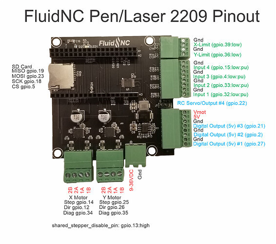

I’ve been re-reading this topic, and am de-zombifying it.
It looks like @LosTyger is still having difficulty with the endstops, so I’d like to get back into troubleshooting this.
First step, measure the voltage at the Jackpot board with a DMM or oscilloscope while trying to home. We need to see what the control signal voltage is doing while this is happening.
Checking the voltage…where on the board?
From your config, it looks like:
x:
 motor0:
   limit_neg_pin: gpio.36:low
So, for this the connector in the upper right between GND and Y-Limit (Note- are you seeing the discontinuity here? The hardware defines this as Y-limit, but your config is defining this as X limit. This could be the whole problem).
Then, for your Y: the config shows:
y:
motor0:
  limit_neg_pin: gpio.39:low
In a similar way, the board picture above shows this as the upper right connector, top pin, but again the picture defines this as X-Limit and your config defines it as Y-limit.
Either way, these are the way I’d test it. If you have a scope, put a scope on these two points. If you have 2 DMMs, put the two DMMs on these points. If you only have one DMM, monitor one point as you try to home an axis, and then switch and monitor the other point as you try to home that same axis.
Then watch those two points as you switch to homing the other axis.
We want to build a truth table of what voltages you see, on which pin, as you try to home X and as you try to home Y.
Edit to add: How did you wire this? Which sensor goes to which spot?
