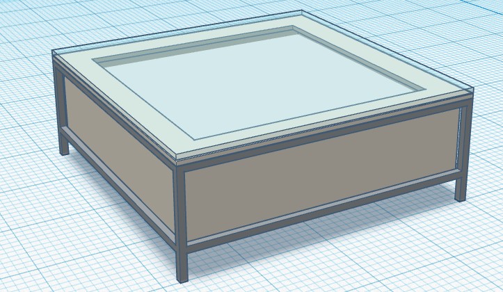

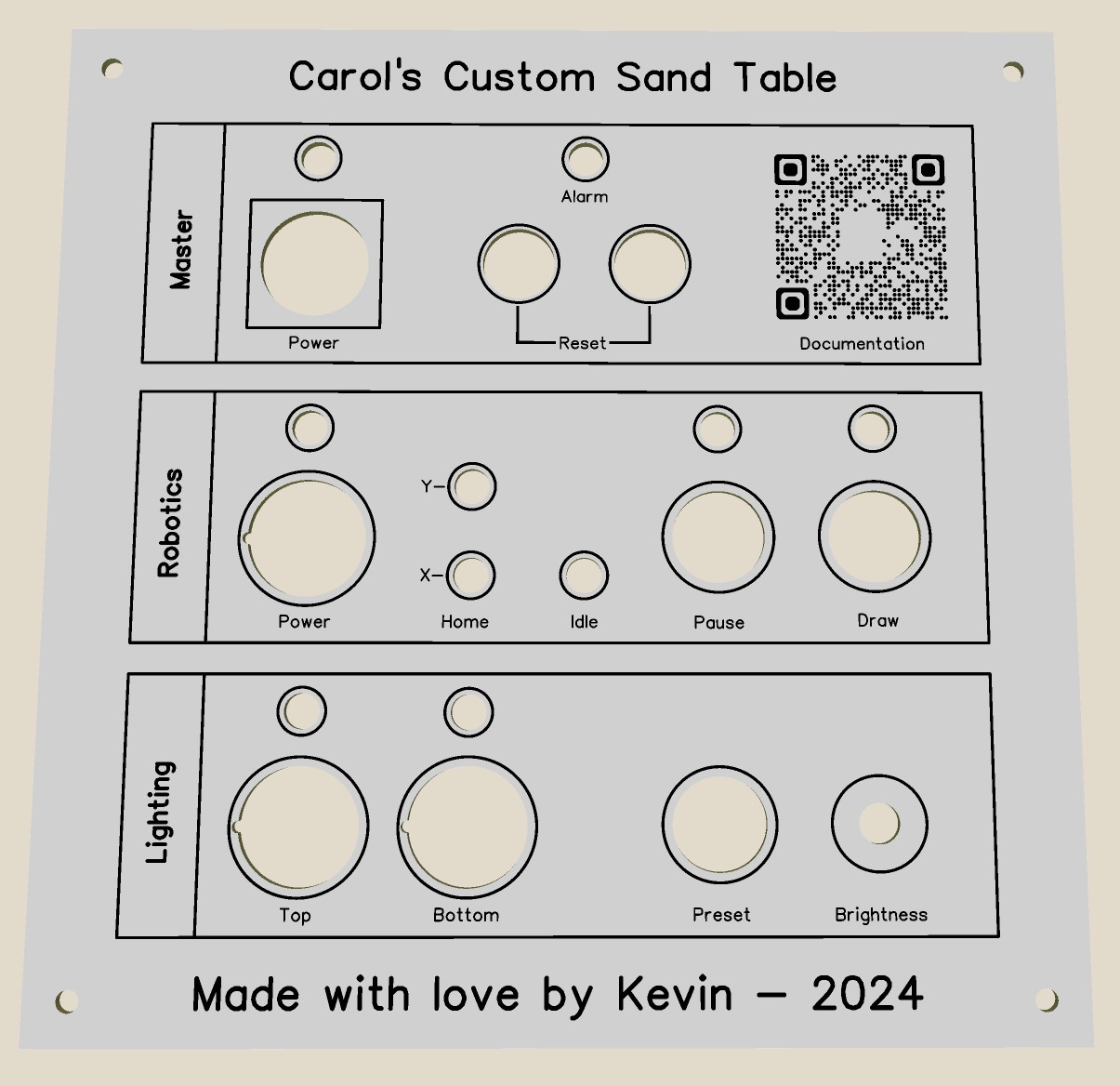

Hi Everyone - I’m building a ZenXY for my 85 year old mother and I’d love to see pictures and hear ideas about what any of you have done to simplify the “User Interface”. I have started to design a control panel so she won’t have to go into the FluidNC web interface or the WLED web interface.
Her existing coffee table:
My build so far:
What it should look like when done:
The control Panel I’m working on:

Can you clarify the thought behind your control panel? Are the larger circles buttons and the smaller ones LEDs?
On the FluidNC side, did you have any thoughts on how this might be implemented? What board are you using? There is a line where some things you can do via buttons directly into the board and other more advanced things requiring a separate microcontroller.

@jeyeager Yes - The larger circles are buttons (Inputs) and the smaller buttons are LED’s (Outputs) - I have it auto start a playlist.gcode upon powerup or reset, and have the play (Draw) / pause buttons working. I’d love to figure out how do do the “Next” code - Have you ever done anything like that?
