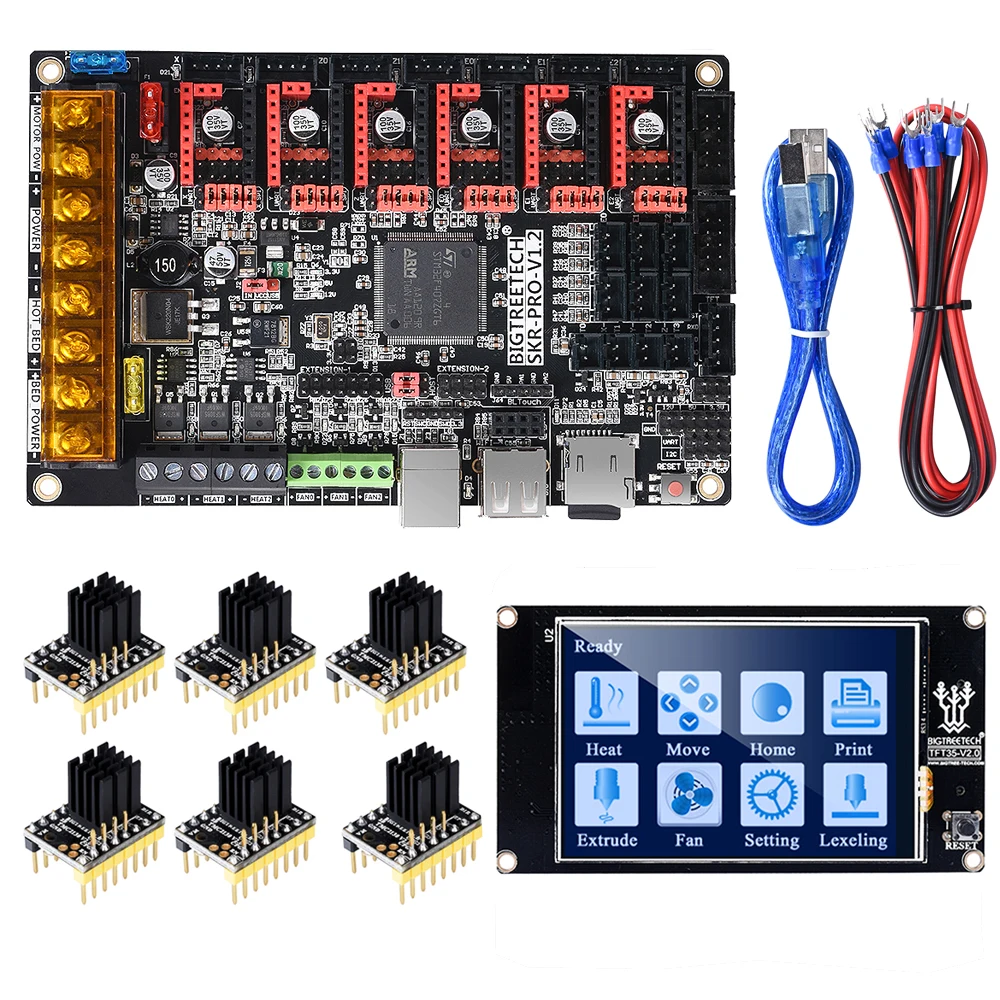

So- basically I running TT tech firmware and when I do my tool paths with two different endmill on the same gcode via micro usb - it freezes after the first one is done . I was hoping there was a way to get these SKR with tft screens to have the ability to resume after the first tool path is done via gcode through the screen .Thanks a lot
one last thing I love your case for the SKR /tft you posted ,unfortunately I got a package that come with the TFT35 V2.0 and sadly does not fit - is there any way you can update the top cover to if it, that will be awesome .
I have link below for my screen information
I can, but i would need one of those here to do it.
it could be added to your thingiverse drawing I will assume.
I would add it to that, yes
Forgot to respond to the tool path resume, I think more info is needed on why it’s “freezing”
If it’s waiting for an input, or if it’s actually not processing your tool changing script. I don’t use tool changes anymore since F360 took them out of the free version.
