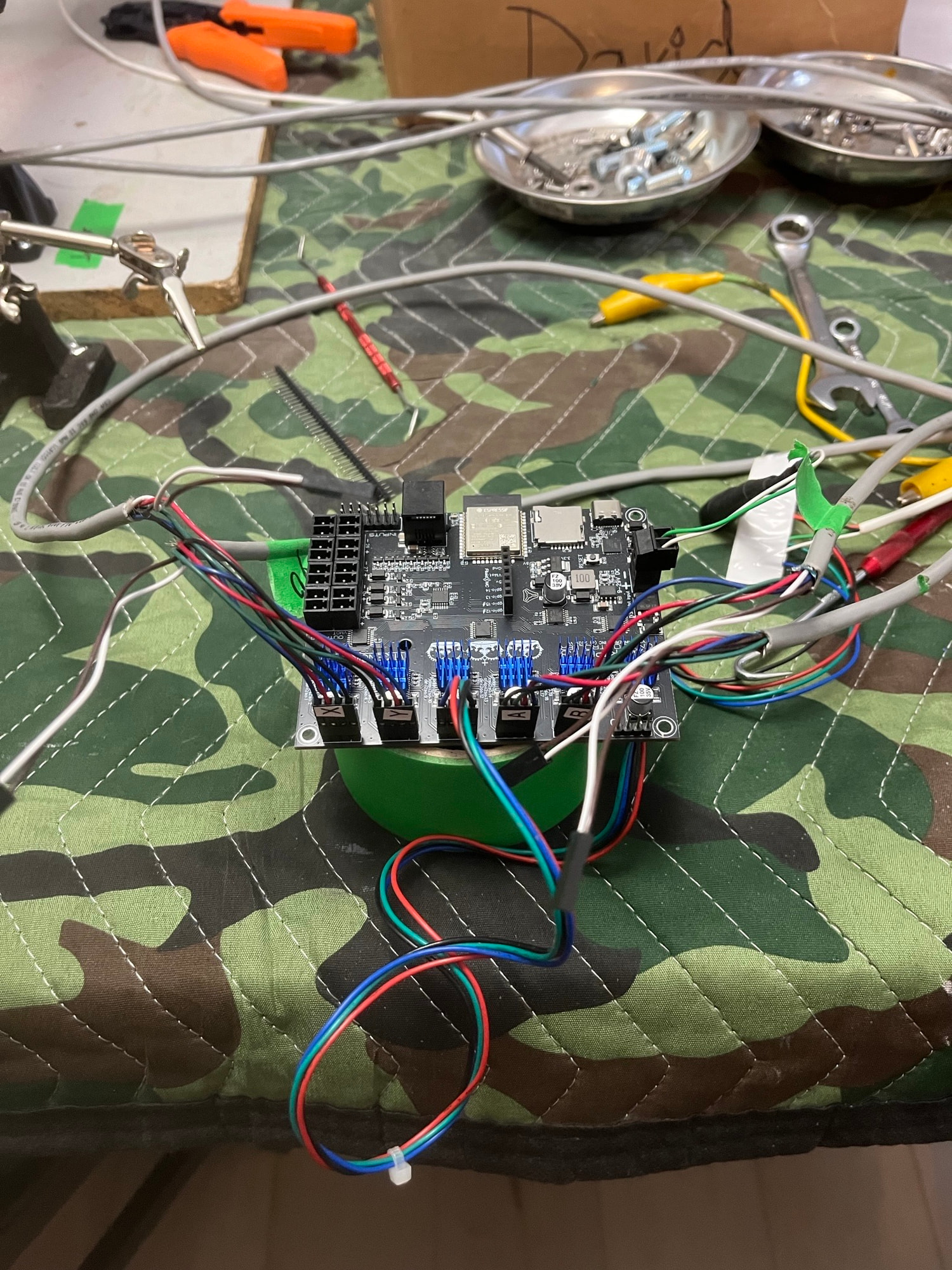

Deep Newb, and I could be in over my head. I have been working for for four days trying hard not to open a new Forum thread, however here I am.
I purchased all the items for my items for my MPCNC in Dec 2025. I connected all the stepper motors, gave the JP3 power, found FluidNC in the wifi. Opened that and made my motors move. DL’d and loaded the proper MPCNC file. I built the MPCNC, connected the motors and made everything move. Here is where the problem started.
I cut the wires from the motors to extend and reconnect. Now all I had was Z working. Neither X nor Y would move. This is my first time using those Dupont connectors so my connections may not have been 100% but only 20% correct seemed way low. I metered the ends, found issues only with one. Corrected that. I connected my working Z to the X and Y terminals. nada. So in my mind it is not sending signal to X and Y.
I tried to install the firmware, again, and again, and again, v3.99, 4.02, 3.99. by “JP3 config for Primo”. nada. Now I have no Wifi connection as FluidNC isnt showing up as a Wifi connection. I went to “We will have 5-10 JPs not connect”. I think I killed her. This has been multiple attempts over 4 days.
I may have no business being here, but I’m trying really hard to understand. If someone could help with baby steps so I can get my JP3 and machine to move that’d be wonderful.

First off, tell us for all four of your steppers that don’t work X0,X1,Y0,Y1 - what do you measure for each of these coil A/B when you look into the connector where the stepper harness plugs into the Jackpot?
Second, What type of computer do you have, and are you sure you have a power and data USB cable?
Third, let’s get some pictures of your build, in particular the jackpot controller and wiring.

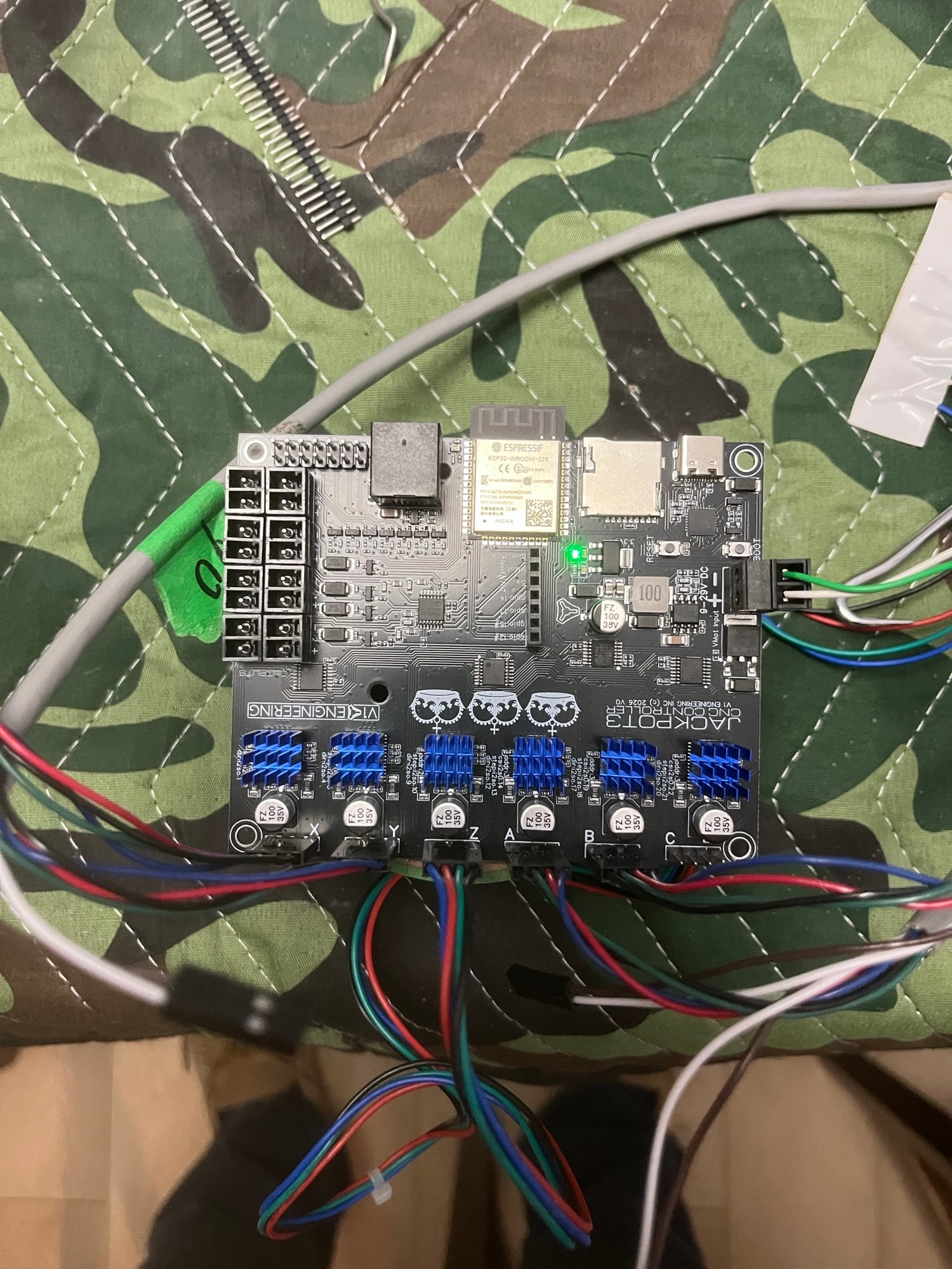

Metered ends - I checked all with resistance. No cross connection between A & B. All motors land between 1.7 and 1.9, mostly 1.8. One 2.0. All from the controller side of the wire set.
Once I give the JP3 voltage, on each of the X0, X1, Y0, Y1, I can measure 24v on pins 1/2, and I measure low voltage 2v and lower (if I remember correctly) on pin 3/4. One motor “bumps” as I give the JP3 the 24v, Z is also unresponsive after my attempts to FIX IT. This lead me to think it was a firmware thing. Probably is a firmware thing now though. LOL
Computer - Older Thinkpad I intended to use strictly for the MPCNC. i5-6200 processor, 2.3 GHz, and 8G Ram. Nothing Special. Hoping it was the workhorse for the job. Not 100% sure it is a power and data cable. I did see a note for that but I figured as it said it “connected” and appeared to give me the loading bar (0-100%) that should be fine. What about a step for finish/save/complete? Didn’t see that, I saw a disconnect and I used that a time or four.
Extra wht/brown wires not plugged in at this time are for the endstops.
Just checked all my connections plugged into the board again but this time testing resistance on the backside of the JP3. In my mind, this would prove my wires AND connections were all good. X0&1/Y0&1 wires all 1.7-1.8 and Z is 2.0. (similar wire, that’s probably why)

You need to upload the files for the MPCNC. Here is the link to them:
Your Jackpot3 is missing the config.yaml file and likely the other files that go on after flashing. That’s why you have no motion and no wifi, it’s entirely misconfigured.
You can use the web installer to reconfigure WiFi, instructions are here:
You also need to put the config.yaml file for your MPCNC back on the machine, which you can do over WiFi once you reconfigure your WiFi. If you were using AP mode before, you should put it back into AP mode for now.
The config files for a JP3/MPCNC live here:
In the file browser tab I see:
config.yaml 3156b Active config
favicon.ico 1150b
index.html.gz 120268b
So I don’t think I have nothing…. Or is it the incorrect file? the Board says its v4.02
It’s the incorrect file.
That’s the proof.
Edit: Load the correct config.yaml file for your MPCNC.
Make sure when you’re putting files on with the Web UI that you’re set to the flash filesystem and not to SD. The config files have to live in flash or they won’t be loaded.
