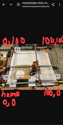

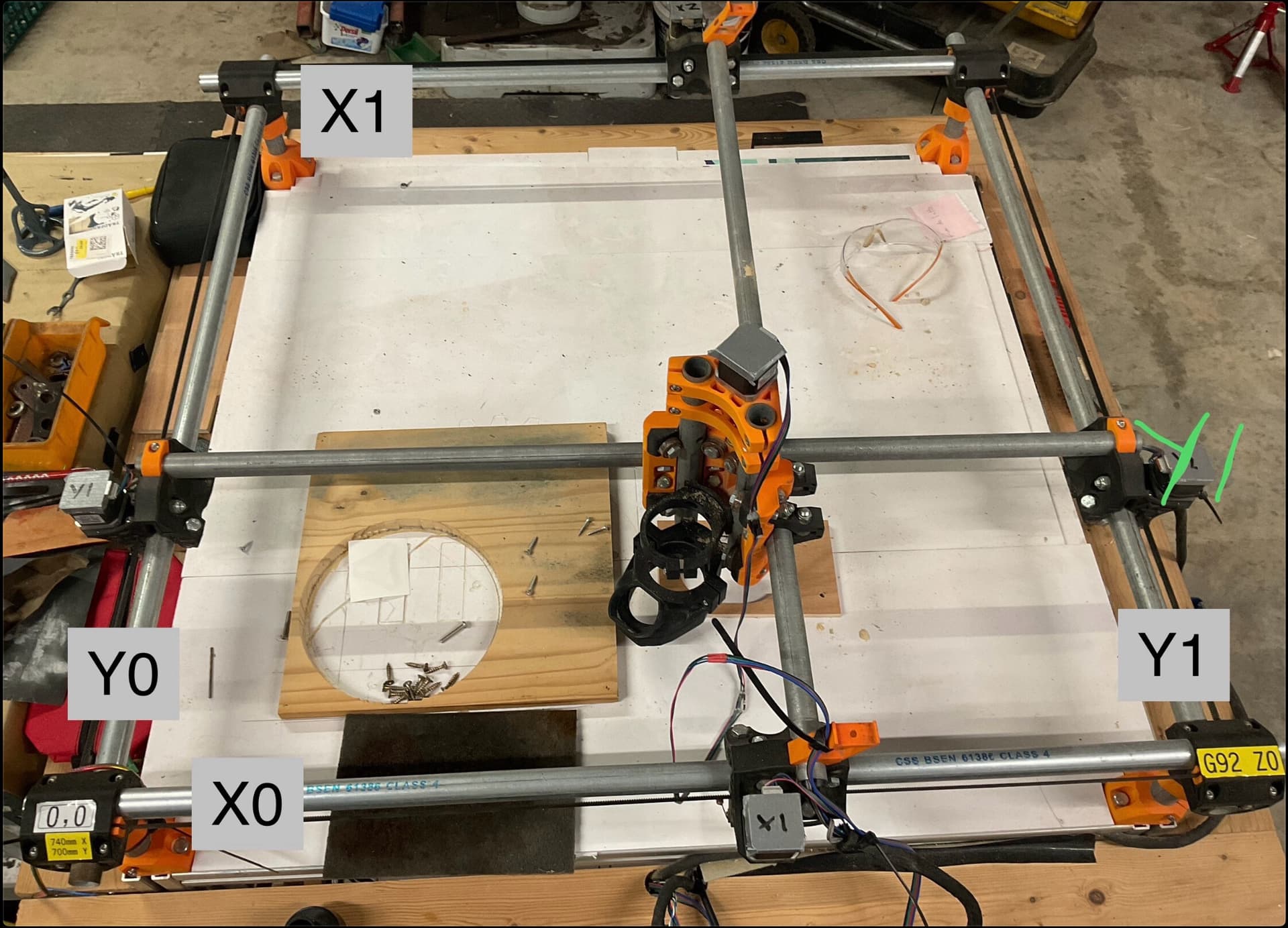

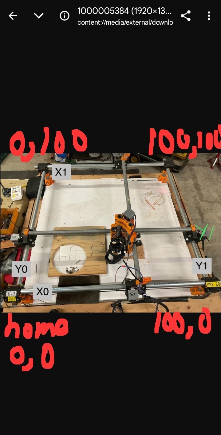

Ok, you have both Y motors backwards. Flip both connections.
Y+ moves towards me
X+ moves right
So when it homes…it goes left and up from the pose I was in…towards the green… so was trying to flip Y+ & Y-
You have both X backwards, switch them as well.
You want y+ to move away, x+ to move right.
This puts your home as bottom left corner.
So flip on the board? I did it to the picture provided a few weeks ago.
So just flip the cables including the steppers correct?
Just flip the connectors at the board. The 4 pins can go in either way, having them backwards at first is super common.
Power off before you mess with the wires.
My apologies…x+ does move right
Just flip both ys then and you should be set.
And if Z+ moves down instead of up, flip it. Control wise you want x+ to move right, y+ to move away, and z+ to move up.
Your looking at a coordinate system like this, if you had a 100x100 work area. X is the first#, y is the 2nd.
