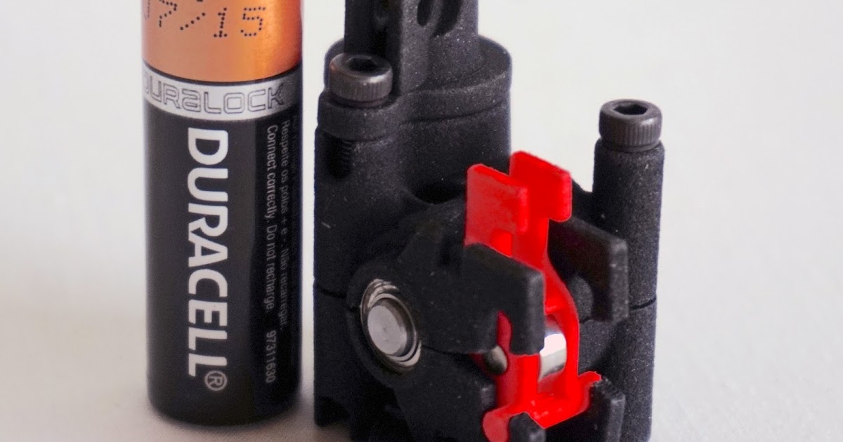

Do you happen to remember the direct /remote drive extruder you pointed out while we were in line for tacos? I would love to see if they are still at it and how the prices are. It had the flexshaft drive thing.
That’s the one!
Dang, $100 each… Really good idea though. I could see six of them driving into a six way diamond head giving me all the colors I’d ever want.
I think I posted this before in the MRRF thread, but here’s a really good review on it.
Wow, 30:1 ratio. I wonder how much backlash there is.
Do you have one Barry?
I’m assuming this would still need a hotend (and a mount). It seems like a great compromise between Bowden and direct.
