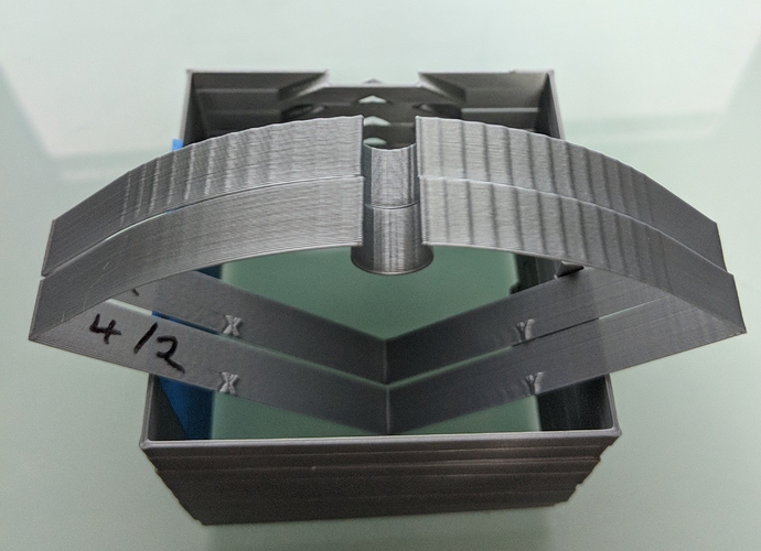

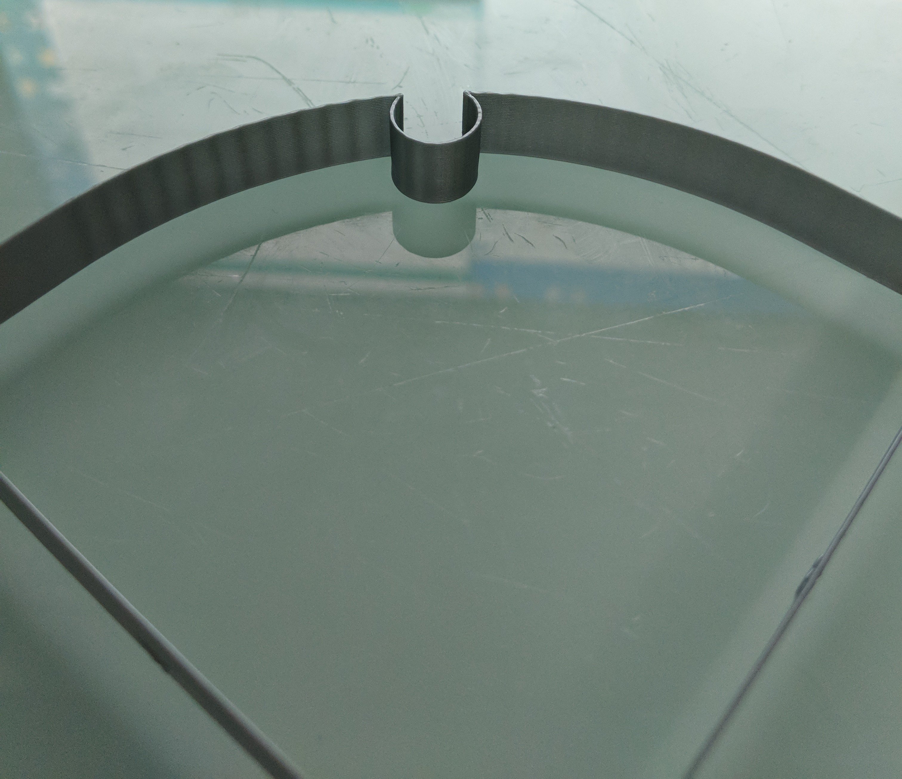

Progress, I think. Here is a better test showing the issues I saw in the real print.
75mm/s accel 1500mm/s/s test part is smooth to 5° STL conversion.
Jerk x=4 Y=2 still
Showing horrible bulges at 5 degree increments heavier on the left which was ramping into x axis parallel so super shallow Y moves.

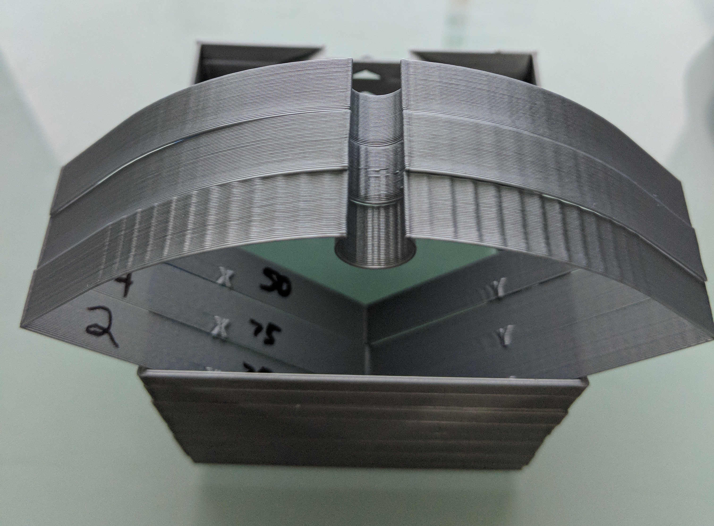

Jerk both 2⌠both sides bad, needs to go higher! You can see the emboss ghosting differences.
[attachment file=51503]

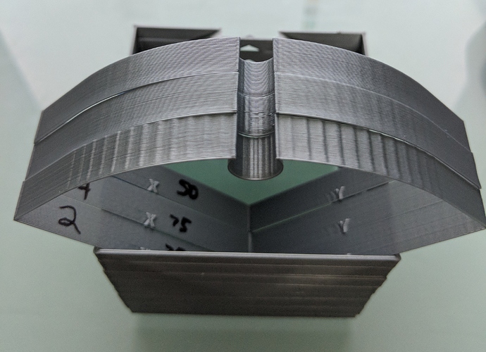

Jerk both 4 @ 75mm/s and 50mm/s
[attachment file=51504]

Let me guess at whatâs going on. I think those are being printed as line segments, so with lower jerk, it is be trying to reduce the speed at each point. The higher jerk is making it take the curve at a smoother speed. I really wish there was a way to display what speed it would actually take thereâŚ
I think youâve made a better test print, in just worried it wonât translate well to another radius part. It looks like this artifact isnât ringing at all though, right? Itâs just over and then under extruding. The filament flow isnât dynamic enough to match the dynamics of the x/y motion.
I wonder what it would do with an arc.
Very interesting though.
You can hear it in the big round corners too low of a jerk and it sounds obviously wrong. Still havenât found the equations. Not sure this was a big deal or notâŚ
Finally found the equations, seems obvious nowâŚMarlin/src/module/planner, duh. 4 planner files and some in the 2 stepper files Jerk is mostly in planner.cpp and the trapezoid is in planner.h (starts at entry speed).
How I am reading it. It calculates the speed trapezoid (basic straight line) starting at whatever jerk is set to as the minimum speed (entry speed), this sets both ends of the ramp up and ramp down. Smooth velocity is checked to see if the change in velocity is higher then the jerk to trigger accel or not (curves).
