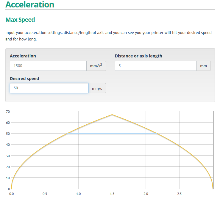

The prusa calc page has the trapezoid for acceleration, it is a cool visualization. Really lets you see at what point it hots full speed and how long a segment would need to be to get there.

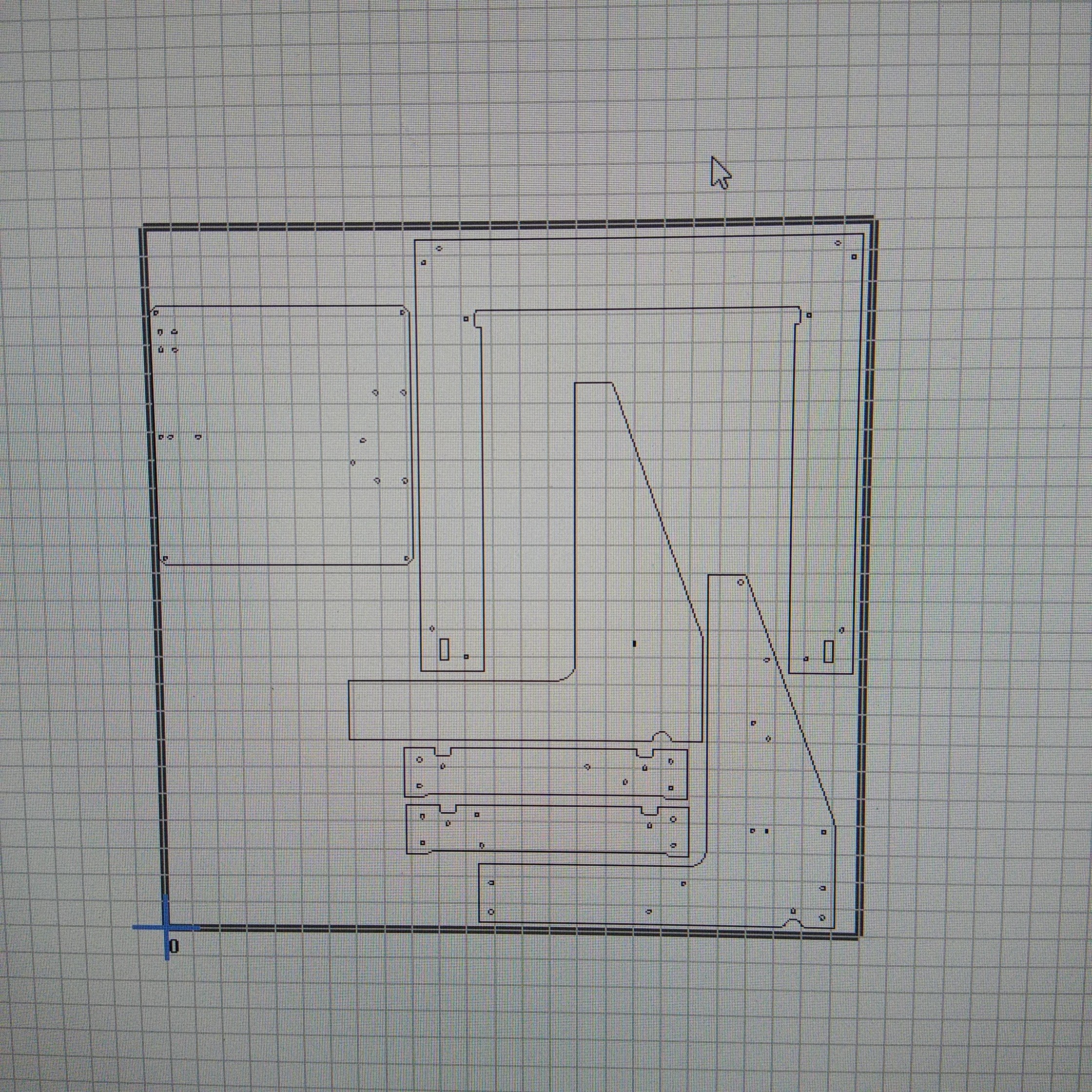

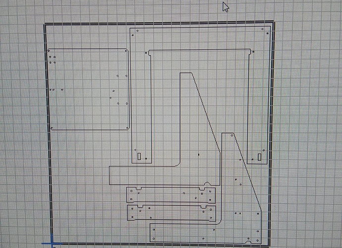

I can get the whole thing on a 24 x 24 piece! I could get 8 out of a 4x8 sheet. I’m gonna have to make more printers.
With room to spare!

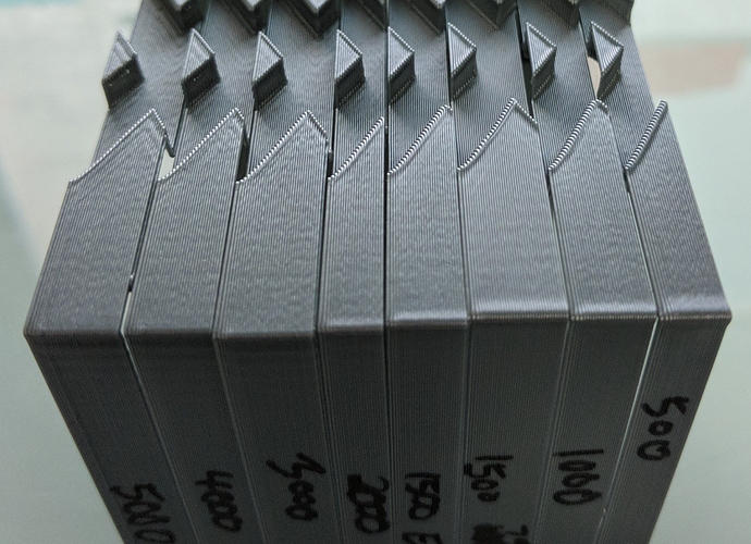

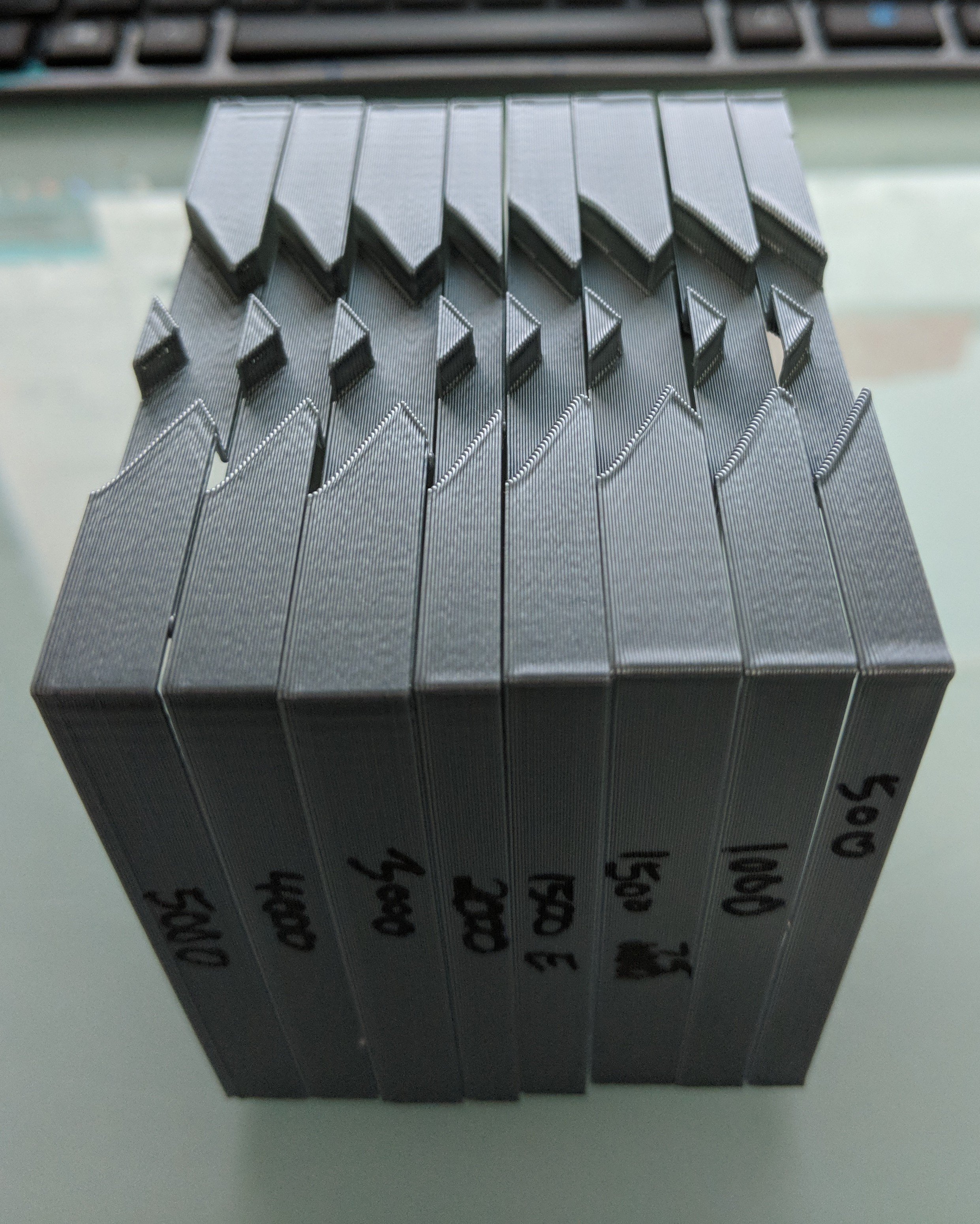

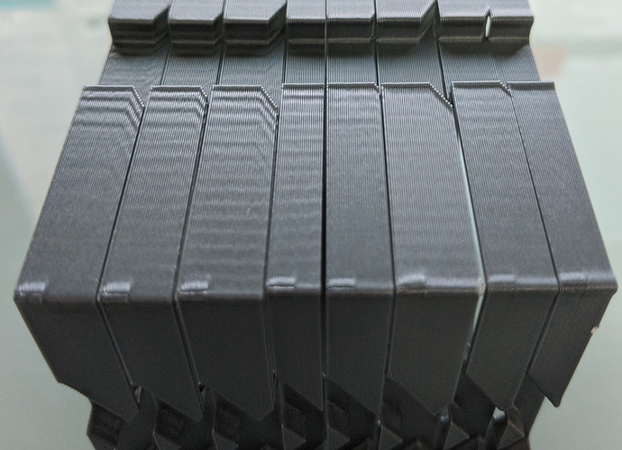

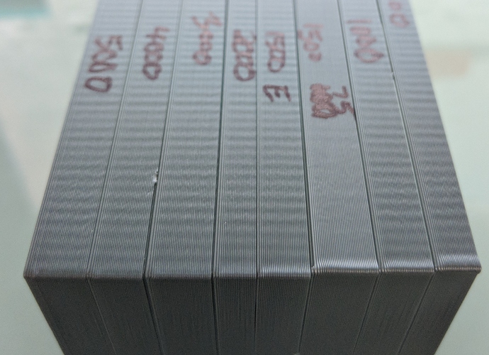

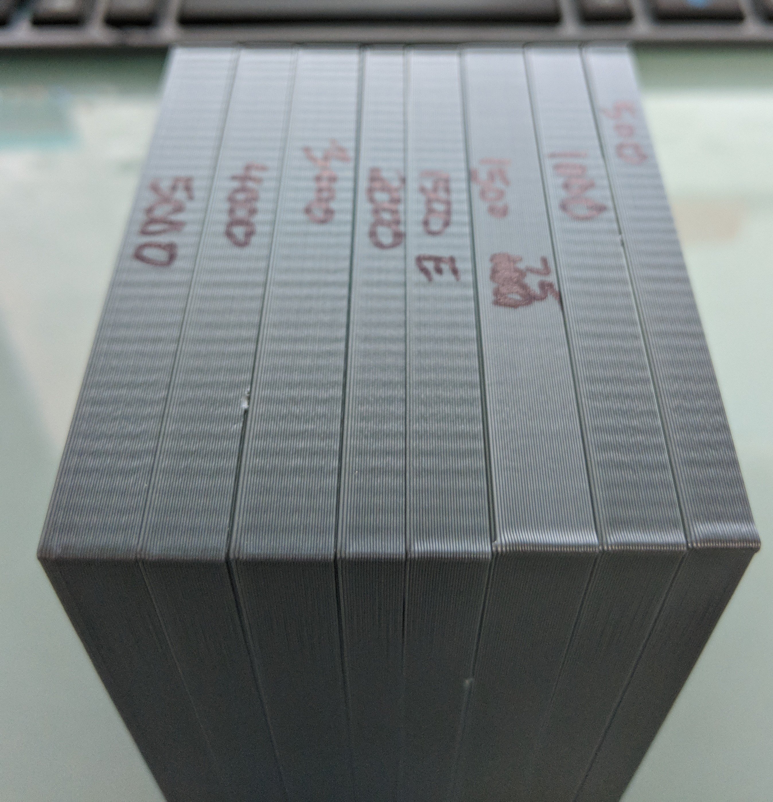

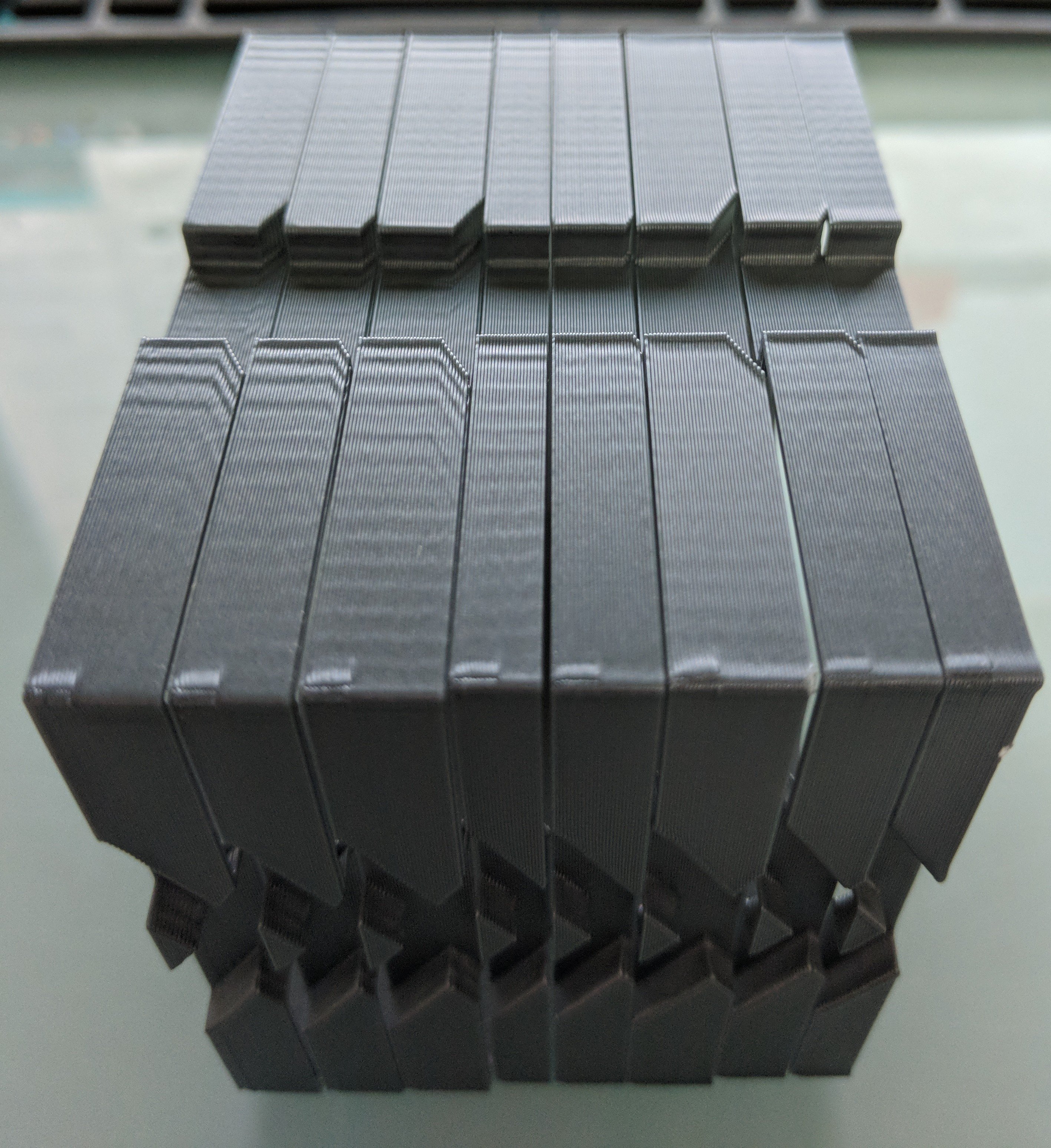

Inconclusive? A few hours later I learned a lot. I disabled all slicer enhancements, coast, min layer time, so this should be raw plain gcode. The test was only 90° corners so I would assume no jerk came into play it was set a 4=X and 2=Y (never changed them forgot to make them equal just in case). Same printer, same gcode, same filament, same room temp, same speed 50mm/s. To do the tests I only changed XY DEFAULT_MAX_ACCELERATION and Default Accel all three numbers where always equal. I ran them alternating fast and slow zeroing in on a speed that sounded good and looked good. 500mm/s/s to 5000mm/s/s.
[attachment file=51371]
Sat parallel with the Yaxis (bed), should show X axis ghosting.

Sat parallel with the Xaxis (extruder), should show Y axis ghosting.

X again, with accels labeled.
So now the odd thing…the clean one was at 75mm/s! 100mm/s failed as the time between layers was too short and it just squished but was looking great before it died horribly. Once the accelerations are where they should be I think you can really crank up the speed. It all makes so much more sense now. I could go a step further and tweak the two axis separately but I think a little belt tension experiment is up next. Then figure out how best to set the jerk.
I mean I have been very happy printing at 35mm/s forever, this made 50 look simple and 75 was really not that bad. At those high of speeds though first layer time and minimum layer time need to be dialed in or it fails fast. I only ever bothered to tune the MPCNC ( I will be revisiting it very soon), Why did I never tune a printer…Dang!
The printer starts to sound a little rough at 1500 and 3000 sounds pretty harsh. The first pic shows why I honed in on 1500, could go either way a few hundred depending on how you where planning on printing, fast-less acceleration, slow- a little more, so 1500 seems like a sweet spot. I know it might sound a little sluggish but it is not.

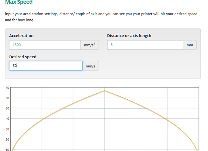

[attachment file=51377]
It is getting to full speed in about 0.8mm.
With this and coasting enabled I think the corners would be perfect and it would be smoking fast.
