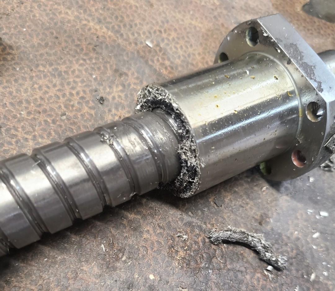

Here’s a ball screw that failed. Chips and dirt eventually work there way up into the balls and chew them up, causing failures. This one bound up tight causing the servo to fault. Others developed lots of play . Evey with sweeps on both ends.
Very useful info!
How are the belts secured? Wondering if there was less wrap around the drive pulley if steel braided belts would work? Is that what they use in the big machines?

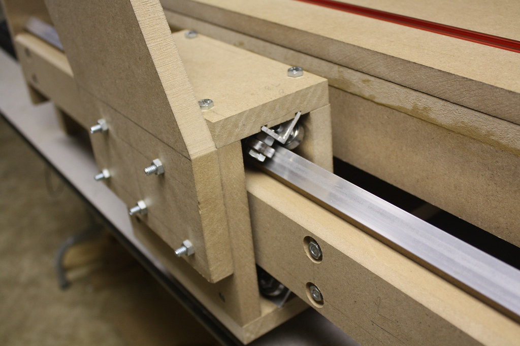

Also i’m gonna throw this out there as a new idea for easy to source materials that could be cheap but strong. This is a potential Rail idea. It could be used with aluminum or steel angle extrusion.
