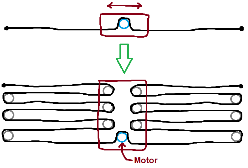

Belts stretch. It gets worse the longer they get, and there’s pretty much no way around it.
You can get wider belts but the width only goes so far. You can’t get GT2 belts that are 50mm wide, and even if you could, it’s probably not viable for other reasons.
But belts can be very long, so how about a block-and-tackle to add stiffness?
This allows the belt stiffness to be arbitrarily high if you are willing to add enough pulleys and extra belt length.
This also effectively gears down the motion, so you might want a larger pulley on the motor to get back some speed. And if you have a large drive pulley, you could change all the pulleys for large ones, and then perhaps you can use the white belts with steel cords, although I don’t know if those are in fact any stiffer than regular belts.
To me this is out there, and hilarious, and yet at the same time it should actually work and it is still better than ball screws. So maybe not your every day baseline design but a stiffness upgrade option.

Just put a spring loaded belt tensioner on it like a car’s serpentine belt has.
I don’t even know why I laughed out loud at this
That adds flex to the system.
