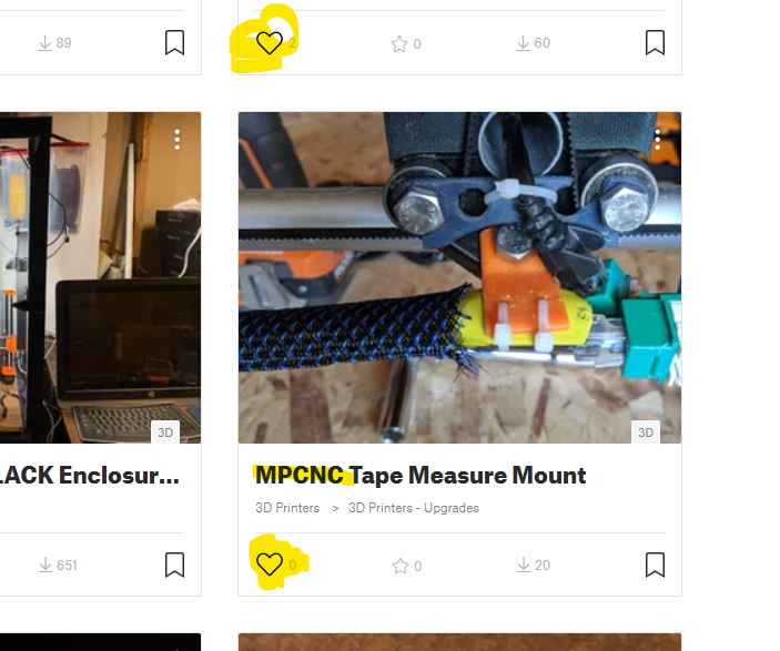

I was trying to think of a way to make this as easy as possible to build for the V1 website. I came up with an idea that may be garbage or gold. Lets say we use a website like prusaprinters.org to hold all the models, images, instructions, comments etc… Then on each of those listings that users want to have added to the V1 User Mods Catalogue. They need to add a specific Tag (search key word). Then the V1 catalogue would just need to do a live search of the website for anything with that tag and show the results sorted by the number of hearts that model has received on that website.
For example. If a user opens the catalogue and clicks on MPCNC - Burly then it would do a live search of all the models on prusaprinters.org that have a tag of “MPCNCBurly”. Then it would show the results with a thumbnail and the 150 character summary of what it is. You can see the number of hearts a print has and sort by that.
This is also good for a mod that works for more than one version of the machine. If a specific mod works for more than one machine then the user just needs to add the additional search Tag. The catalogue could have instructions for users to submit their own mods.
The only thing this idea doesn’t do is have a way for V1 to endorse mods/upgrades. But I suppose that could be done by manually adding links from the documentation.
Very obvious problems with this idea would be if random people start adding random tags to unrelated models/pages. Or what if prusaprinters.org changes format etc.

Well I think you solved it. Directed search. Printables or Search Thingiverse - Thingiverse If someone wants to put their name in the hat for a mod all they have to do is include the key phase. In this case, “mpcnc needle cutter”. That would probably need to be more like “Mpcnc Primo needle cutter”
You are right though people could abuse the key phrase but liking projects would make the cream rise to the top.
