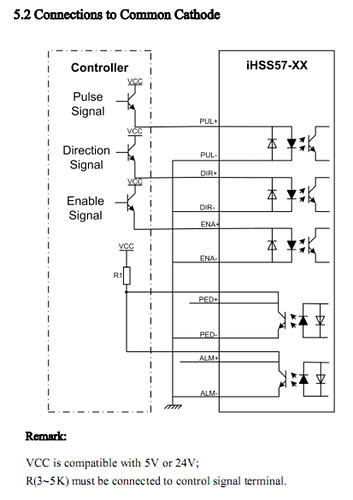

i cannot understand connection from my new xl board to HBS86 closed loop driver

You’re using this EstlCAM controller?:
You’re using these CL steppers?

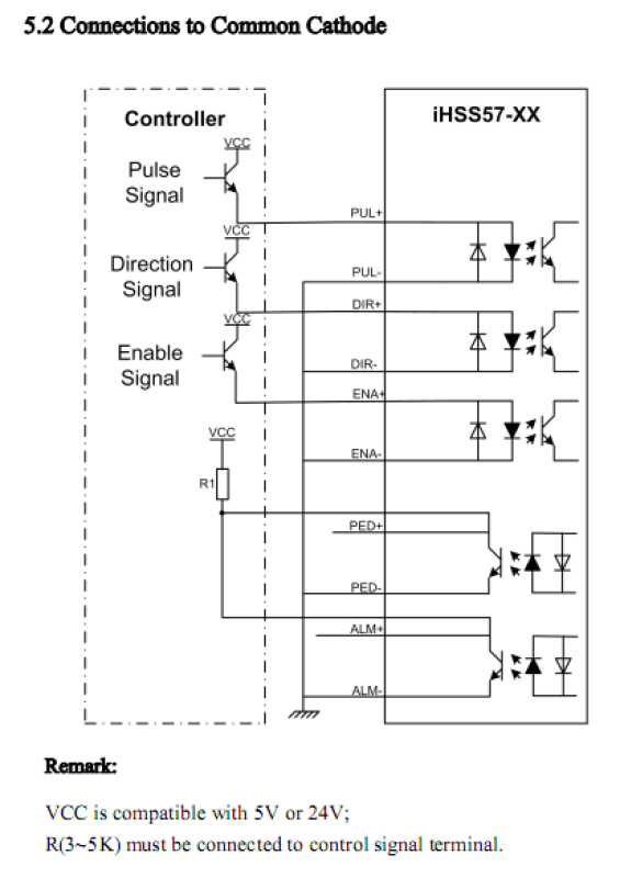

It does not appear that the EstlCAM XL has any native closed-loop support (it doesn’t directly read a position encoder), see the partial schematic below:
This means that the stepper/encoder/controller in the HBS86 just receives standard EN/DIR/Step signals.
You would wire it just like any other external stepper driver, for each axis you’d wire from the controller to the external driver the following signals:
GND - GND
EN - EN
STEP - STEP
DIR - DIR.
You’ll need to confirm whether the EstlCAM XL is common cathode or common anode.
My guess is that it is common cathode.
