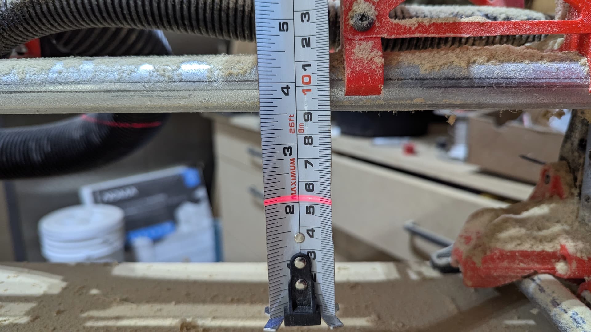

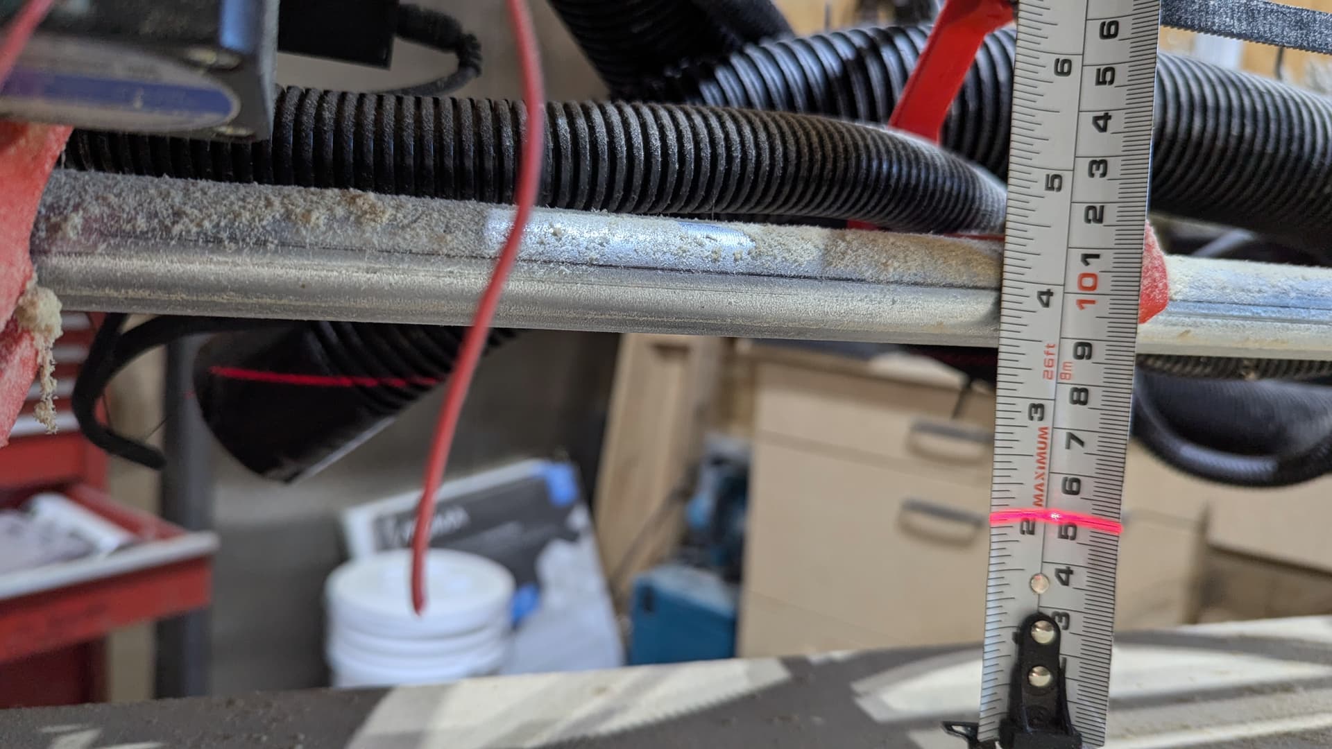

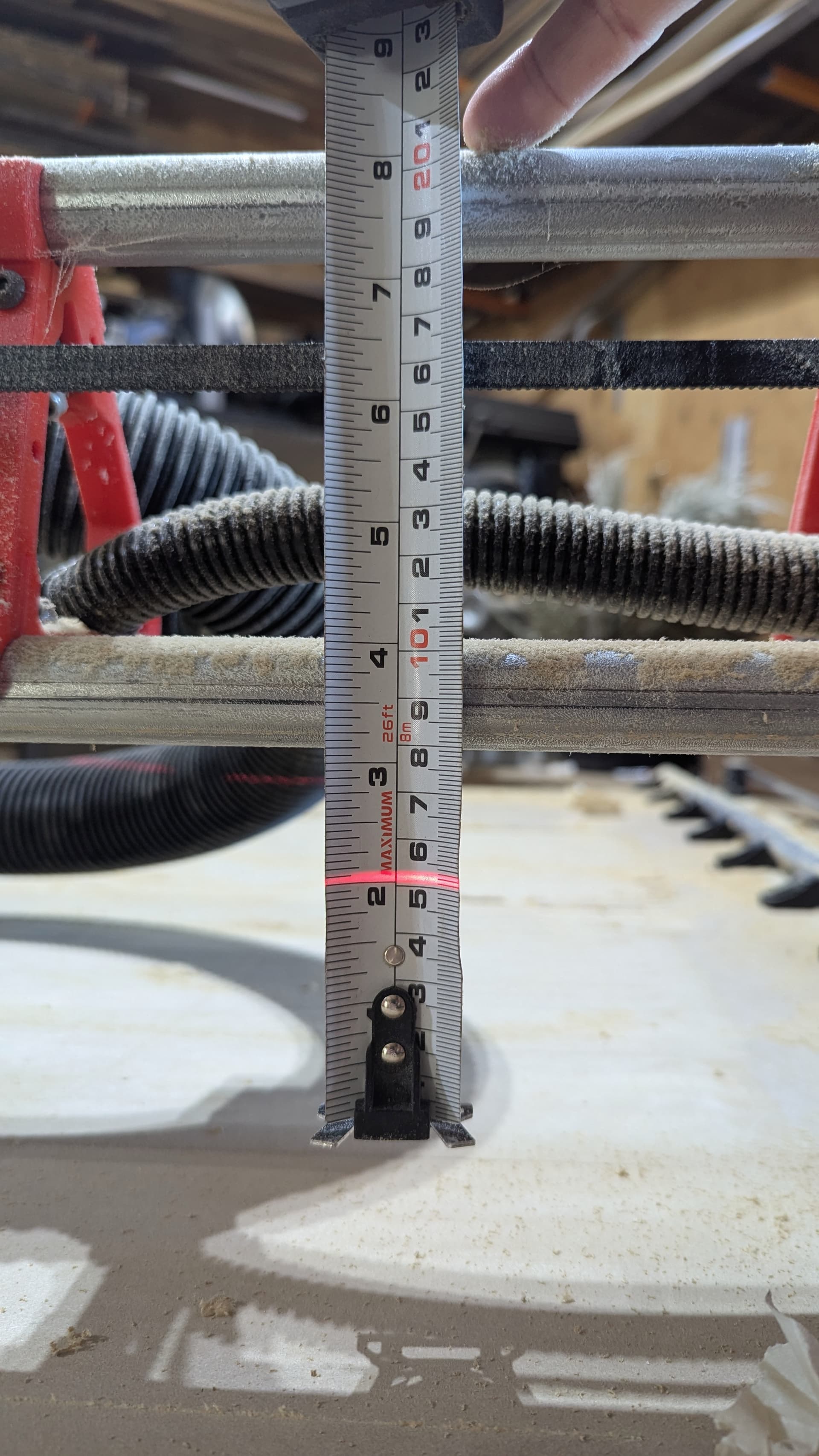

Here are some laser level measurements for Xmin and Xmax at Ymin and Ymax. When I put the Z down about 40mm, the left Z was way lower than the right Z. Even when the homing Z was almost bang on.

Looking at your pictures, I see that there is a TON of built up sawdust on the parts. My guess would be that the linear rails are completely clogged, preventing at least one side of the Z axis from moving the full travel distance.
A thorough cleaning is probably in order, involving vacuuming or blowing out all of the debris, disassembling the machine to separate the gantry from the XZ plates (three screws on each end), fully cleaning the linear rail bearings with isopropyl alcohol (IPA) or WD40, then lubricating those bearings with a light machine oil. This will also probably require you to disconnect the lead screw (threaded rod) from the stepper motor and remove it from the brass nut so you can move the linear rail block up and down to ensure it travels freely the entire distance.
While you have it disassembled, you should probably also lubricate the lead screw with a light grease. Don’t forget to use thread locker (loctite) on the grub screws when reassembling.
Another thing to check is to ensure that the vacuum hose isn’t binding or pulling on the gantry somehow. You mentioned that the issue started after installing the vacuum hose, so that may be the source of the problem.
