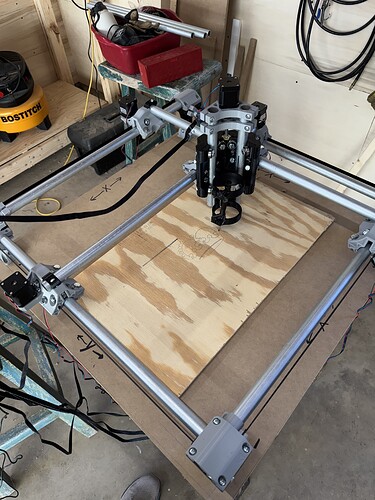

A couple images of my machine together. I ran the crown test and it traced it great! Now I’m working back towards the engraving file I started with and I did a dry run with no router.
It’s moving in all directions at what seems like a much more normal speed except for the z axis in negative. It’s still better than it was but much slower that every other directional “cutting” move. Is this normal to control depth changes better?
When you jog the machine around does the Z move down when the number gets smaller or up? If its going up that is an easy fix. power down your board and unplug the motor connector, flip it 180° and plug it back in. Now the motor should turn the correct way.
It is normal for Z “down” to be prgrammed to move more slowly as it plunges or ramps the bit into the material. On the MPCNC Z also moves via a leadscrew rather than on a belt, so that also is normally a slower action. The faster a stepper tries to spin, the lower torque it can provide, so going slow helps to prevent losing steps and therefore positional (in this case depth) accuracy.
I really appreciate all the people stopping in and offering advice. I’m just beginning but I’m super excited for all the ways I can start using my MPCNC. I ran a test cut of my buddies logo in foam and it came out really nice
But there was definitely some slight chatter in the x axis in both directions, is that a sign I need to tighten or have over tightened something?
with the spindle off and the Primo on, move it to the middle of your work area. lightly grab the bit and try to move it left/right & front/back. If you get a rocking there you need to see if its coming from the Z tubes in the core, or from the core to the X / Y tubes. Or all 3. Once you figure out where its coming from very slowly start tightening up the adjustments until the rocking is gone. go VERY slow with this. 1/16-1/8 turn at a time. Its very easy to over do it. You want it just enough to get rid of the rocking. You may have to adjust this after each job for a little while as the bolts set into the plastic. its something you should check often after that as well.
