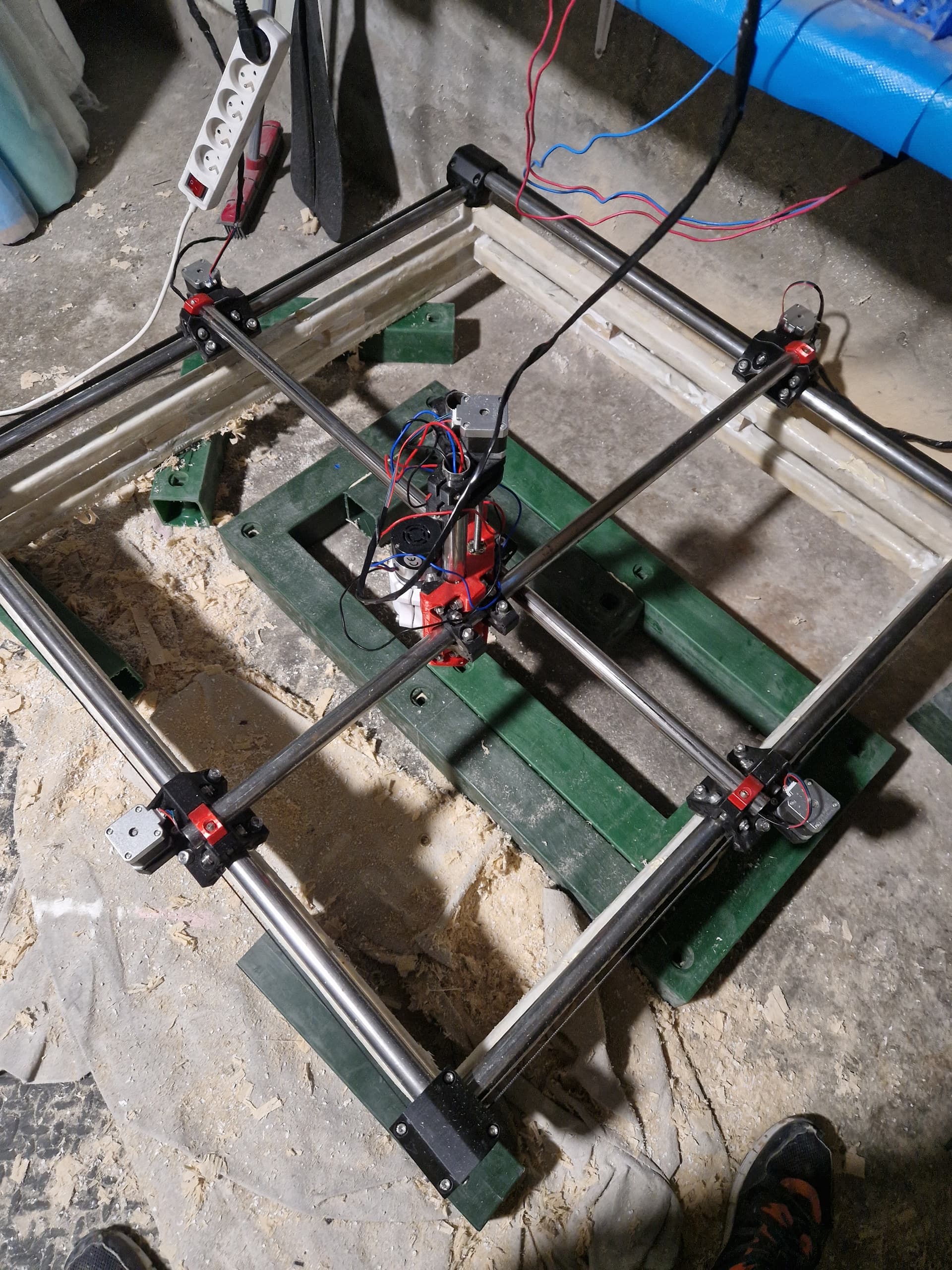

Axis per steps OK, I changed the 2 A4988 stepper drivers, redo the VRef for all the steppers drivers, plus removed the Y2 invert Y option, and it seems to run good now.
TODO :
  • new 52mm Spindle Tool Mount (I can’t the basic one clamped into it)
  • make some cable management on top of the Z-Axis
  • make a first part test !

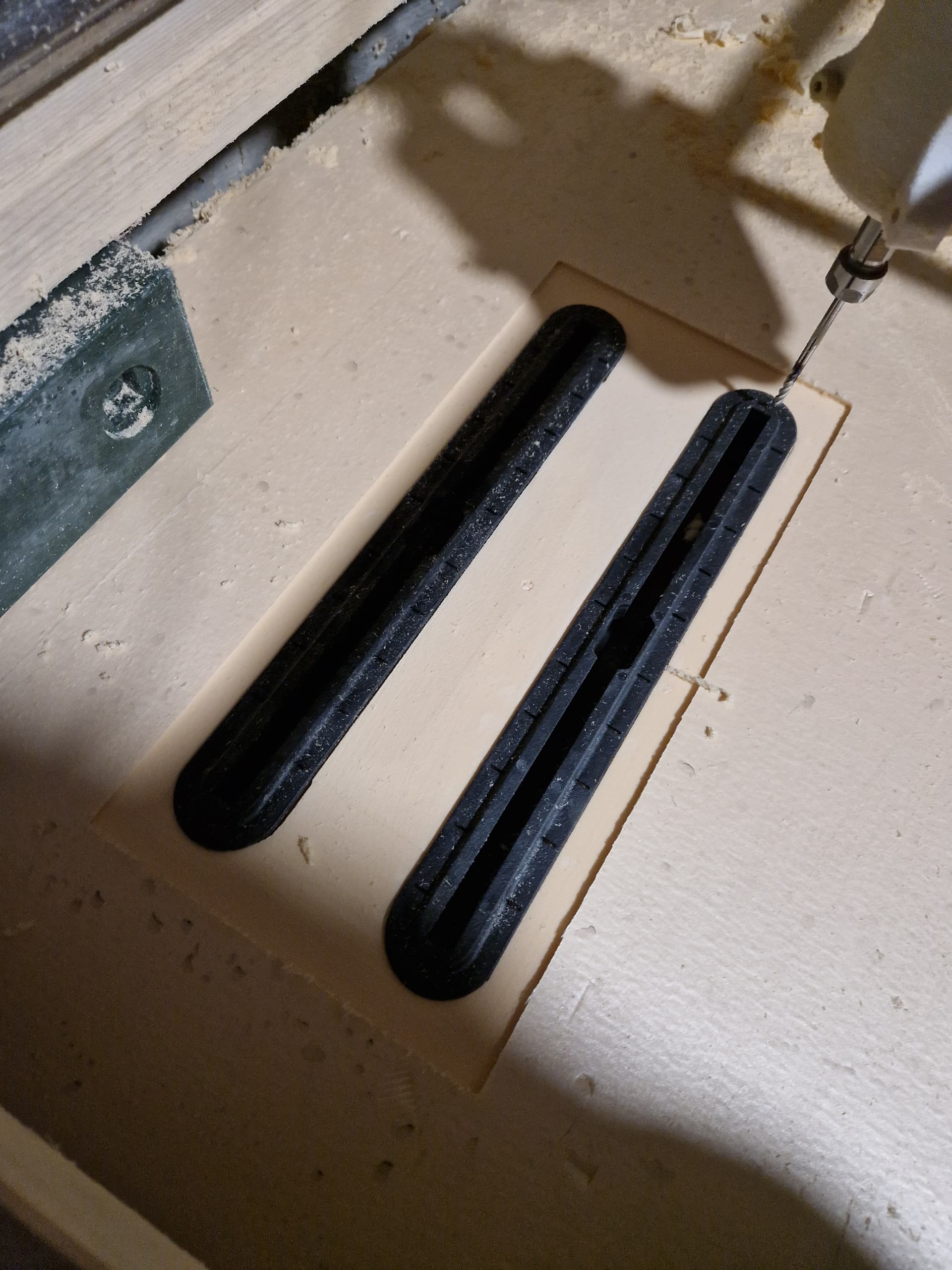

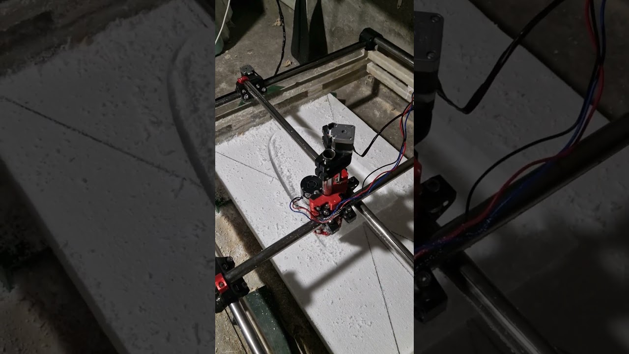

First test with the router on Polystyrene :
Result : Perfect .
Super happy with the result.
I will also do my Christmas Present with it :smiley:
Need to upgrade the cable management (I will use regular Drag Chains), find a better 52mm Spindle Tool Mount and tidy up a bit the power supply.
Also I can probably go higher than 50, 50, 30 mm / min on Polystyrene like this. Also I will upgrade the router bit for a longer one.
Thank you again to all the community and special thanks to @vicious1 !

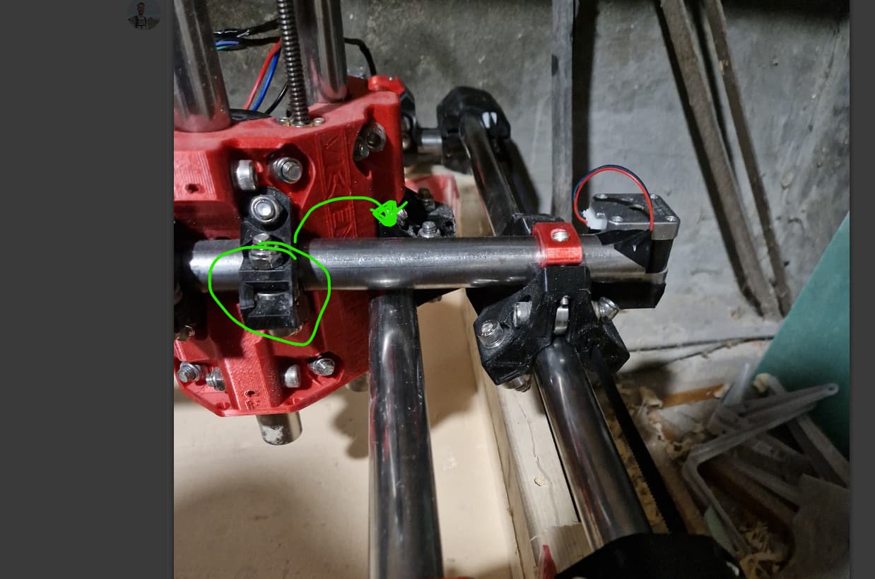

I still have a question / problem though :

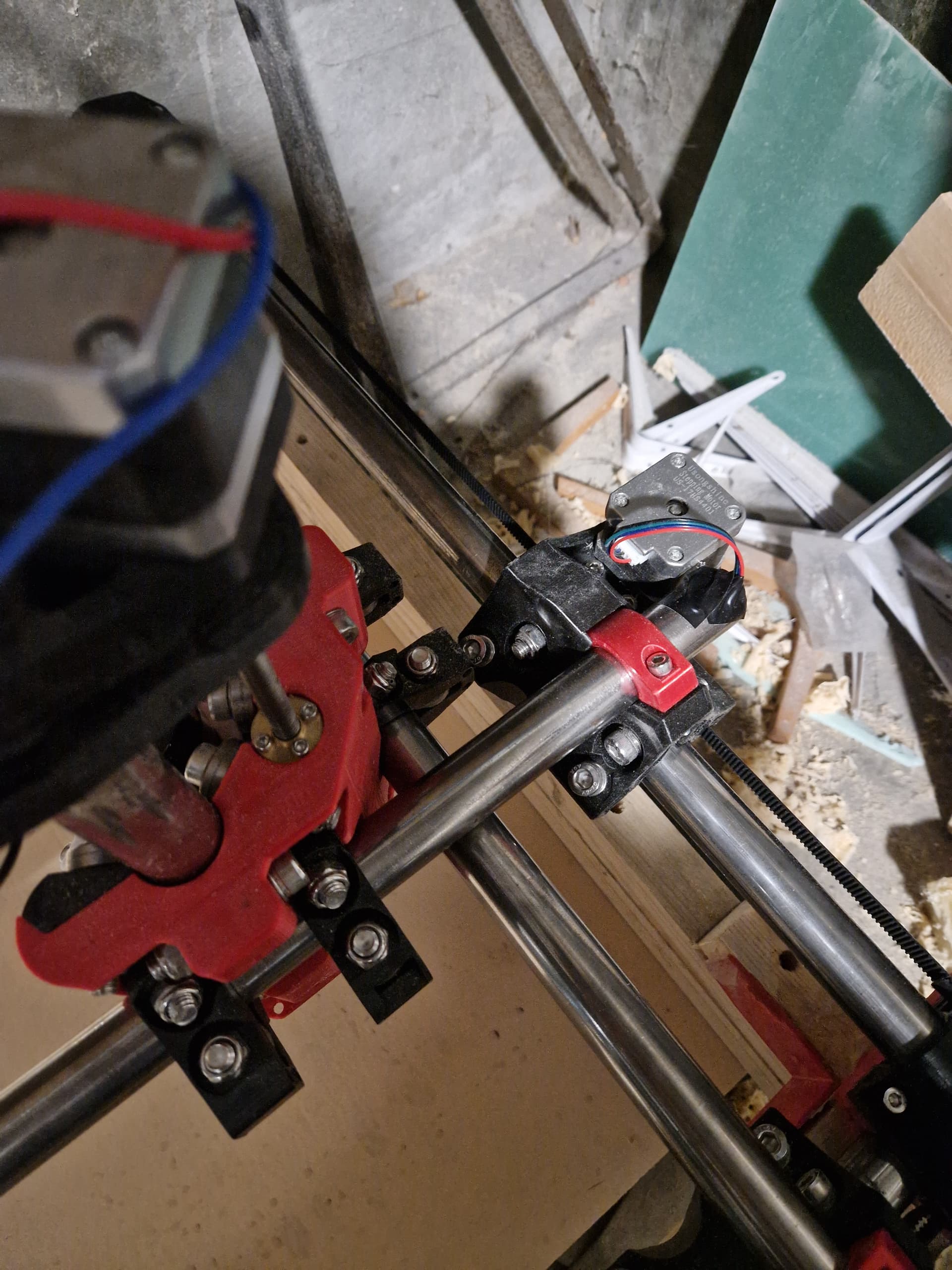

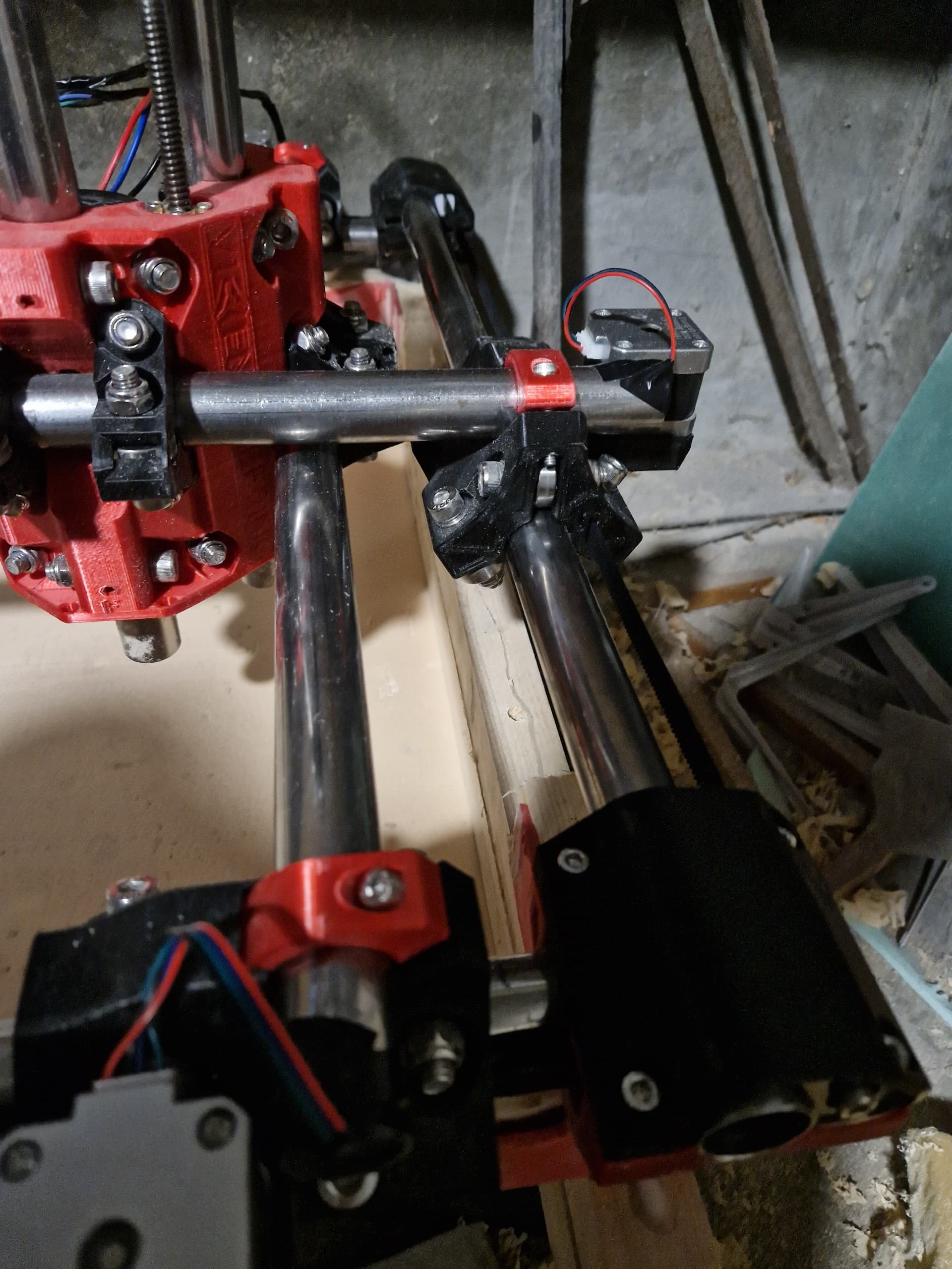

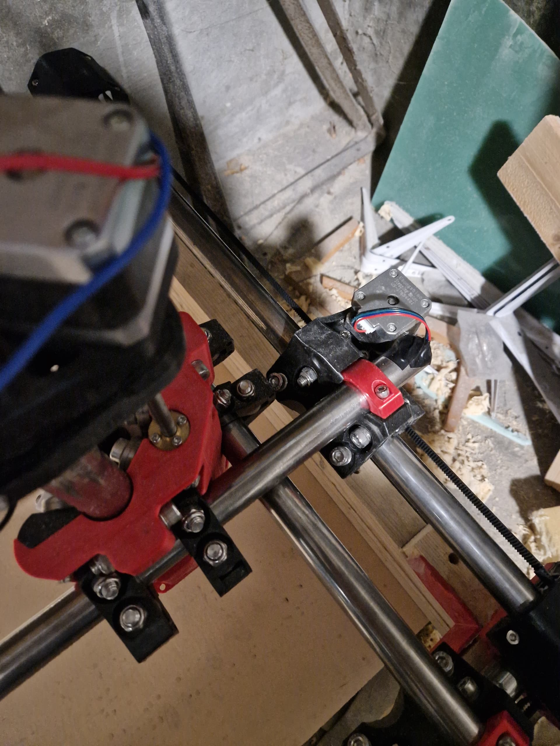

The Core is not going all the way on the Y axis, because it’s blocking on the screw of the trucks.
I should probably gain ~2cm on the Y axis. Do you know what’s wrong on my setup ?

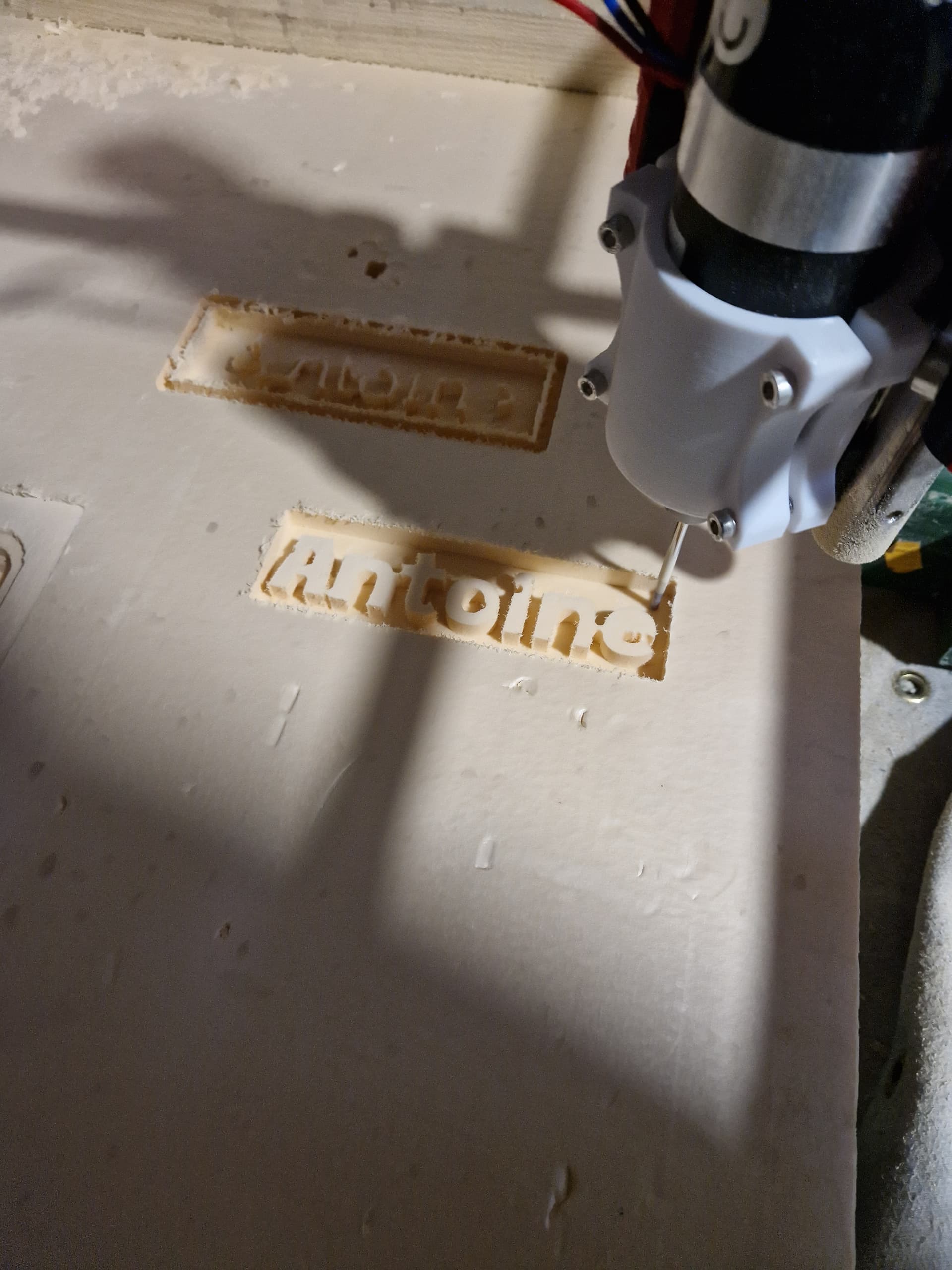

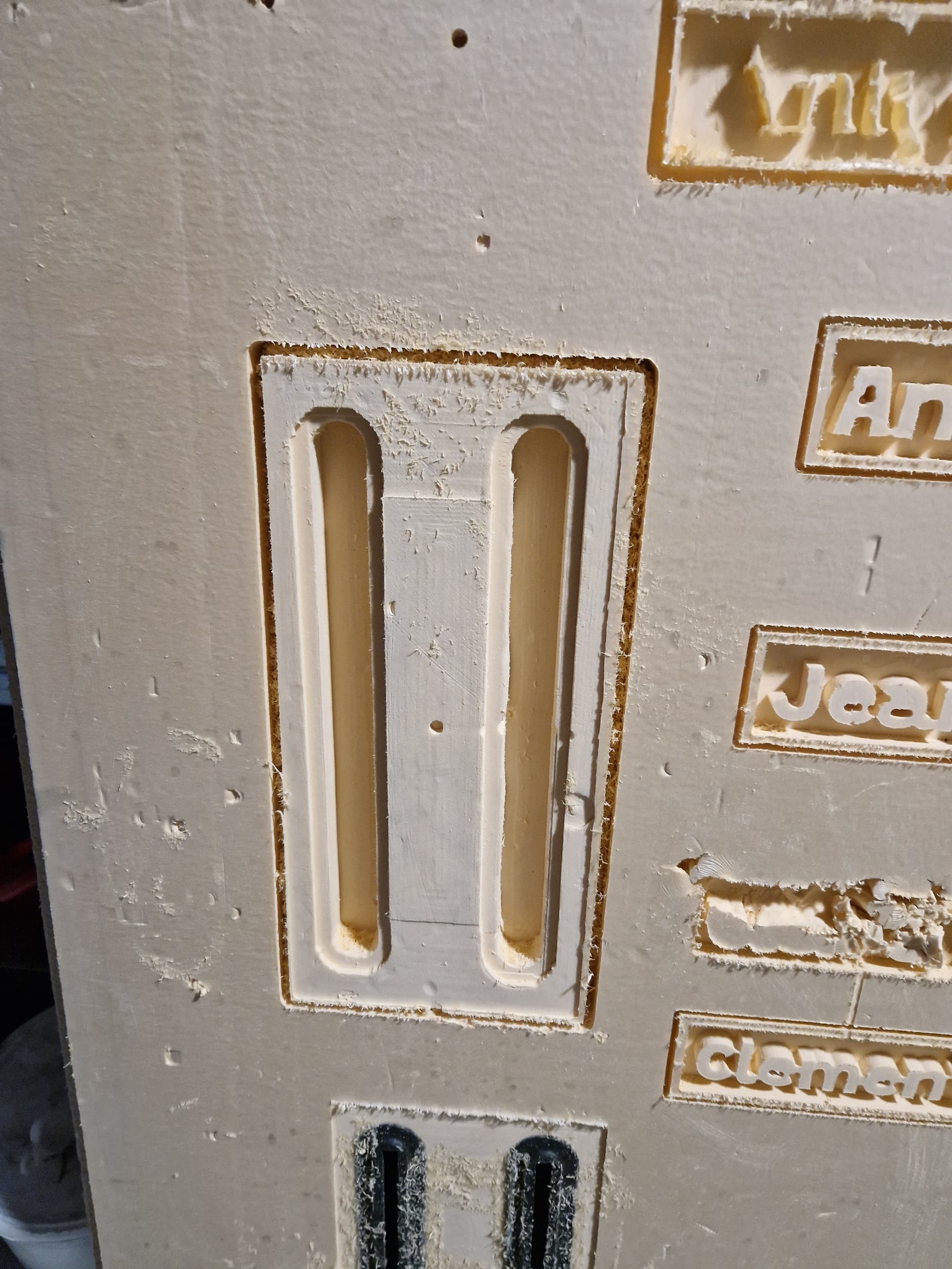

Some new happy results :
Your core clamp is in the wrong spot.
Thank you, I gained probably ~2cm on the Y axis.

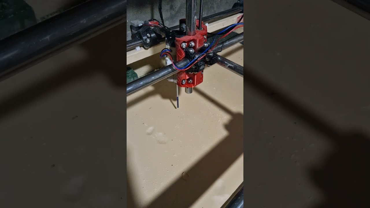

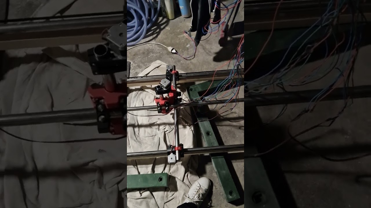

But when I run a gcode file from the SD card (I tried very simple / minimal gcode), it seems to run ~5 or 10 times slower than 50mm/s as you can see on this video :
But the MANUAL_FEEDRATE is OK cause when I run + / - X / Y axis from the menu, it moves around 50mm/s which is the right one.
Am I missing something for the feedrate when running from gcode file ?
An example of gcode from BlenderCAM (which is basically only G commands, I don’t see anything related to the feedrate) :
Boitier Antoine.gcode (615.9 KB)

Found the issue for the feedrate. In the gcode from BlenderCAM :
G01Y-45F500
or
G00Y-45F500
The F500 set the feedrate to 5mm/sec .
Let’s go back to testing the motor, but now at good speed, let’s say ~25mm / sec.
The feedrate is good now.

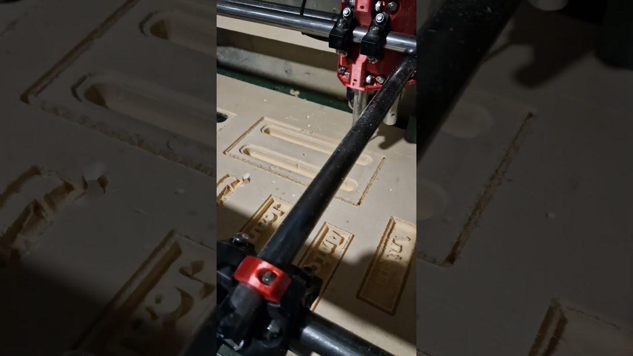

I run a first test :
I will be more meticulous on the positioning of the MPCNC on the blocks, but otherwise, I’m super happy with the result.

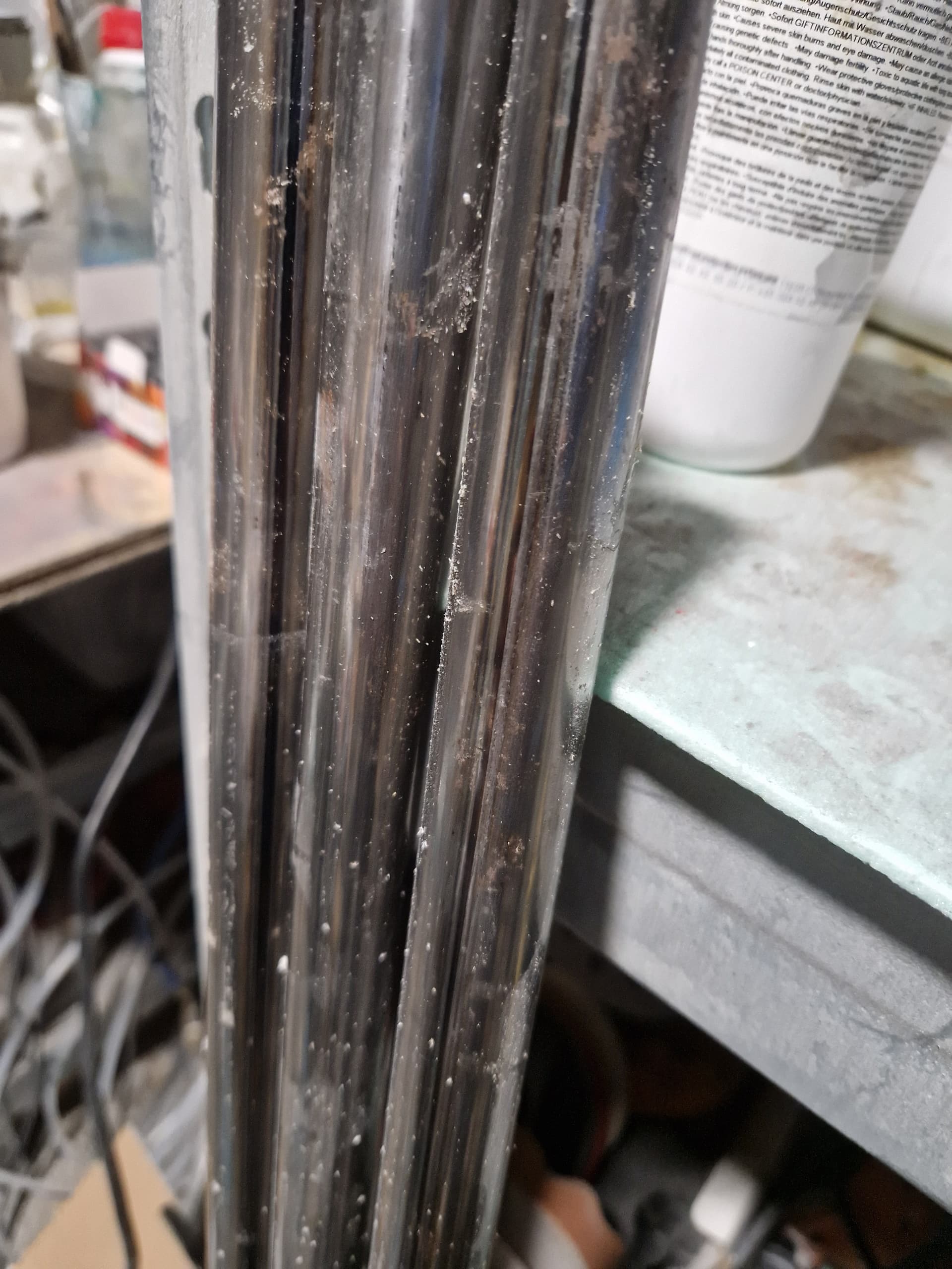

First, I noticed checking the trucks that some screws are too tight, so the trucks were not moving at ~45 degress, but more around 75-80 degrees. Also they left some used marks because of too tighten on my rails as you can see on this picture :
I think this is one of my biggest previous problem.

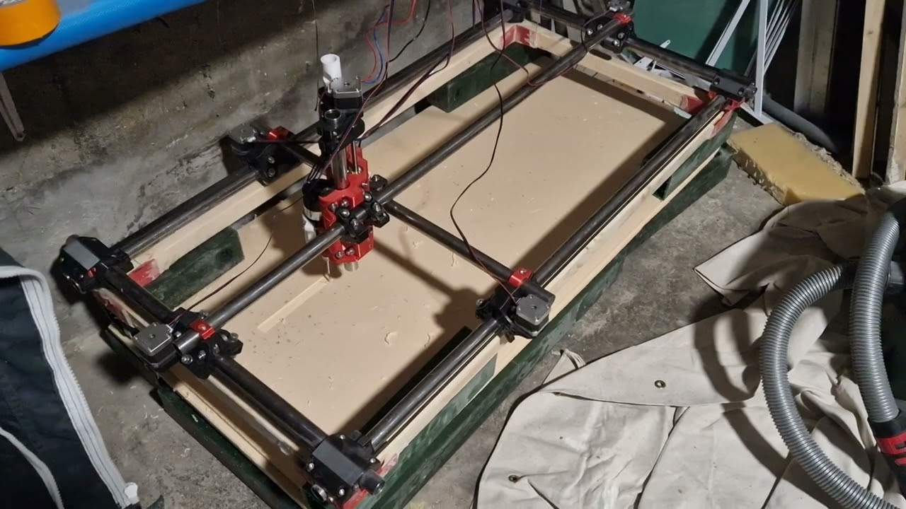

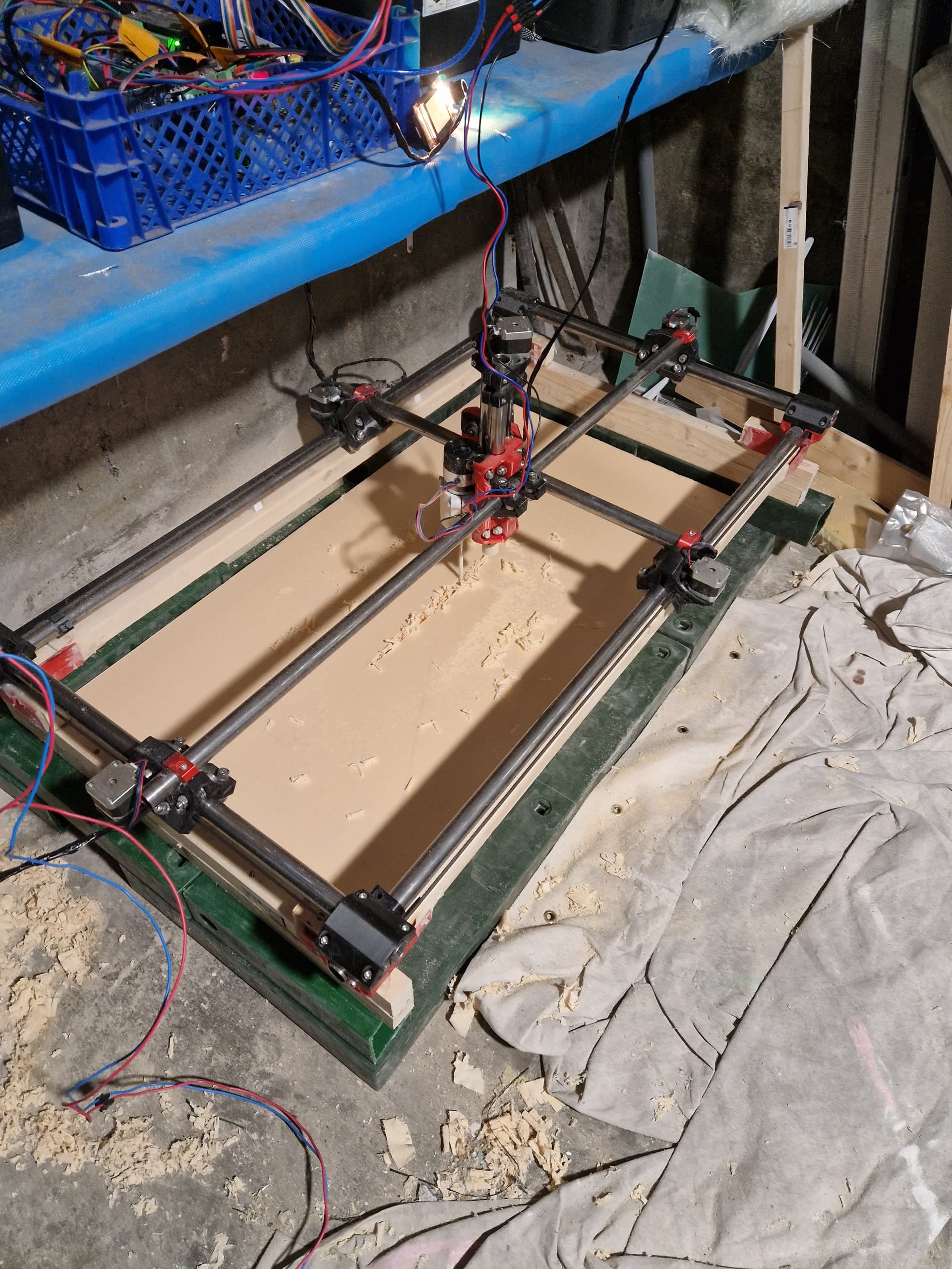

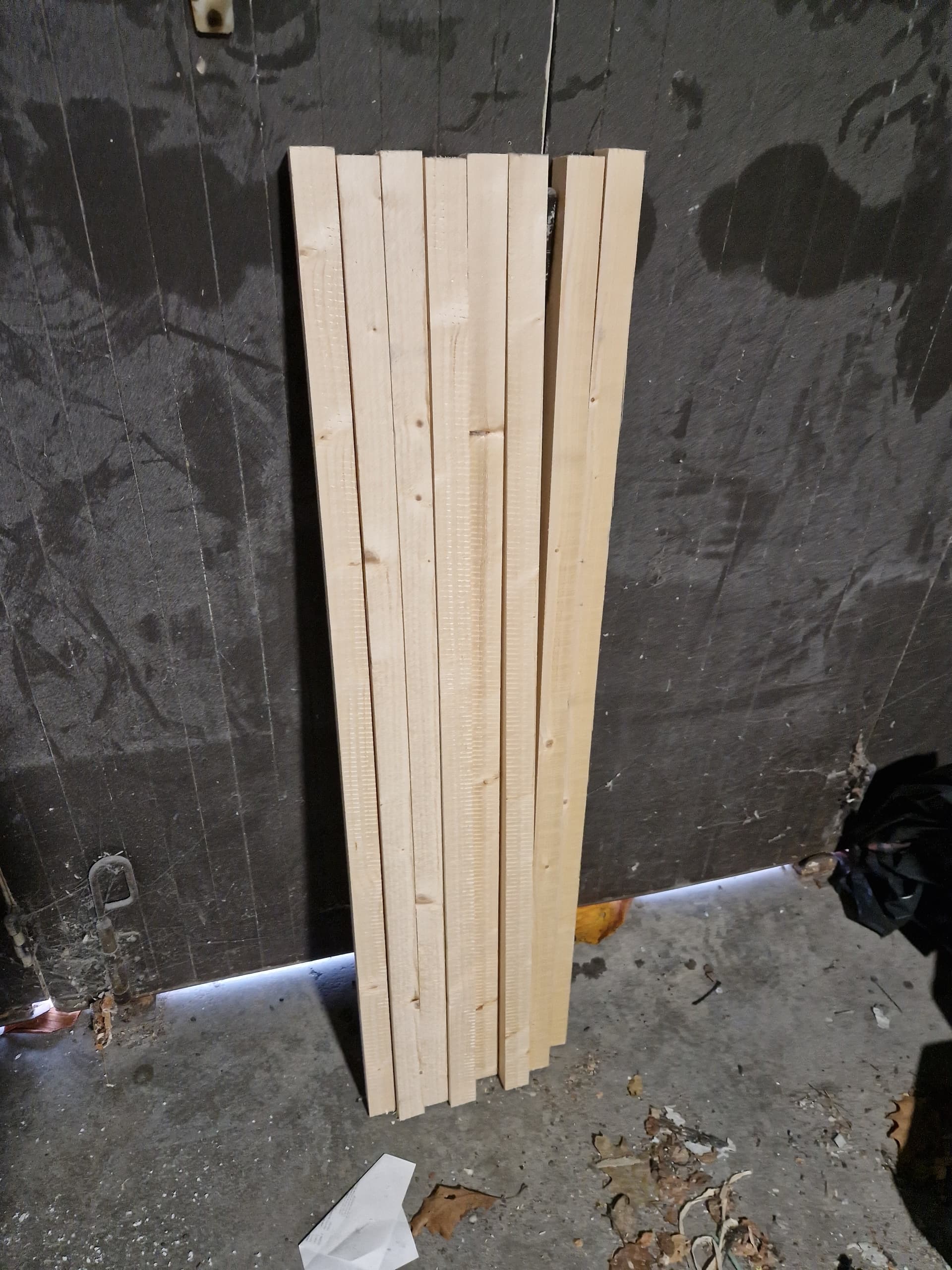

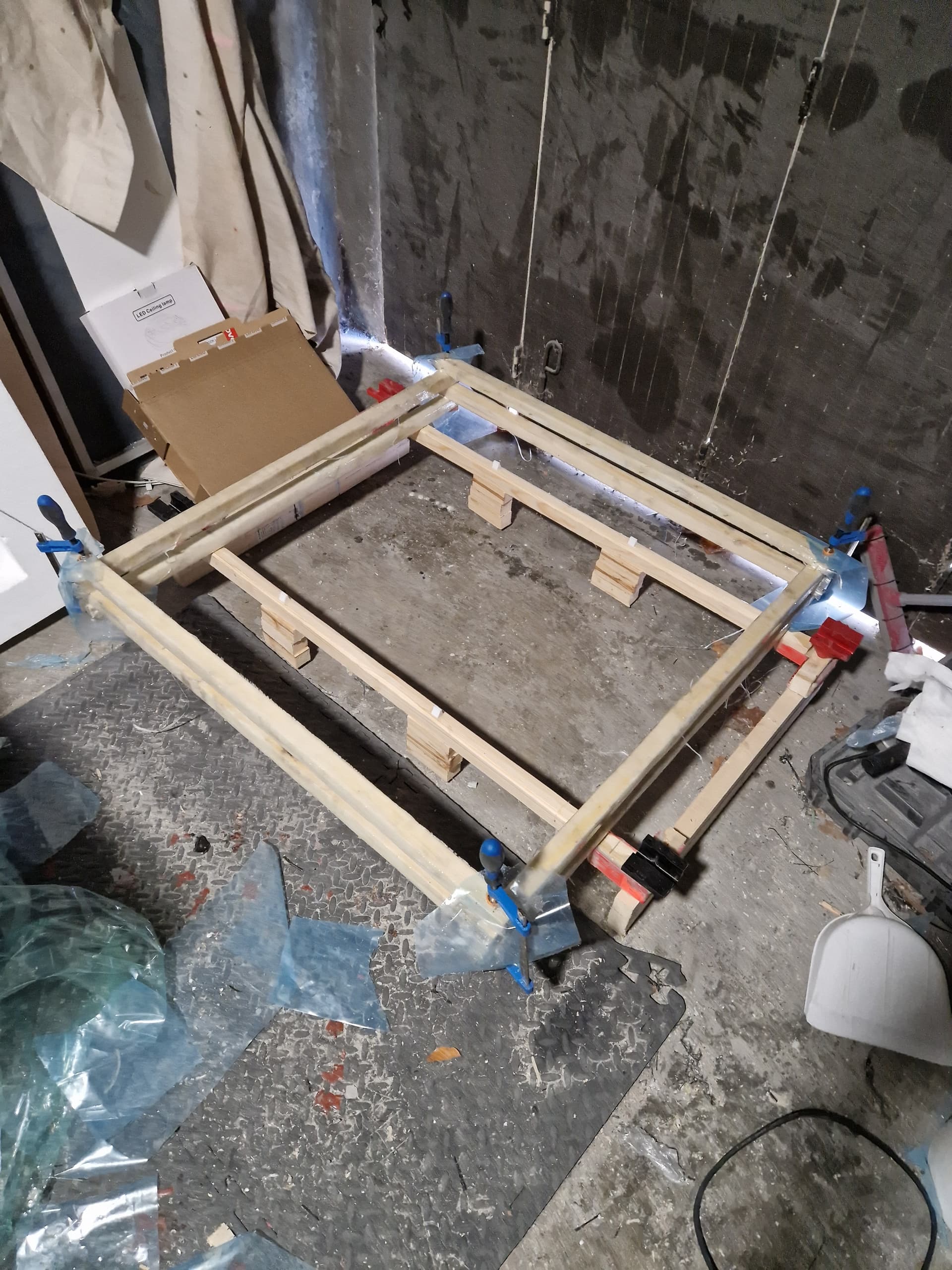

I’m redoing the “table” CNC with a machining area of ~65x65cm which should be enough for my Polystyrene Block (I will move it twice more, but hope to be more precise). I calculated that the rails + table needs to be 1mx1m.
The table is composed of bracket of wood of 32mmx32mm, I place 2 per side, and I added some fiber glasses + epoxy resin in order to have much less bending possible. I will also add some bracket parts between the 2 in order to solidify even more the structure (no bending possible whatsoever).
I will add 4 supports per axis.
Re-assembled everything with the new frame. New dimension : X 705mm Y 730mm machining area.
First, the trucks glides much better.
For the final Squaring I noticed I have ~1 to 2 mm difference on the Y axis. This is acceptable.

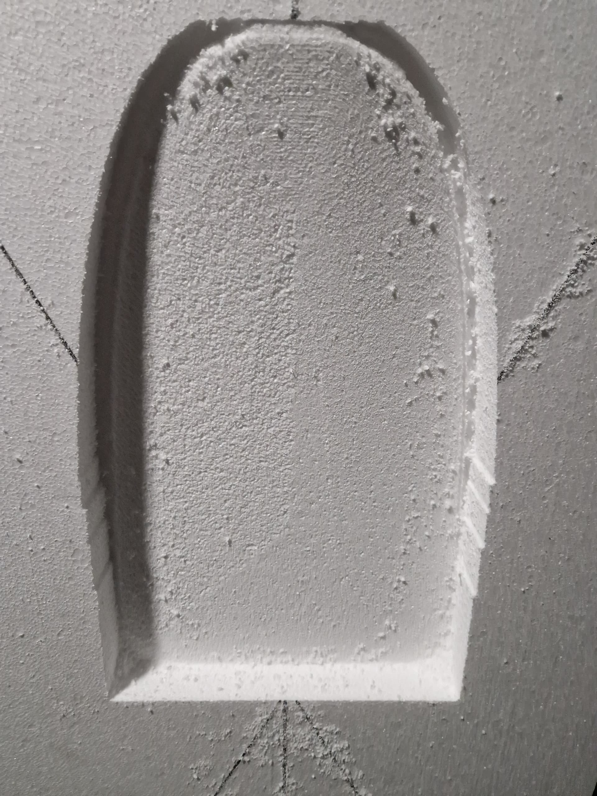

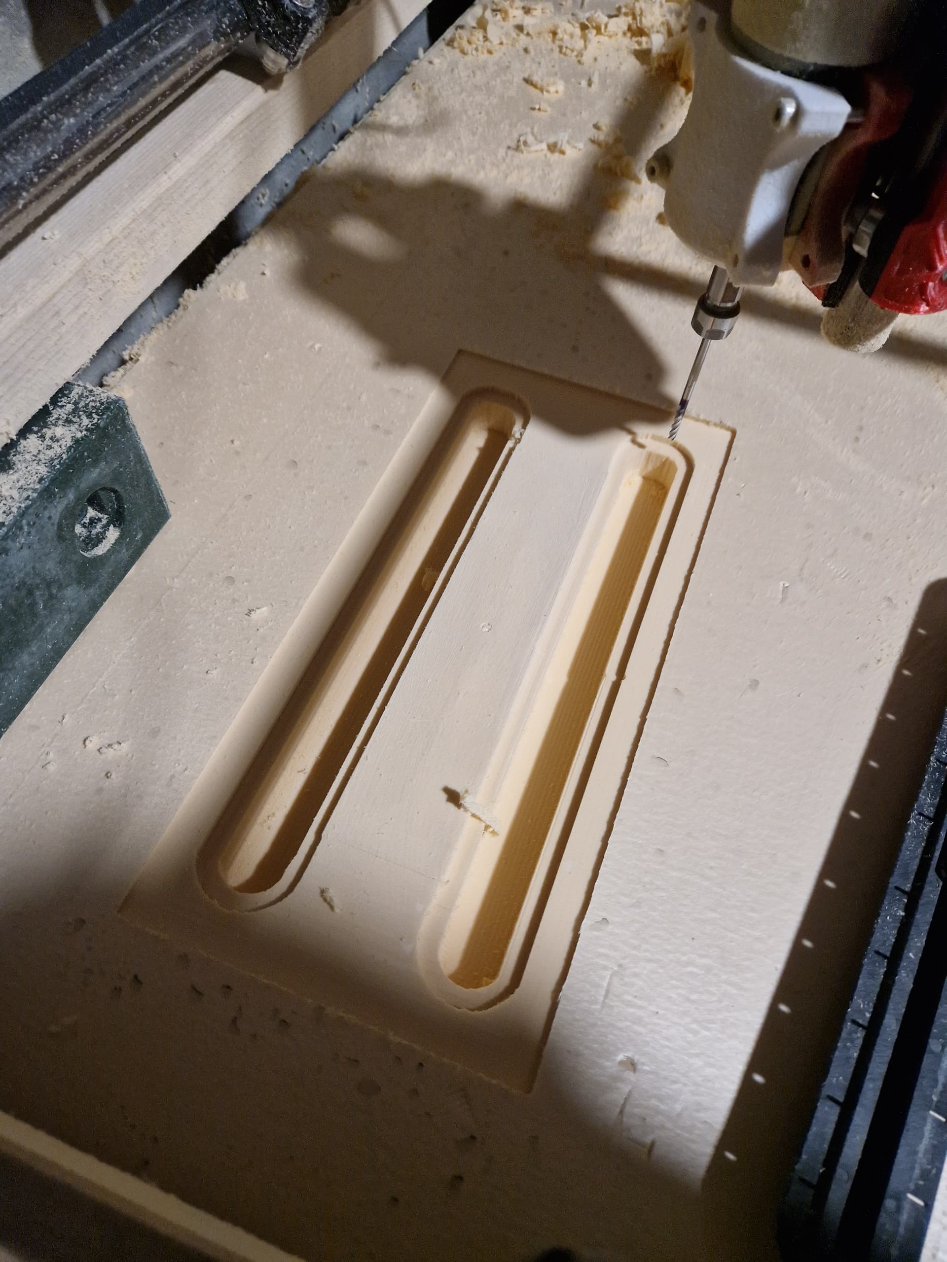

Result :
Me :
Happy
Soon others results.
