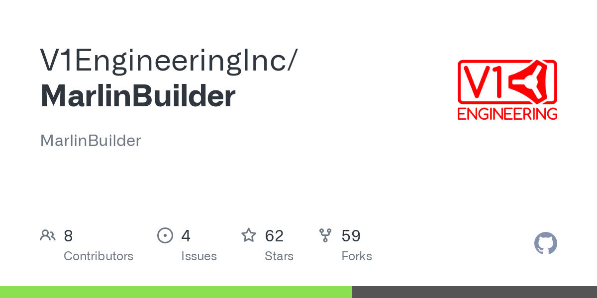

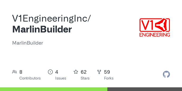

So to build & send Marlin Firmware to the MKS GEN L V1.0, I will use MarlinBuilder from V1EngineeringInc.
But I need to tweak some settings for my particular setup :
  • Add the TFT mini 12864 (will it read the SD card ? or should I add a particular setting in Marlin to add the SD Card support ?)
  • Re-use the default MPCNC settings

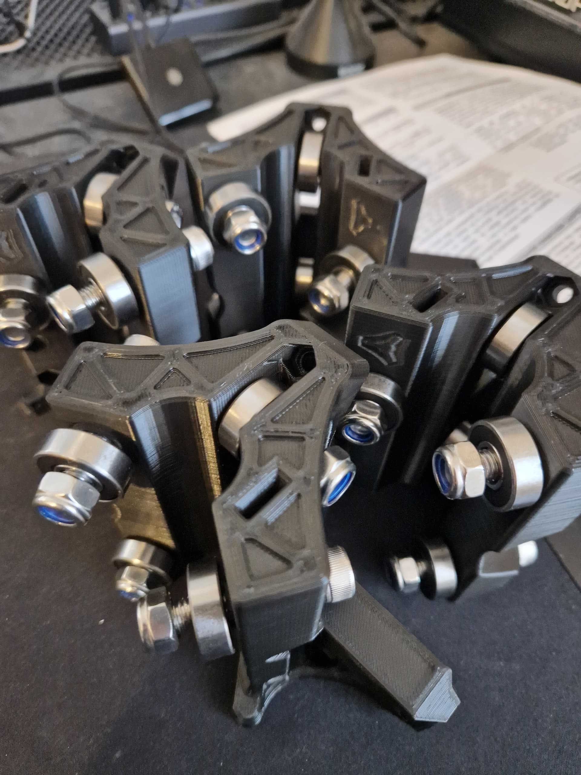

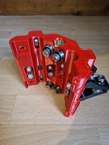

And started to mount the Trucks :

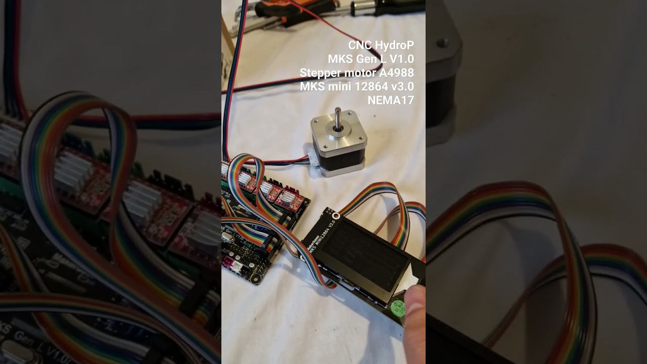

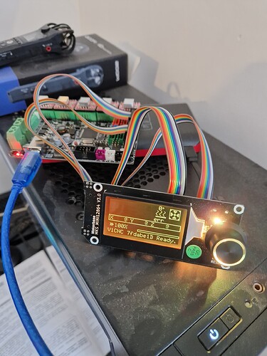

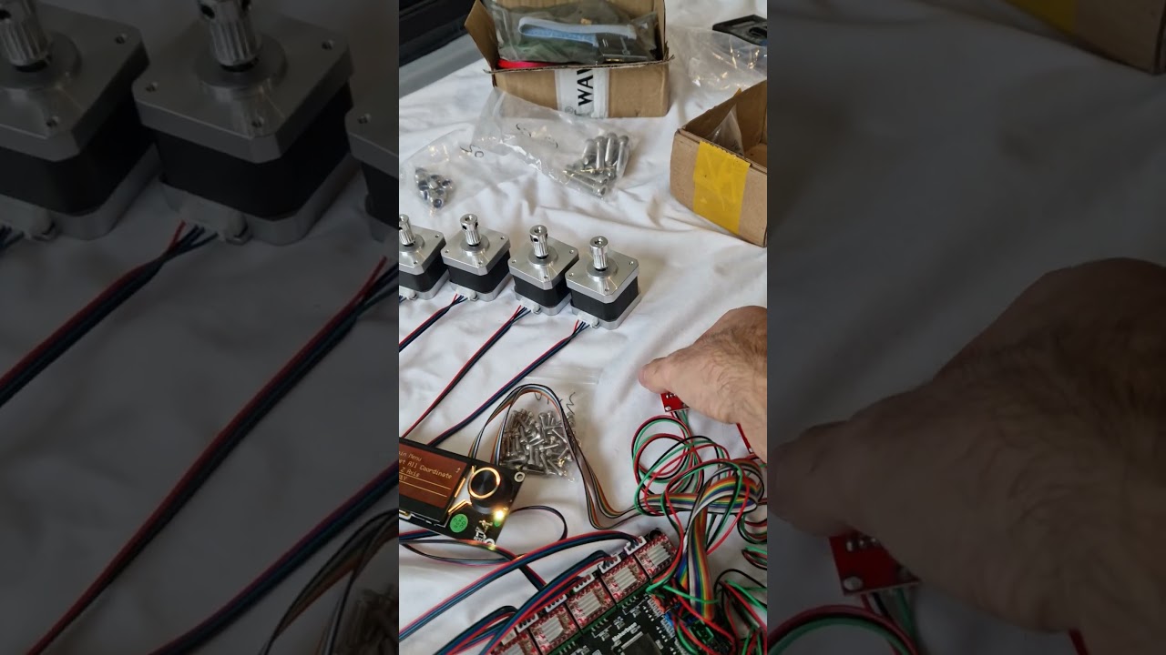

I’ve tested the MKS GEN L V1.0, set the Vref for the A4988, the MKS mini 12864, the NEMAs… It’s alive !
I have couple of things to tweak :
  • Backlight is not working on the mini 12864
  • I will test with a SD Card inside if it reads gcode

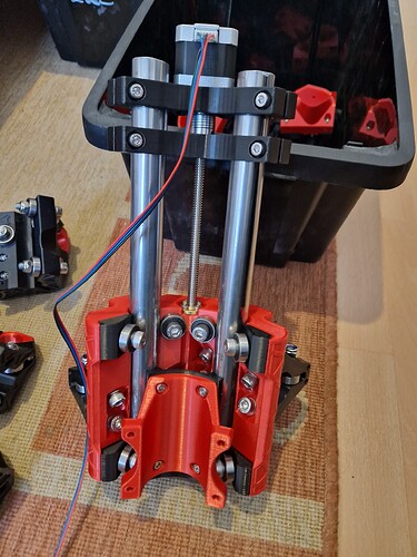

I continued to assemble the Core MPCNC.
All good for the backlight + SD Card reader.

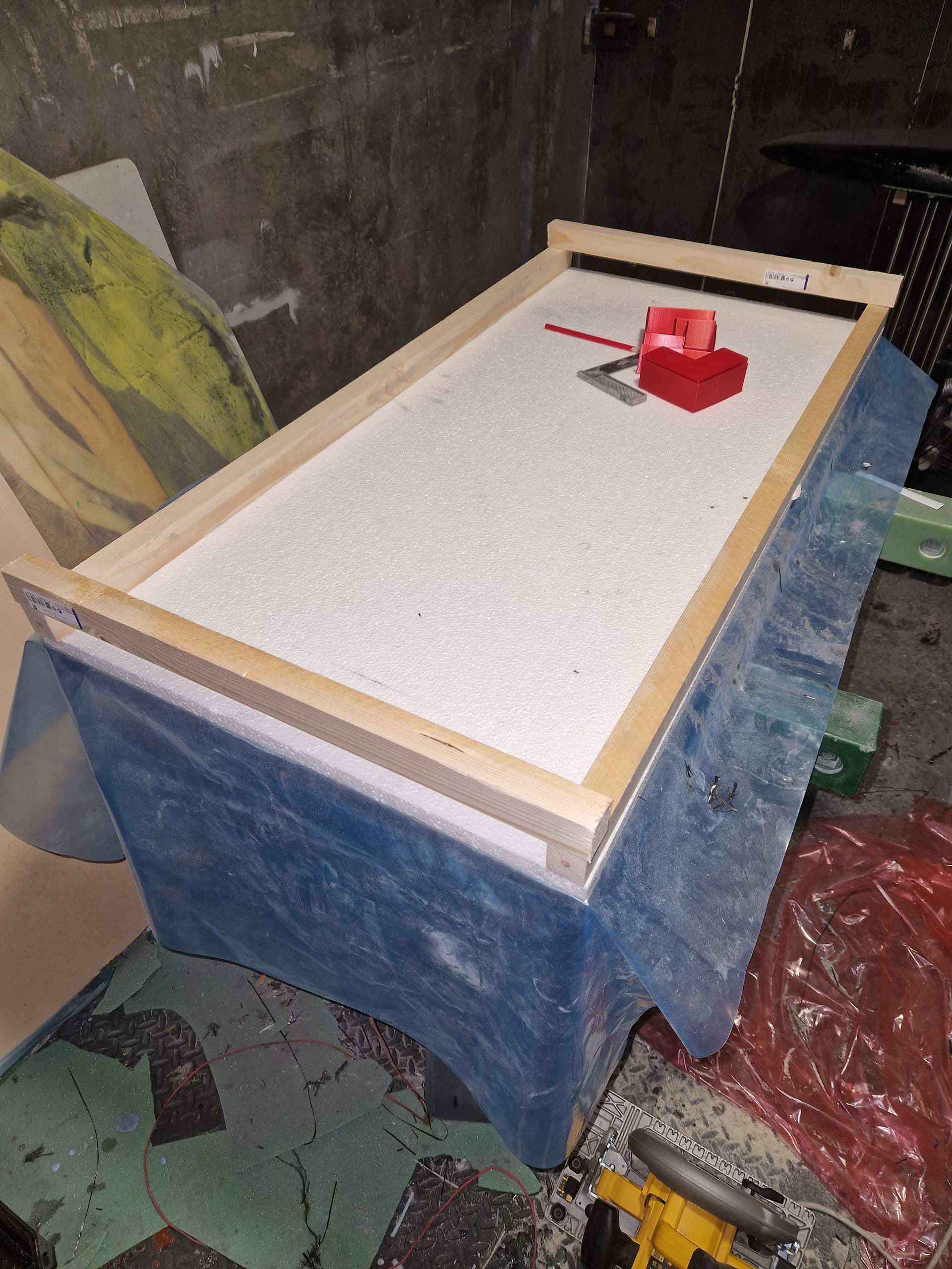

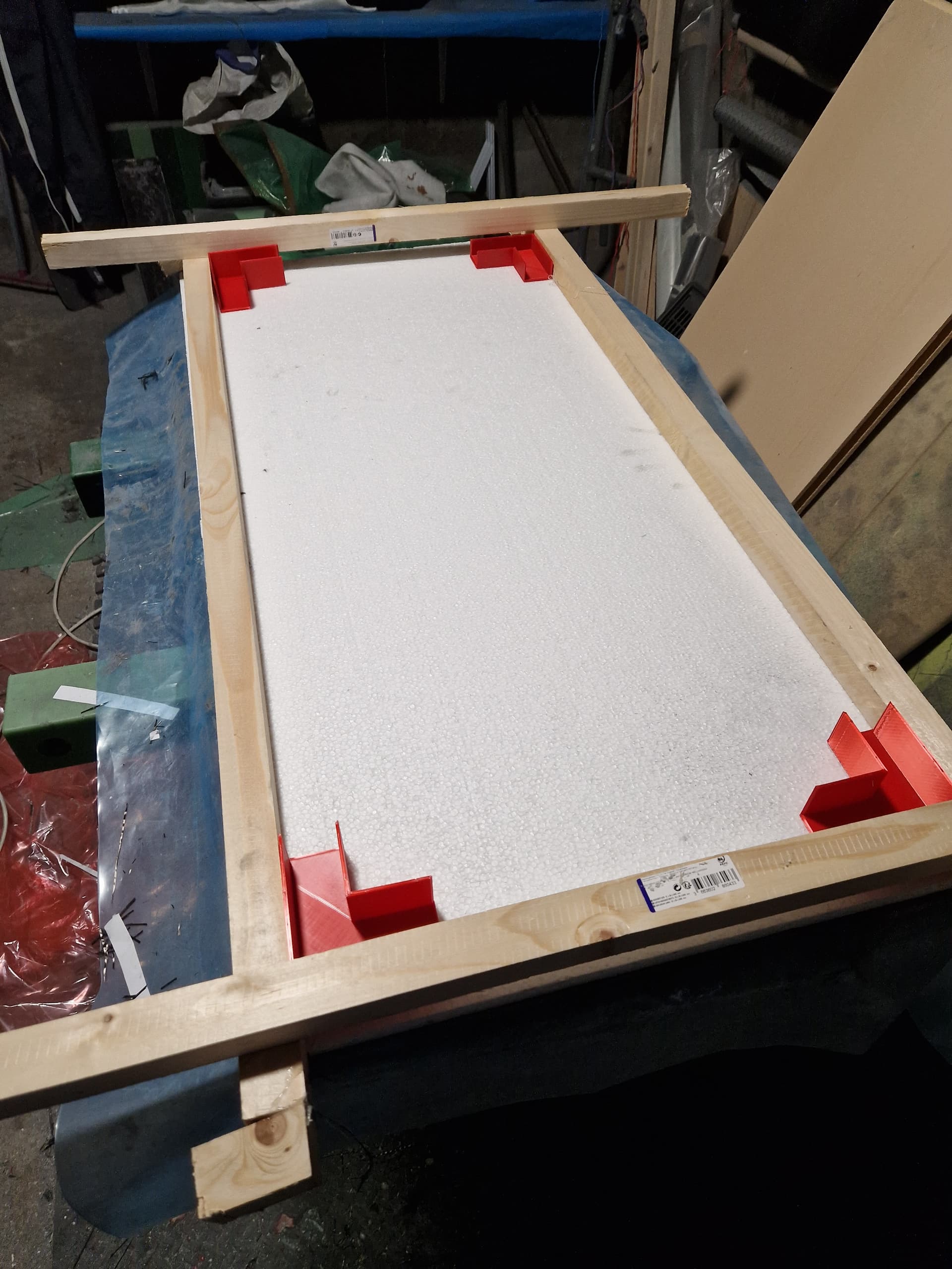

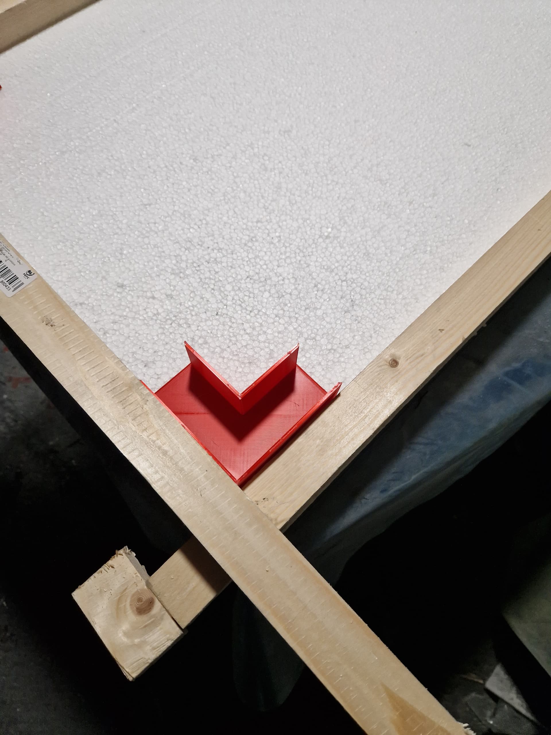

About the table, I started the cut around the smallest Polystyrene block I have (which will be the final dimensions).
I will screw + glue (epoxy) the bracket into the 3d printed corners (red part) that are perfectly squared.

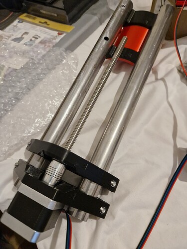

Z Core mounted with the 52mm spindle mount.
All core - Z mounted. I need just to add lubricant on the leadscrew. Everything is looking good so far.

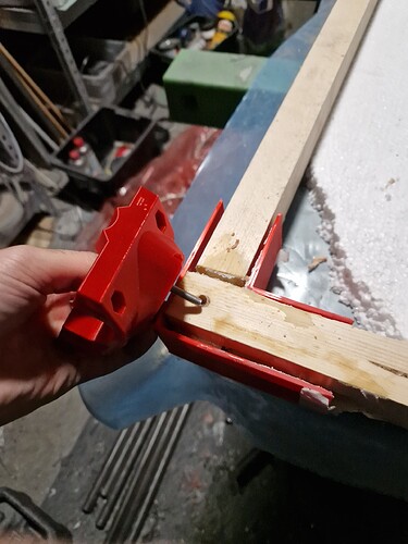

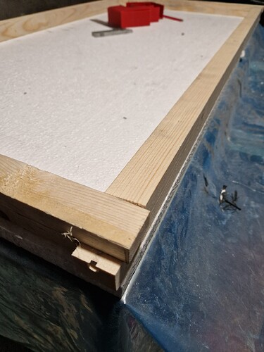

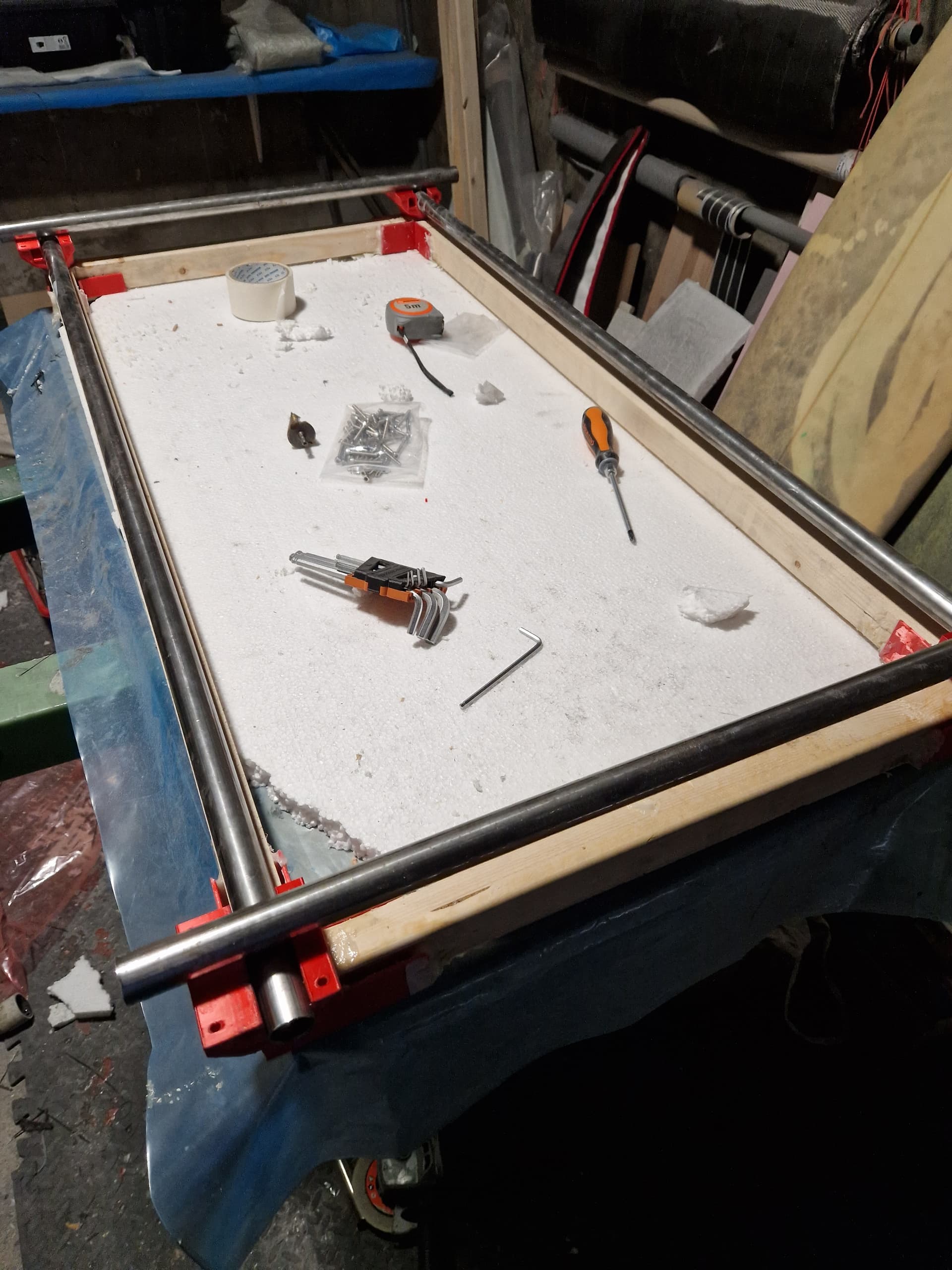

I consolidate my frame with a 3d printed corner and filled it with epoxy.
Then I epoxy the corner screw directly to the frame (no base). I squared it as much as I could.
My goal is to be <1mm precise everywhere.
This should be strong enough ?

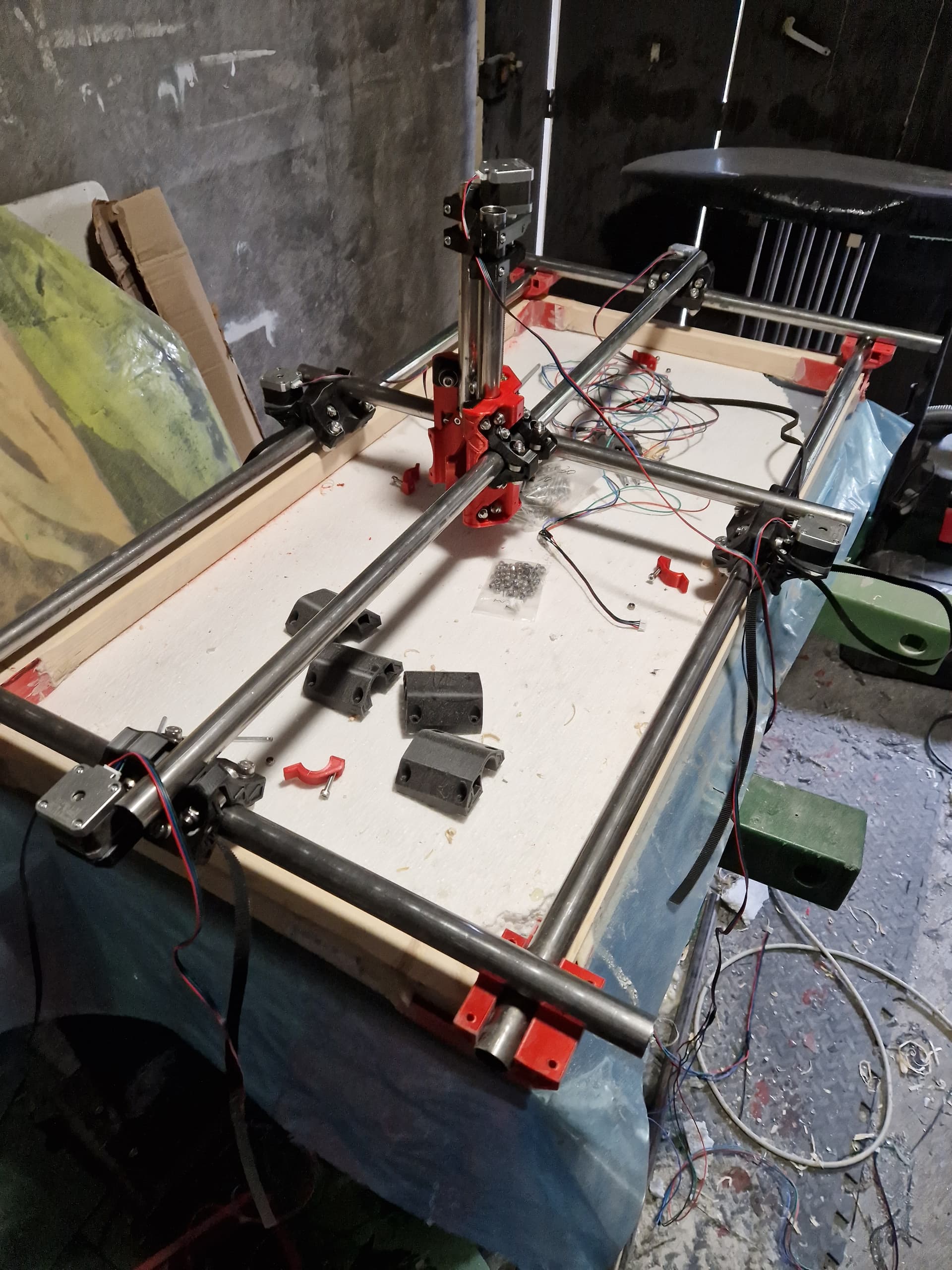

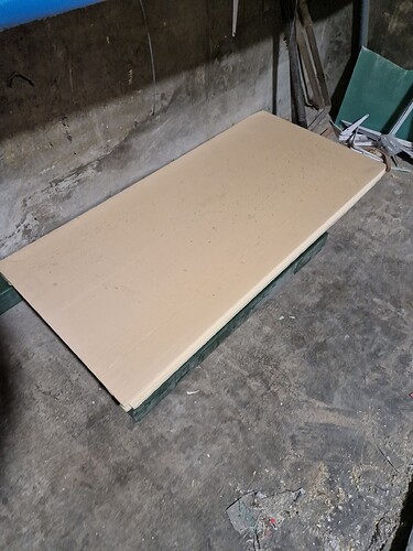

The table will take place onto my Polystyrene blocks here :
I need to extend all cable and make some cable management logic in order to use the MPCNC.
I was assembling everything, it went pretty ok, until I found out I inverted 2 corners bottom on one side (found out looking at the belt attacher…).
I am reprinting the 2 corners bottom as I needed to destroy them to remove them.
What size is it? If it says above, i apologize. I looks wide and narrow.
My polystyrene block is 1200 x 600mm so working area should be something like ~1100 x 500mm.
It’s alive !
Couple of things to tweak / fix :
  • microstepping / calibrating the axis (should I remove the microsteps in order to have more torque ?)
    • The X and Y Axis moves 2x times too much
    • The Z Axis moves 0.5x times too little
  • squaring everything
  • check the screws tightening
  • add the endstops for homing
  • cable management
