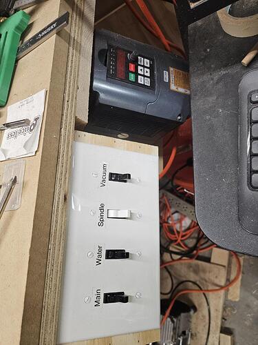

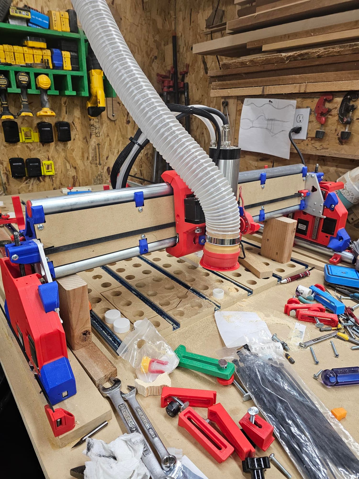

What machine are you using? A lowrider? Where you have your vfd licated: at the x axis beam? Front corner of the table?
I am using the Lowrider V4, the VFD is located just below the right front corner of my table. I have it beside my switch bank, I like to be able to see the display.
Mmm ↔ ce but i was thinking about placing mine over the x gantry. Would like to keep wiring to a minimum
