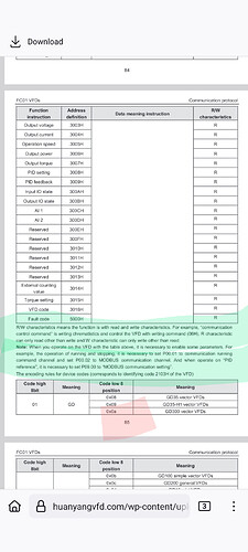

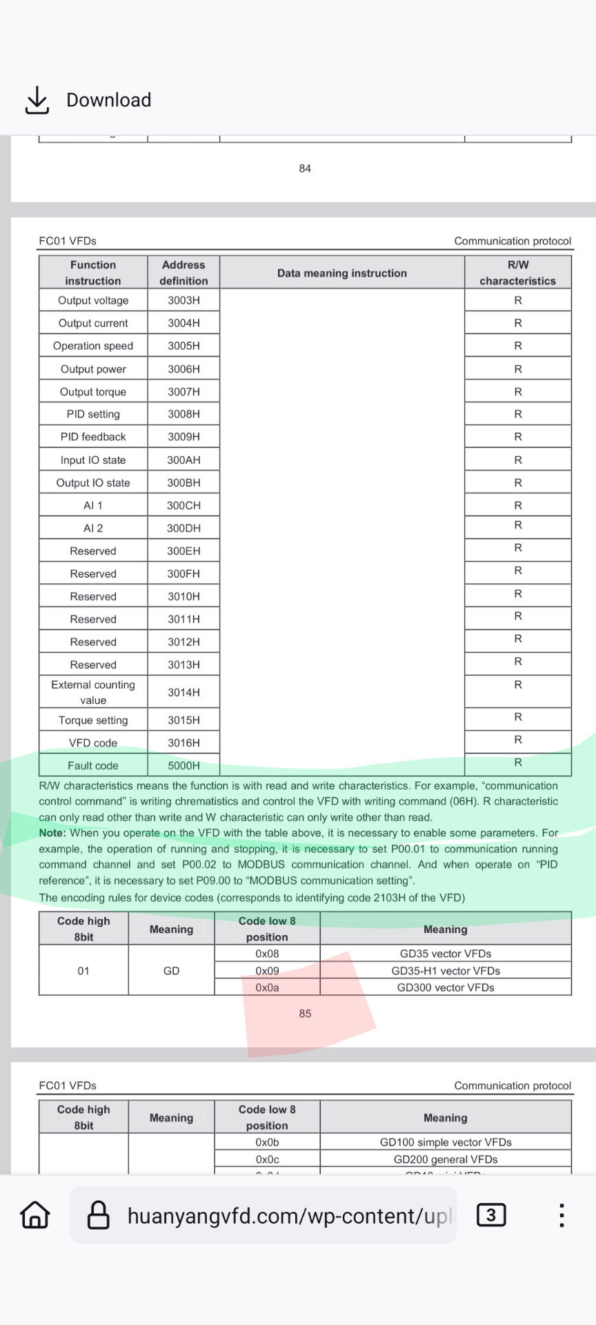

It is telling me to set P00.02 to MODBUS, my VFD does not have that register, it goes from P00.01 to P00.03

I think you need to read your manual carefully tonight. Its on page 88 of the pdf
I agree, I have read it several times.
I have made several efforts to find this setting, it is not available. The parameters go from P00.01 to P00.03, there is no P00.02.
Sorry.
In my pc it says 88 but its page 85
Cant help you anymore than point you in the right direction . I dont have that vfd at hand.
I am wondering if it is a typo in the manual, I am sure that the setting exists somewhere but that parameter does not exist on my VFD. I can take a movie to show that it simply is not there. I couldn’t be more frustrated if I tried!
I will take a look at the manual tomorrow and see if I can discover where this actually is. I am thinking it may be time to just order the correct VFD.
I am sorry if I sound short, just frustrated. I hate it when the manual and the device do not line up, how are we suppose to manage the device when the directions are faulty.
