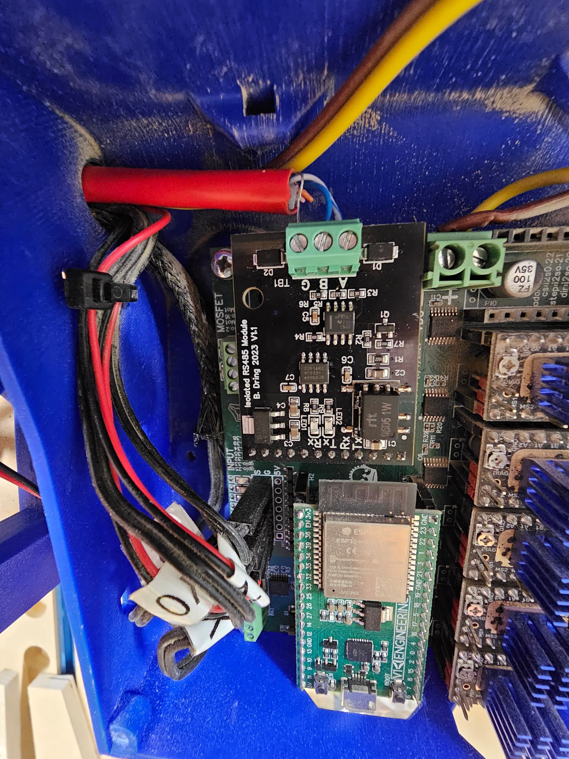

Same response, The TX LED is flashing as it should the RX LED is on solid.
GGRRrrrrrr
from the spindle section in fluidnc wiki:
LEDs
"If you have Tx and Rx LEDs at the controller side the Tx should blink a few times per second. The Rx LED should blink right after. It does so so quickly that they may appear to blink at the same time. If the Rx LED stays on, try swapping A and B at the controller end. "

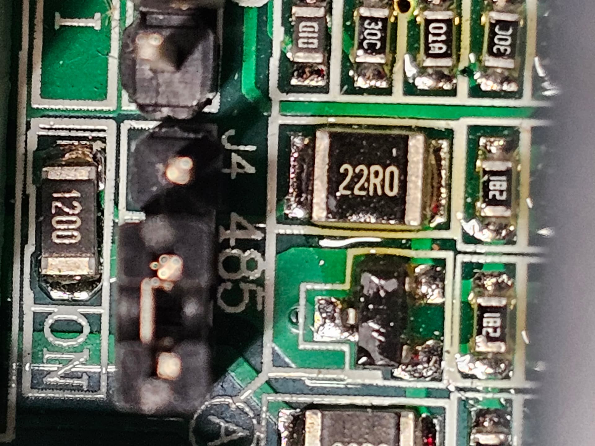

Yes sir, that is as close as I have been able to get to a victory. When I swap the wires the TX still blinks but the RX is dead. I did find a jumper on the board in the VFD that is labeled 485, I gave that a stab but it just turned the RX light off, put it back where it started and it is on constantly.
Here is a picture of the jumper just so you know what I am looking at.
It is located right behind the 485 sockets on right side of the board.
The jumper was on the left side originally, I did move it to the right but it just turned the RX LED off.

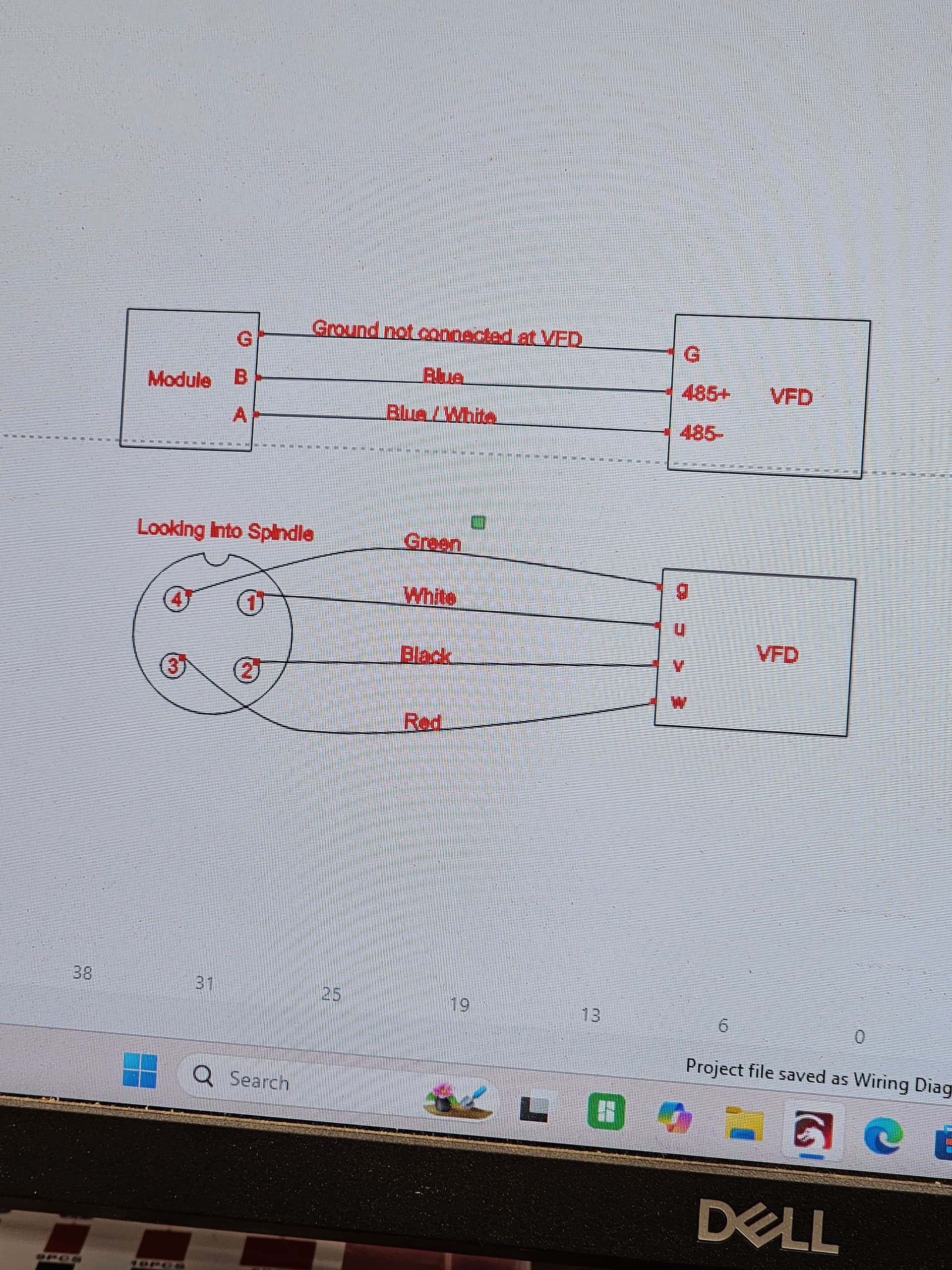

now i would like a diagram ( draw it in Ms paint) and send it to me
want to see how you wired
VFD to SPINDLE and VFD to the isolated module

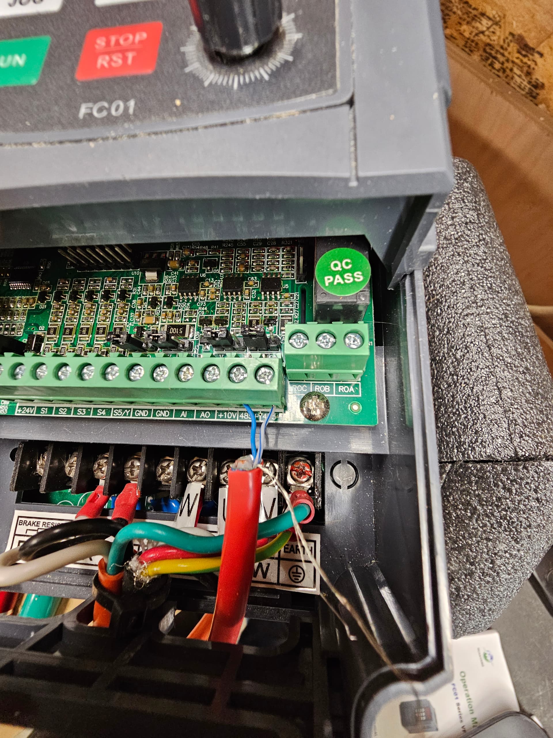

the wiring is a CAT 6 shielded networking cable with the ends cut off. I used the blue pair, cut the rest flush. Did connect the ground to the chip on the jackpot but did not connect it on the VFD end.
OH boy that is going to be rough, I did the spindle a few months ago. I have it running perfectly by using the keypad on the VFD.
I have removed and rewired both ends of the wires, the blue solid is on the B port, Blue/White is on A and the bare wire is on G at the isolated module
on the VFD solid blue is on 485+, blue/white is on 485-, the ground is not connected.

sorry, as i dont have your exact model i need to see how you wired everything and make a diagram to compare oh how it is supposed to work. my spindle its a 1.5kw 110v motor with the HY model vfd (bought the same model its linked on the fluidnc wiki
That is exactly what I tried to do, oh the agony of being a greenhorn.
if you reverse the A/B connection in the Module?
what happens?

The only thing I haven’t done is connect the ground at the VFD. According to all I have read that is not advised.
as you have the wiring The solid Blue Should be the A connection in the MODULE
the White/Blue should be B.

Here is my best effort at a wiring diagram.
