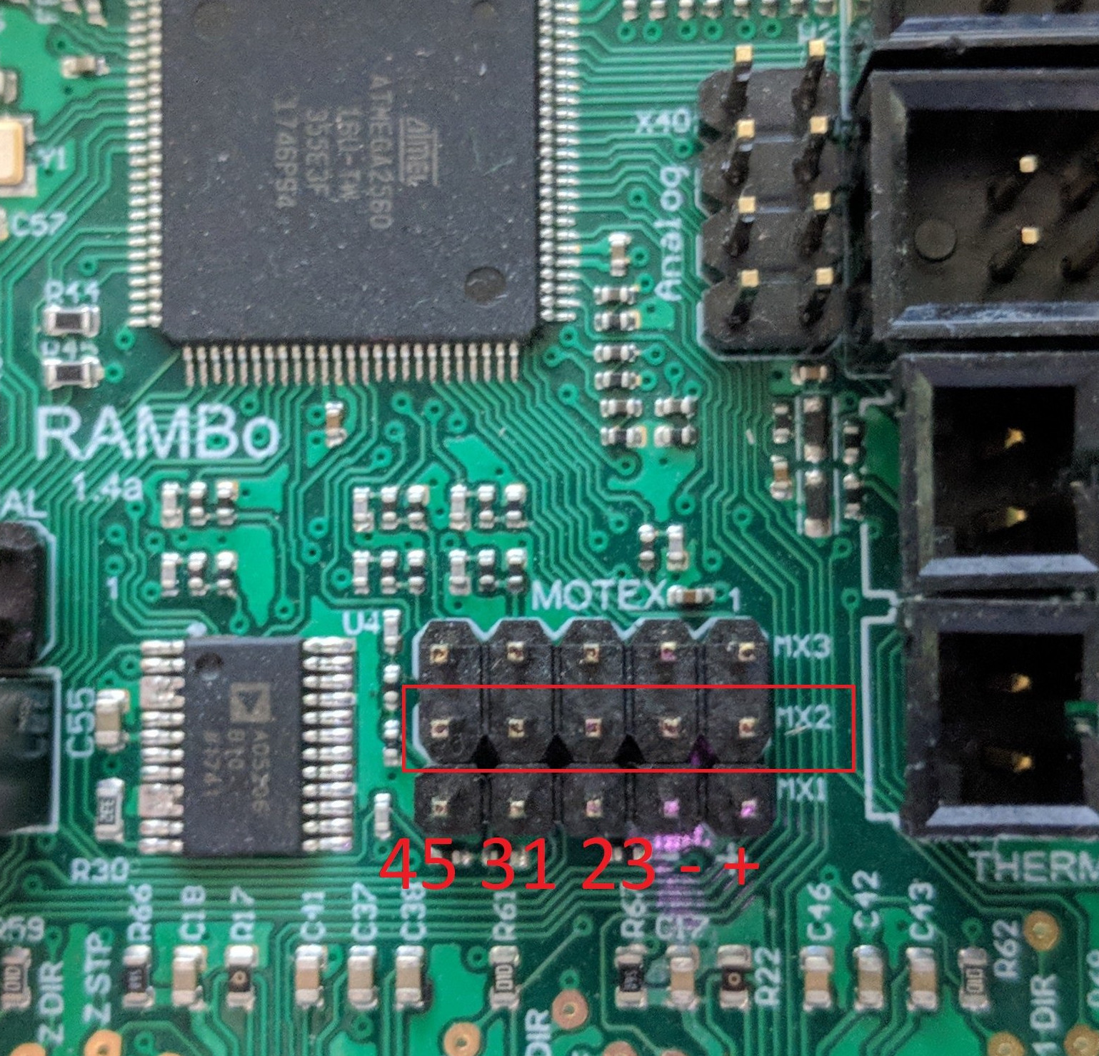

Location of pin 45:

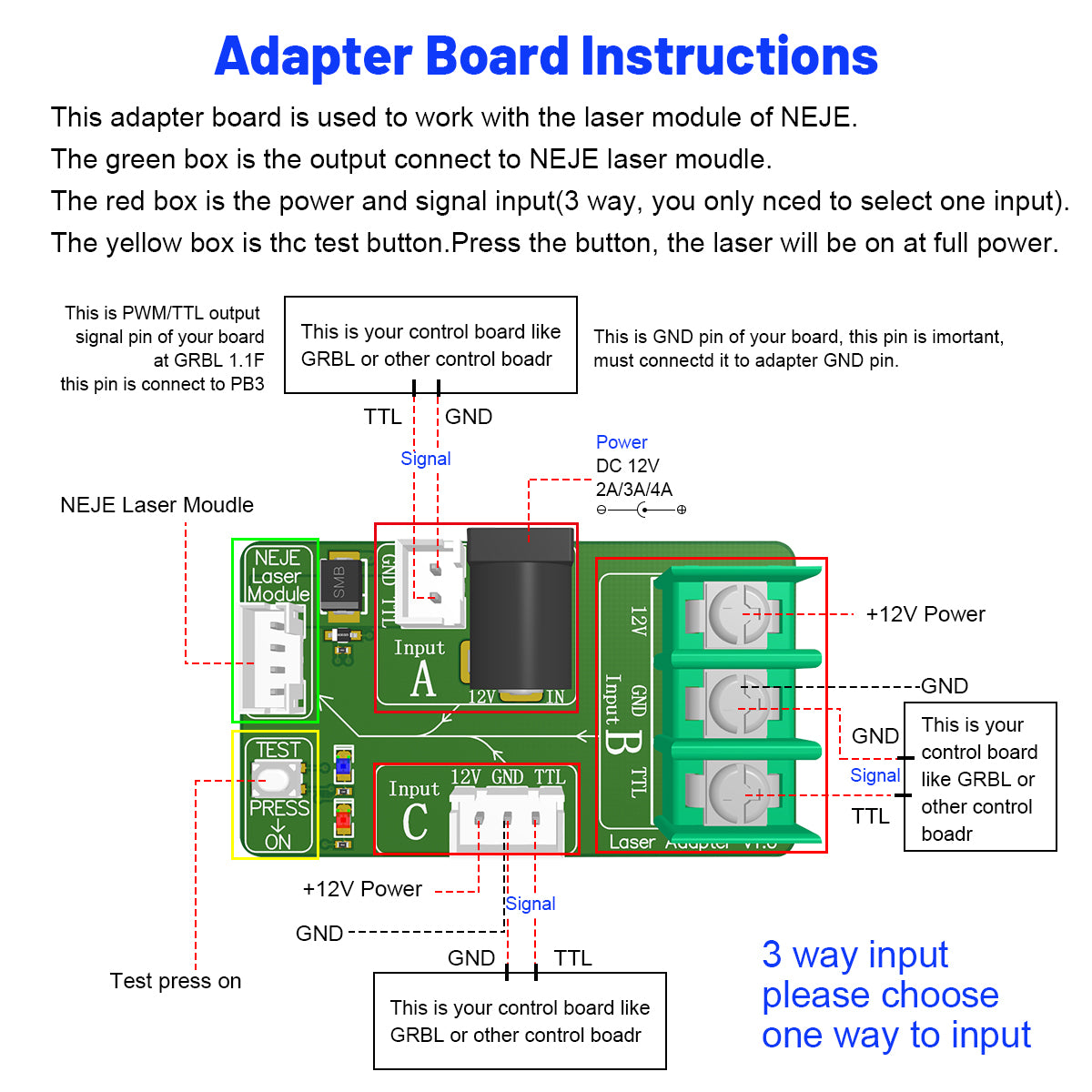

Pin 45 should be plugged on my Input A TTL signal and ground to a ground pin? Is it right?
Yes. I use this control board, and I connect to pin 45 and to ground on my Rambo board using Input A on the laser control board. In theory, if you were powering your laser from the same power supply as your MPCNC, you might get away without the ground wire connection, but this board and your MPCNC control board must share ground in some way, and it doesn’t hurt to ground the board “twice.”

If it’s not too much to ask can you take a picture of your wiring?
I am still using the power input from my laser DC12v power supply Is it bad?

You can use your external power supply that comes with the laser. Use the 2 pins connector for ttl and gnd if so.
It is how i set up my neje, bit on a skr pro
So you plug your pin 45 in TTL?
Is there a ground Pin on the Rambo 1.4 where I could connect the ground from my laser control board?
Again I am sorry if this is really beginner question :frowning:
Gnd is the minus - on @robertbu’s picture
In the picture I posted, the whole column of pins with the red ‘-’ at the bottom are ground pins. Here is a different picture:
