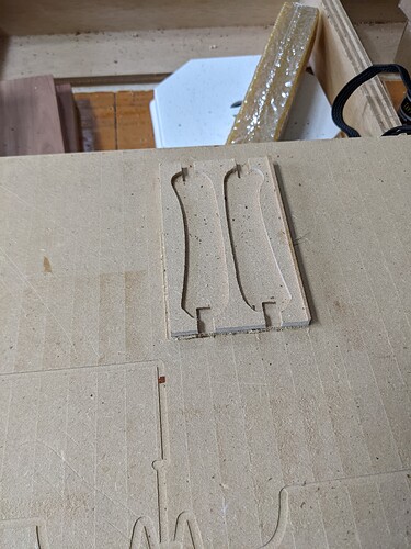

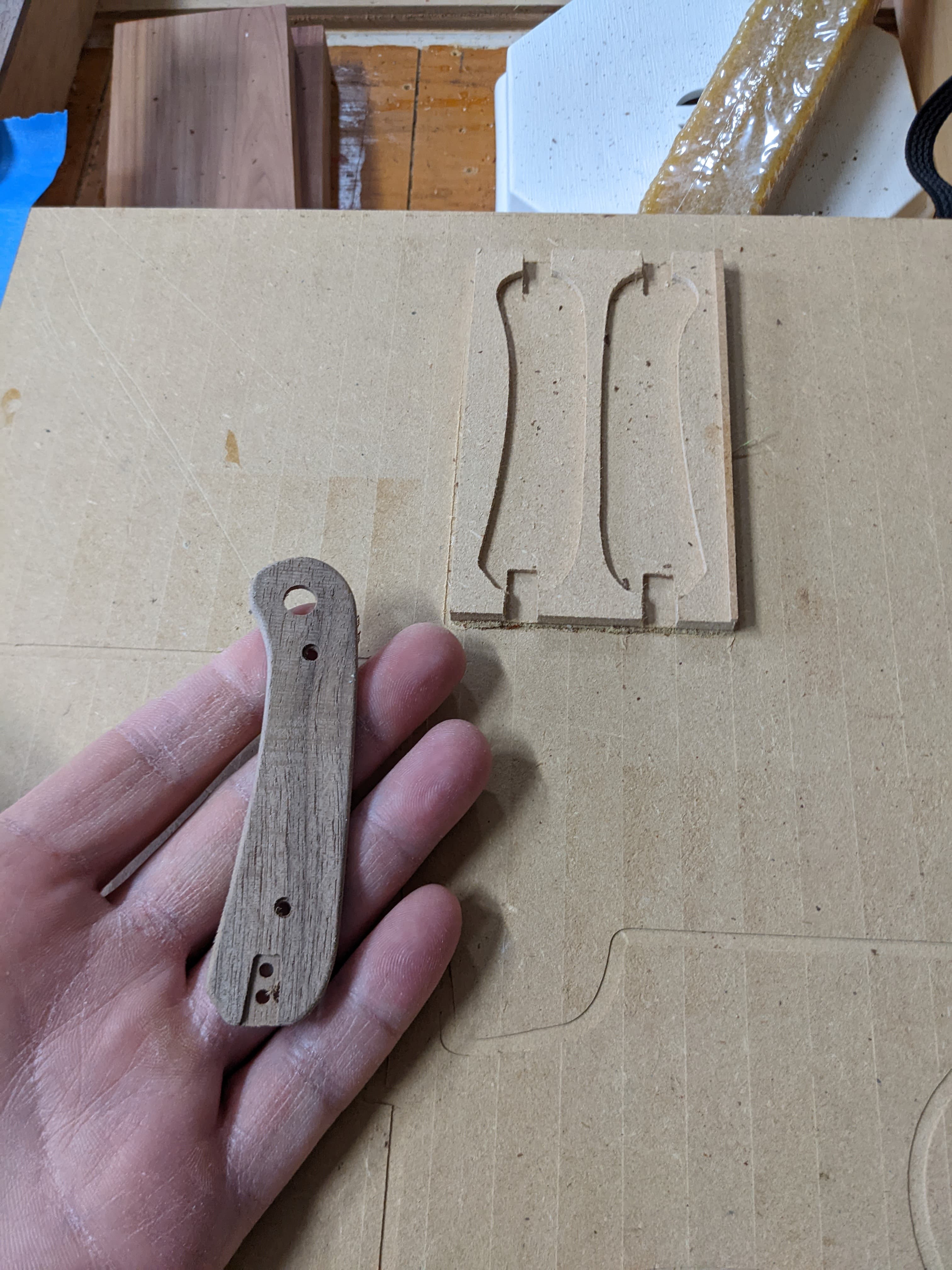

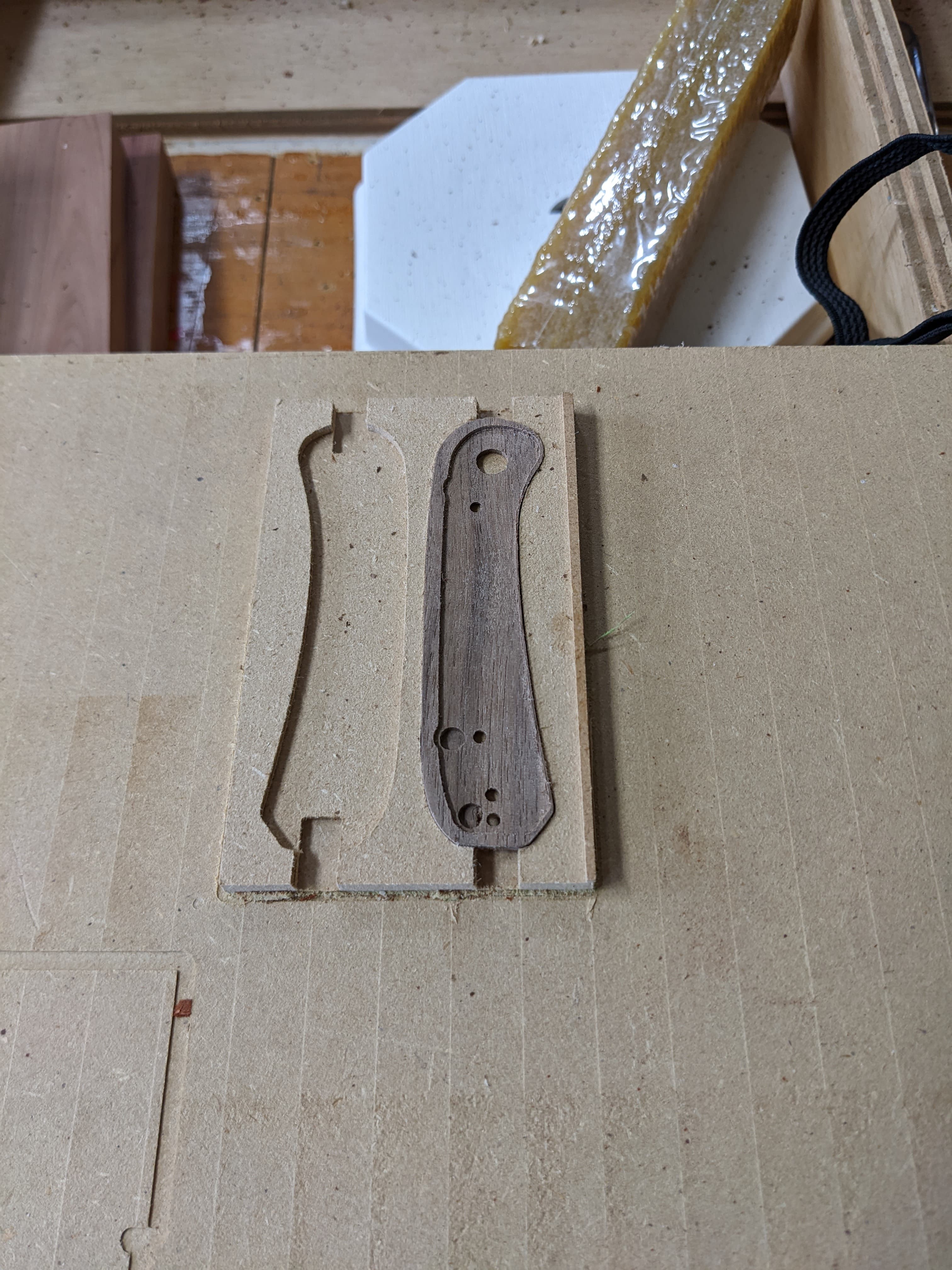

Sorry to drag up an old thread, but I was wondering if it’s possible to set zero to individual axis? I’ve got a fixture on my bed, and my zero point should be the top corner of the fixture. I want to touch off the x, zero it, back off then do the same for y, back off then do z. That will let me get the bit centered on that point more or less dead on.
Assuming your fixture is conductive and you have it wired as signal or ground, you should be able to do what you are suggesting using G38.2. If that fixture remains in the same place, you could just calculate the offset from machine home once, and then just move your machine to that offset in future uses.
unfortunately the fixture isn’t conductive, it’s MDF. I had machined ā€˜pockets’ or negatives of what I’m working on (trying to do a 2 sided machining), so once side 1 is machined/cut out from stock, I flip it over and put it into the fixture to machine side 2. I’ve gotten it close by eyeball, but still about 1mm off, maybe a bit less.
There are a number of approaches to solve your problem. If you just want something specific to this question, you can wrap the corner of your fixture in foil, and then attach a ground wire to that foil. On this forum, I’ve seen aluminum tape used for this purpose. But I have a feeling that if we knew the nature of your fixture and exactly what you were trying to do, we could offer simpler solutions.
Thanks for the reply! Here are some pictures, hope this helps. You can see it’s offset too far to the right, the ā€˜walls’ should be equal thickness
