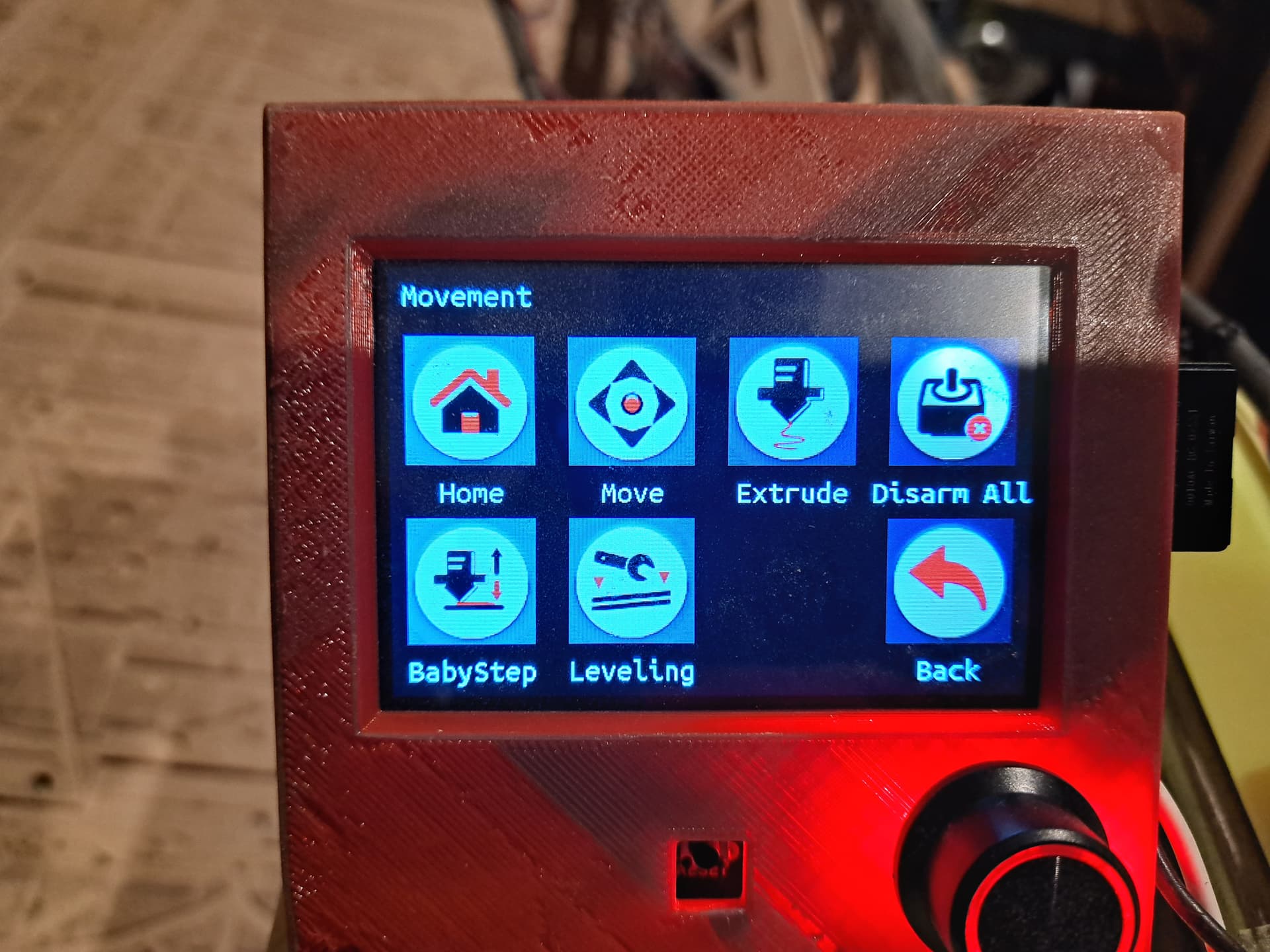

I need help finding All ZERO in the menu of my LR3 new build menu before starting my gcode.
Hmmm. Good question. I suppose you could use the terminal and enter G92 X0Y0Z0 but that’s not really the answer… Unless it is…
I was hoping to add it to the menu on the screen ( Custom Gcode) but do not know how .
I think the custom gcode is set in the config.ini file. But I am AFK.
Can how do do I activate to in the in the config.ini file
1.Zero X
2.Zero Y
3.Zero Z
4.Zero All
It will be a very good feature form the TFT LCD - so I do not have to add the Gcode Start text from Estlcam software .
While this is not what you are asking for, if you hold down the knob for 2 seconds, you can put your screen in Marlin mode. In Marlin mode, Marlin is driving the display, not the TFT firmware. In Marlin mode, there is a V1 custom menu with a menu item that allows you to zero all axes. In addition, it is easy to customize the V1 custom menu to modify or add menu items that execute specific g-code. It does require you to recompile and reflash Marlin (not the TFT firmware). Again, not the solution you are looking for, but perhaps a workaround if you don’t solve adding custom menu items to the touch display
If you use Ryan’s start gcode in estlcam it will auto set zero when you start your program. And set you up to Home z with the touch plate. I didn’t even notice you couldn’t get to that in Tft mode since I don’t use it anymore.
Code is here…just make sure you select lr3 or primo…
https://docs.v1e.com/tools/milling-basics/
