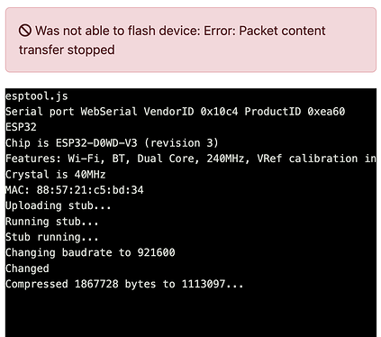

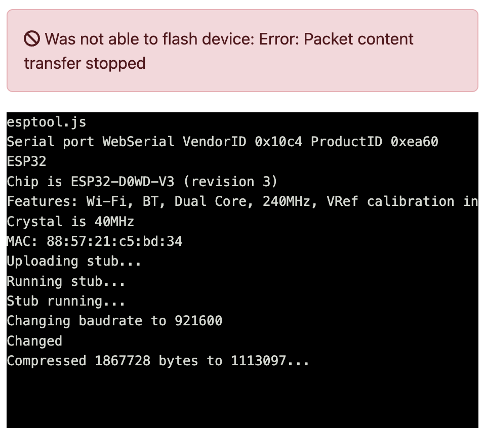

Now the board is “contactable” but:
  1. Cannot flash from the web installer
  1. Cannot be re-programmed from the Ardunio IDE
  2. Cannot be detected by the Espressif IDE.
  3. Connecting via FluidTerm has the device looping the following:
rst:0x10 (RTCWDT_RTC_RESET),boot:0x33 (SPI_FAST_FLASH_BOOT)
invalid header: 0xffffffff
