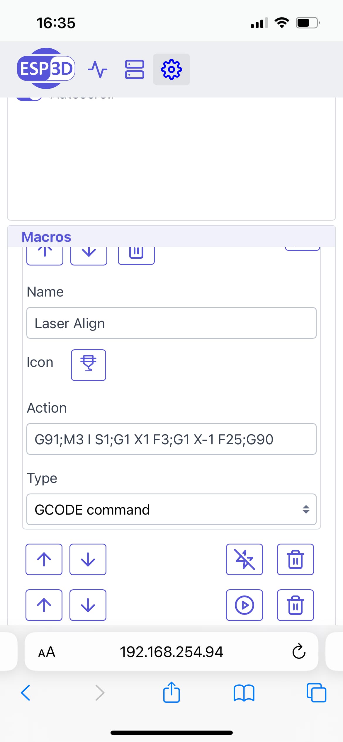

@vicious1 do either of you know how to keep the laser on when using M3? . i know you said in the newer firmware it changed, but im am having an impossible time trying ro center the laser.
Your help is so appreciated
There is a new safety feature in Marlin that turns the laser off if a move command is not received in a specific period of time (one second by default). There are three methods I know of to get around this.
The first is to use an M42 to directly turn the laser pin on and off. I verified this works for the Rambo board, so it should work on the SKR Pro.
The second method is to use bit of g-code that does a small relative move every 0.9 seconds or so.
The third is to change the value of the safety timeout. This works but makes your machine less safe, and it does involve compiling and re-flashing the firmware.
For solutions 1 and 2, you will have to figure out how to execute that code. Assuming an SKR Pro with the TTF display:
  • Type the commands into the terminal
  • In Marlin mode, you can add the commands to the V1 custom menu (reflashing the board required)
  • They can be run off a file on the SD card.
  • If send your g-code via USB, then the g-code sender often has custom buttons that can be programmed, and a terminal to type in commands.

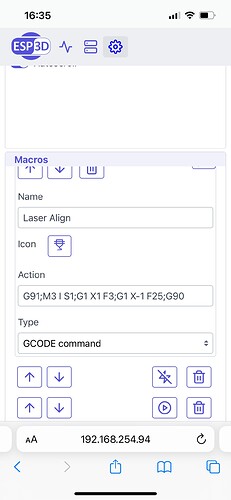

Here is what I do- it’s Robert’s ‘option 2’ above
I fire the laser at 1% and have it move to X+1 at a ridiculously slow speed, then have it return back to X0 a bit faster. This turns the laser on for around 20 seconds and moves it such a small amount it’s negligible
I control my lr3 over wifi and I have it as a macro in ESP3D
