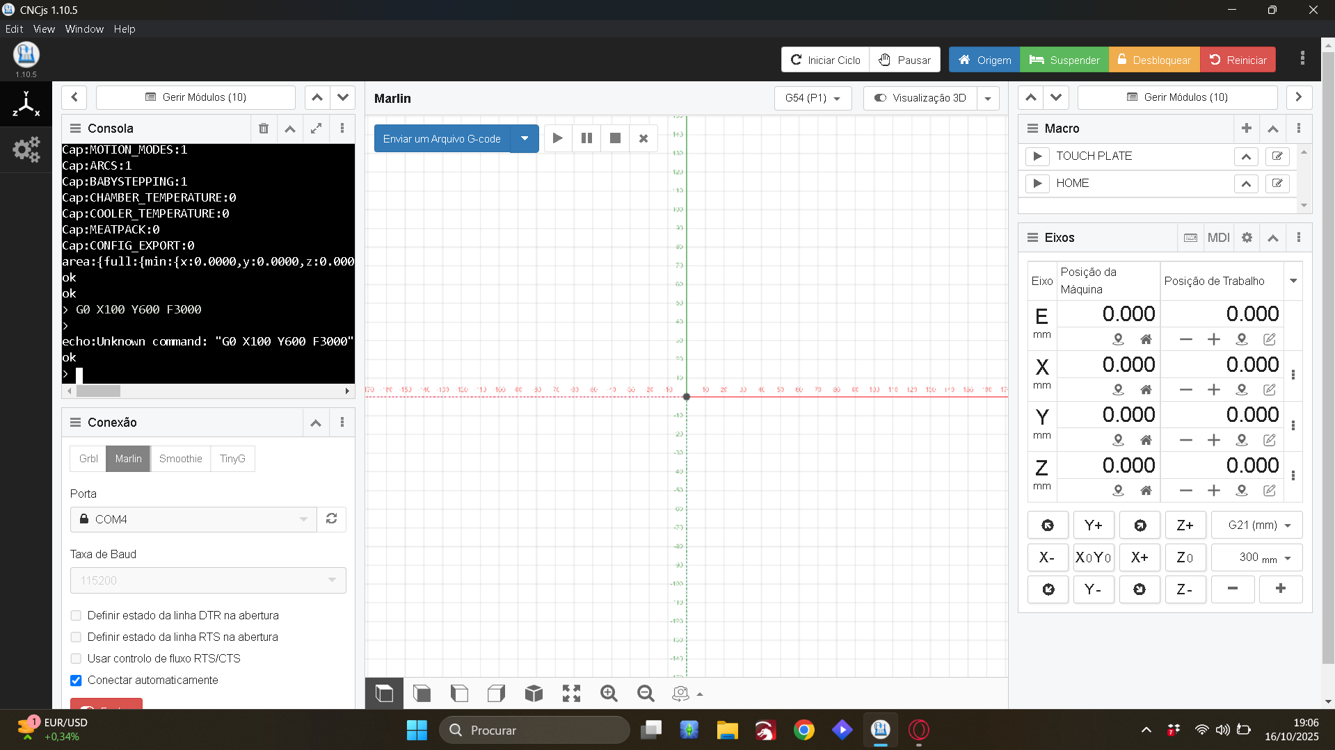

I try to send commands like G0 X100 Y600 F3000 and I get an ‘unknown error’ in the CNCjs console
Hmmm. That seems weird. Can you paste a screenshot?
I tried a few more times, and now it works when I set the speed.
It’s already solved, I uncommented this line #define G0_FEEDRATE 3000 // (mm/min)on config.adv and from now on all G0 moves have a speed of 3000 mm/min.
