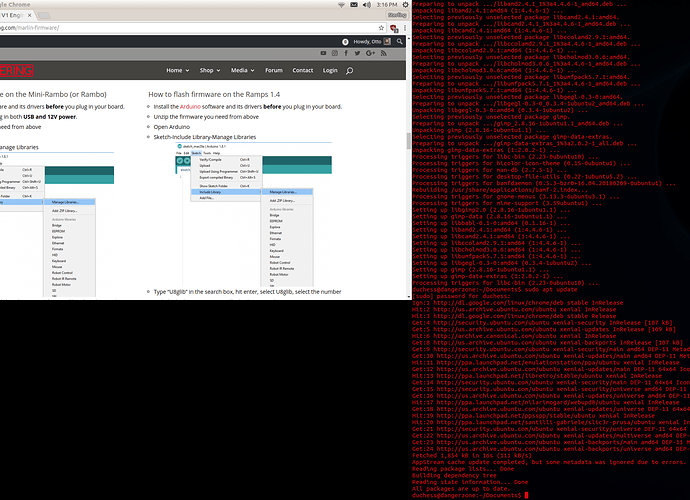

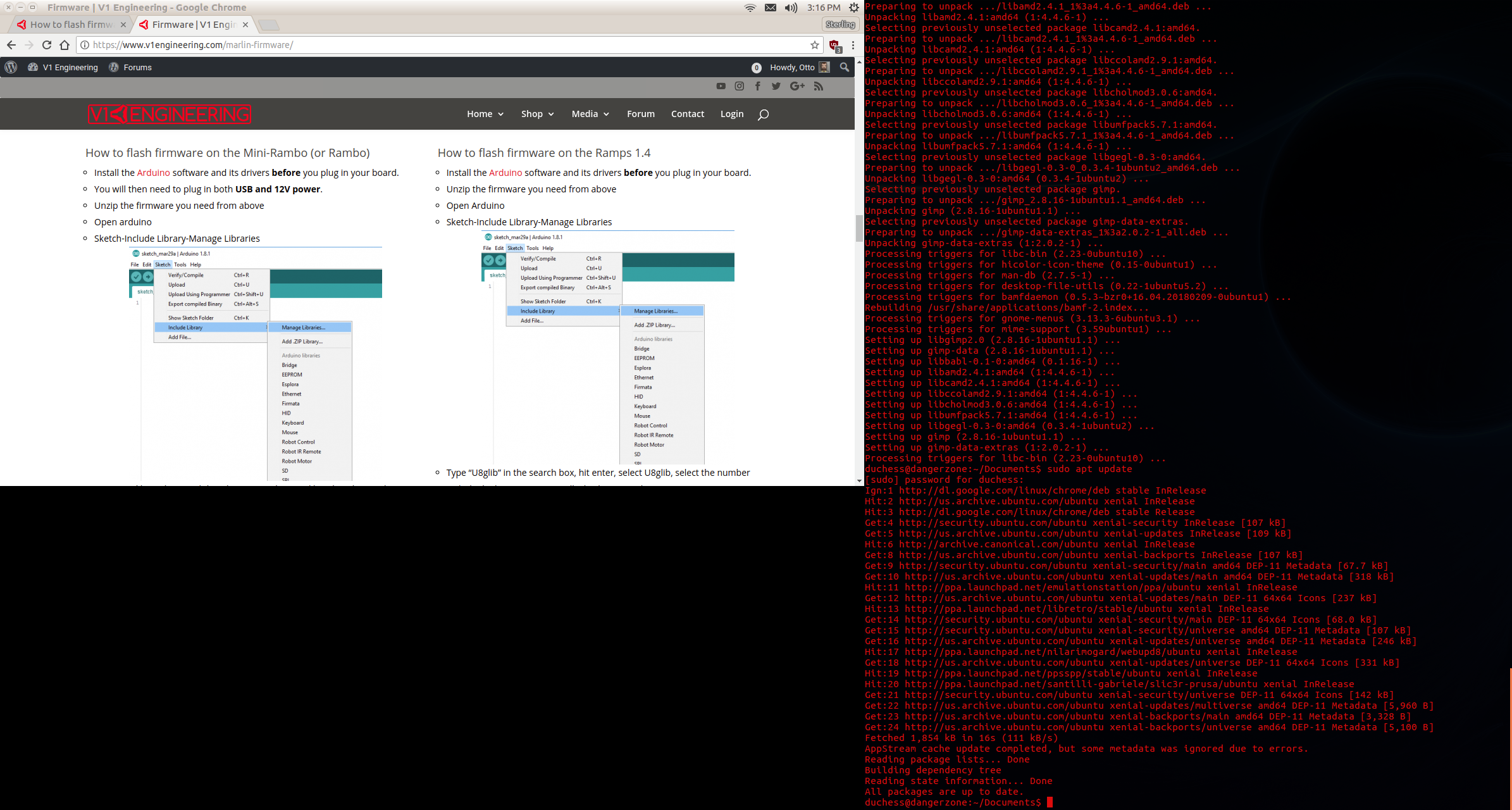

Did you do the “add u8glib” part in the howto? https://www.v1engineering.com/marlin-firmware/
Edit: the pertinent info will be like dead center in my screenshot…
sure… followed instructions provided
The error says you don’t have the U8glib. In arduino-include-library menu what does it say at the bottom.
