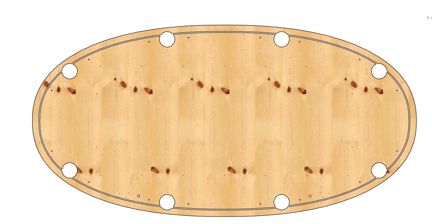

FYI, here is a screen capture of the two components that I want to nest (one inside the other). 90" x 45" overall size

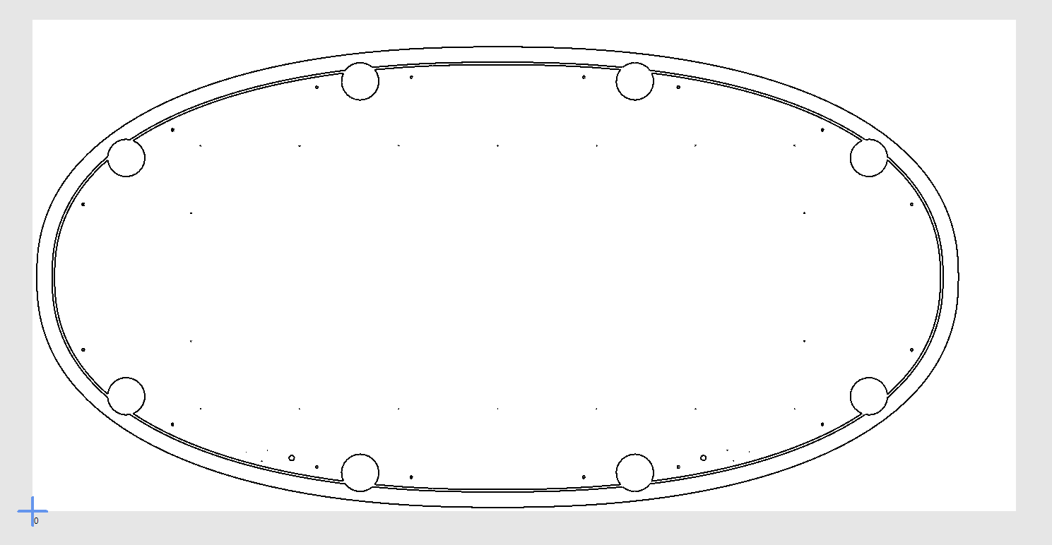

I sometimes use the “Project” operation to create sketches based on Body objects’ profiles and features. Then, export the sketch as .DXF (am using Fusion 360 free). Then import .DXF into EstlCam. Are you familiar with Fusion 360’s Project feature?

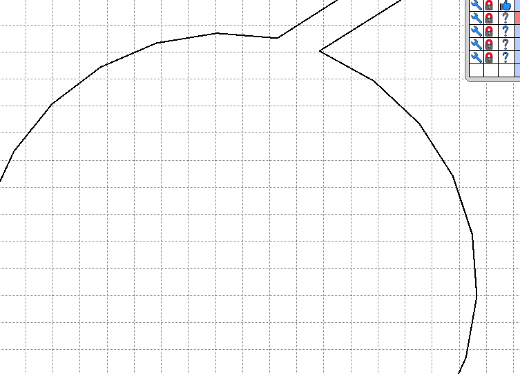

Brilliant, the projected sketch is much sharper than exporting as an STL then converting to 2D in EstlCAM.
The STL looks like it is converted to a mesh, which results in segments instead of a curve.
Close up of converted STL circle edge:

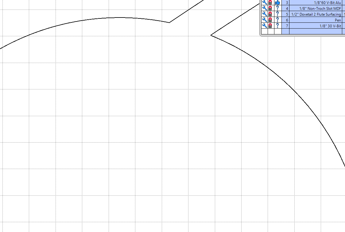

The projected sketch looks like a true curve.
Close up of projected sketch exported as DXF:
