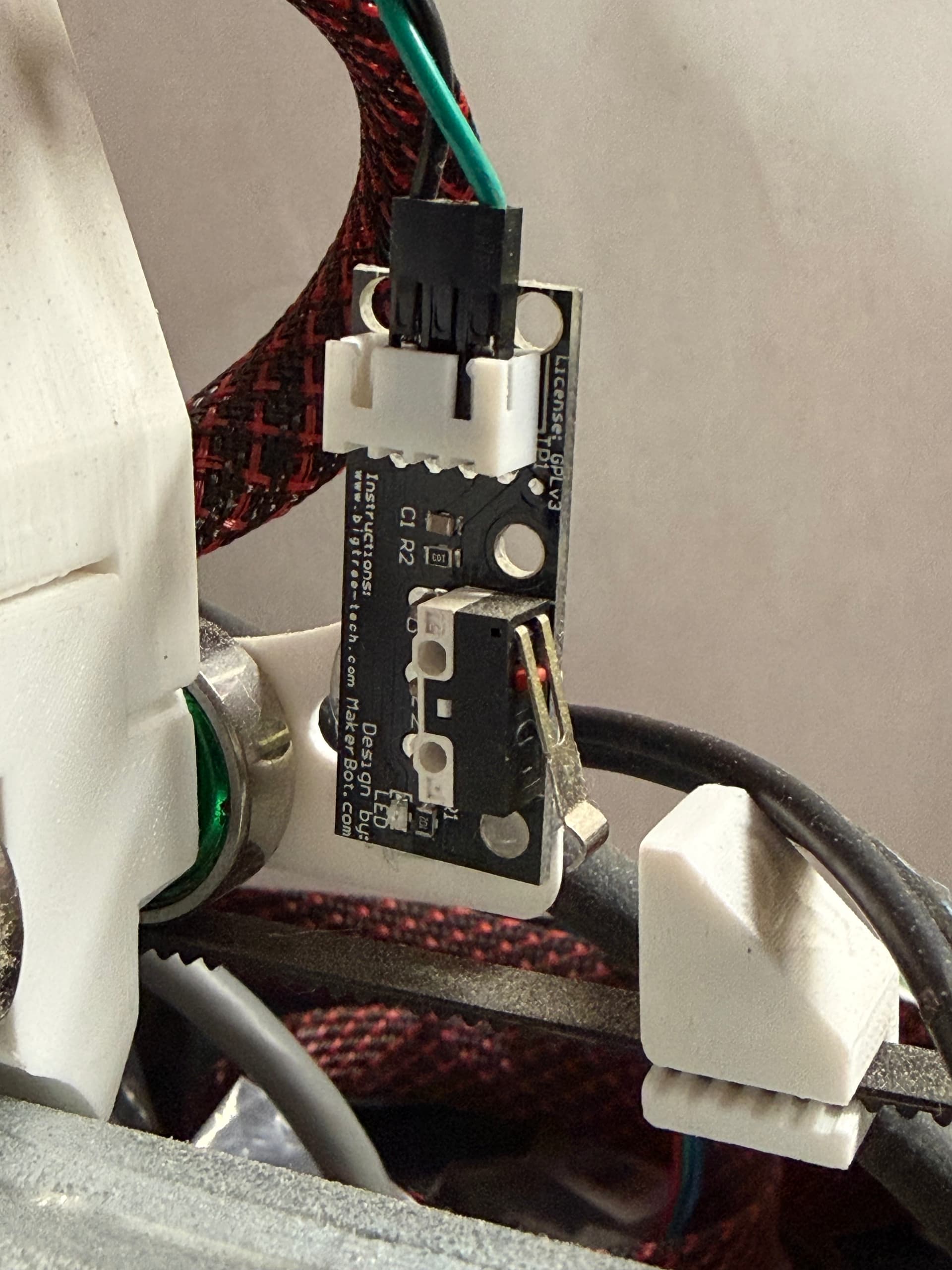

I found what was happening, the limit switch board has 3 outputs but these are not necessarily the same sensor output. In fact, there are 4 outputs on the board but 3 female pins for connection to the Shield V3.
This board only works by connecting to 5V (red wire), GND (black wire) and signal (green wire). In other words, 3 pins must necessarily be connected, and not 2 like the switch connections (COM and NO/NC).
The only alternative for this specific limit switch board is to change the command $5=0 to $5=1. In the first diagram I shared here, I connected it to the X+ (black pin) but it is to the white pin. I did so by connecting one sensor to the X+ (white pin) and another to the X- (white pin).

If the switches you have are built on to circuit boards with LEDs, I was never able to get those to work as NC switches. They worked fine as NO switches, but then you need $5=0. I cut the switches off those boards completely and then wired just the bare switches as Normally Closed (using the NC and Common terminals) with $5=1.

I need to correct my earlier statement - I just went and looked at the machine. I am using the switches as Normally Open. For the X and Y axes I did mount the makerbot circuit boards, but only used the S and G connections.
The LEDs don’t get any power so they don’t light up.

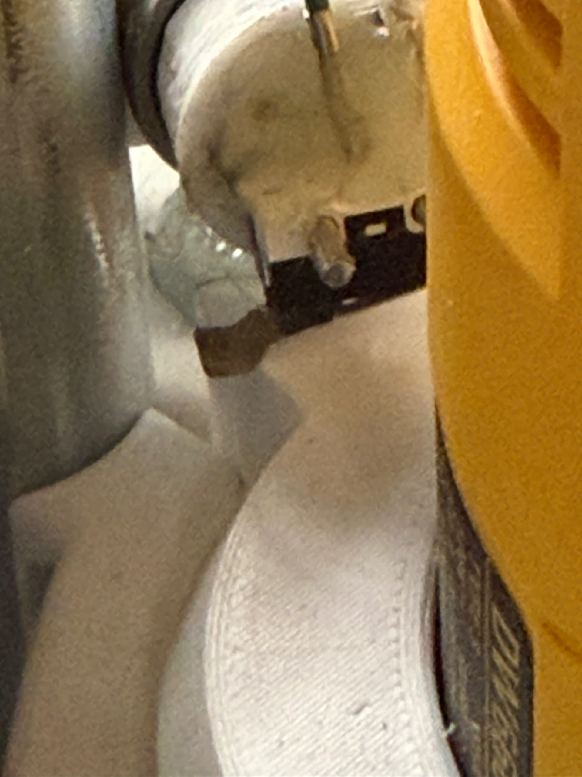

My Z axis homes “up” away from the cutting surface. I clipped the switch off the circuit board and mounted it to a 3D printed bolt cover sorry if the photo is blurry - space in there is very tight on the Burly model MPCNC and I tried to zoom in to show the switch. THere’s a big glob of hot glue around the wire connections to insulate them.
I only use one switch on each axis. For X and Y I have set the soft limits to one millimeter shorter than the physical travel of the machine. For the Z axis I have a probe wired to the SCL pin on the CNC shield, which grbl has mapped to the probe function.
