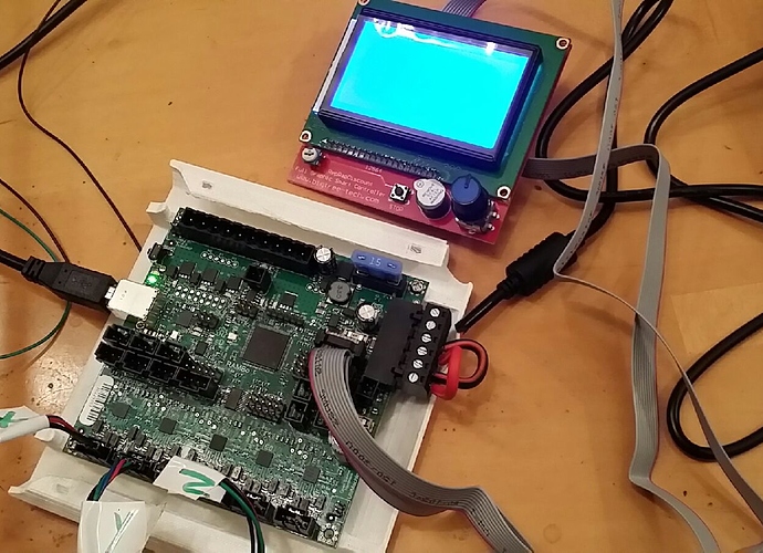

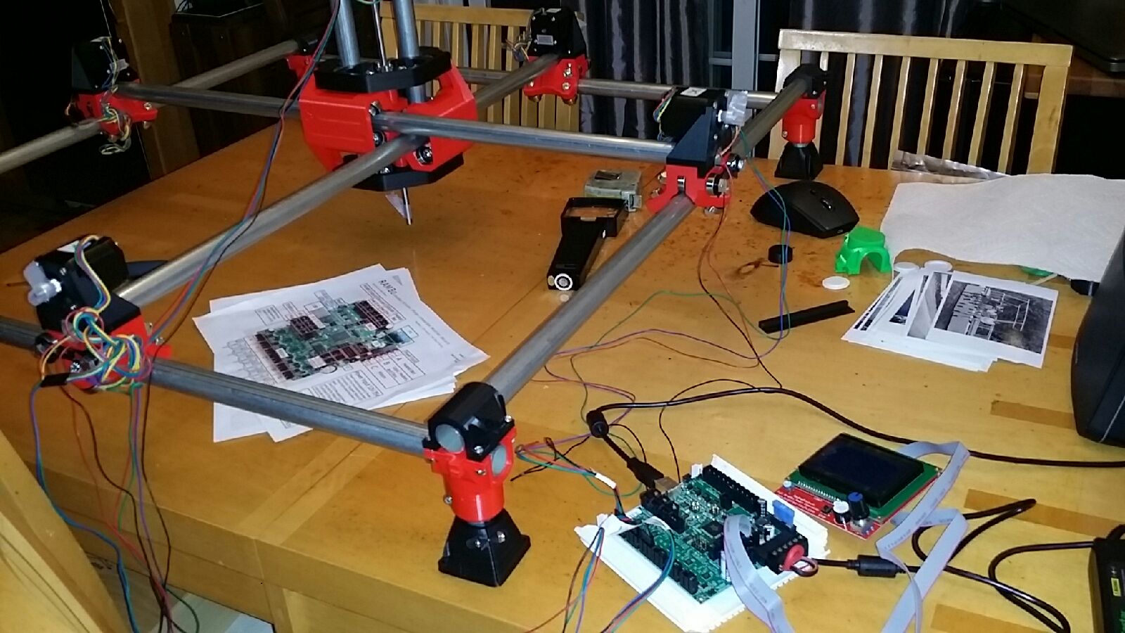

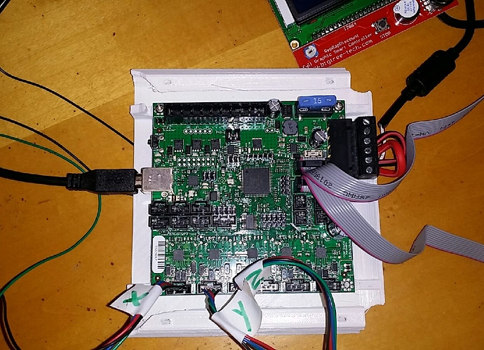

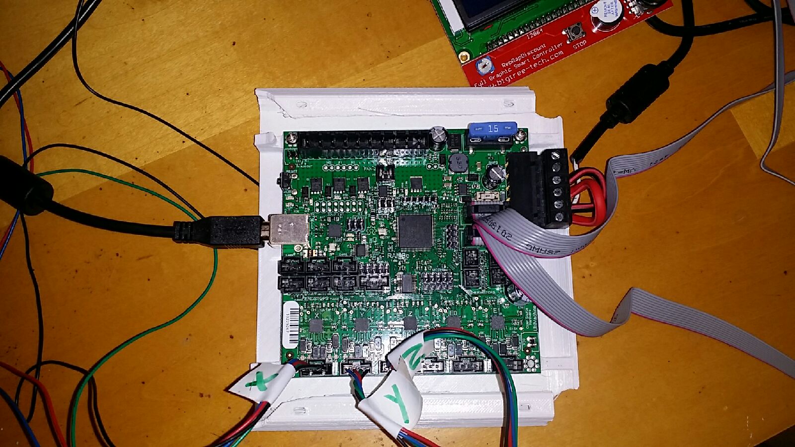

Hello thank you for your answer, it is possible but what to do, I try to use Repetier-Host I see that it connects ok to the map Rambo but I am unable to move the motors, if that’s the problem how to make it back to back, before I connect it to the computer I was able to control the engine with move axis of the map and the lcd, I send you photos,

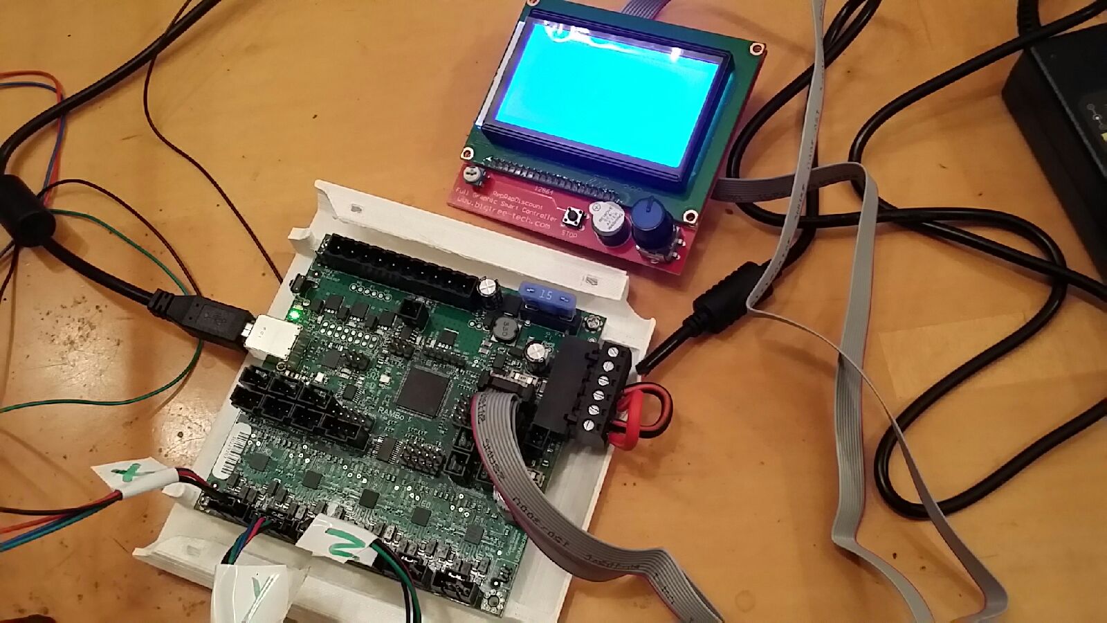

also send you this photo a led flashes continuously when it is connected to Estlcam

Hello I reconnect the rambo card to the Estlcam software they are in communication immediately after your comment that I might have flashed the card with their firmwire or something like that, I said yes it is possible I find the order "remix control as before Estlcam l uses, what I did, now a green LED and a yellow LED flash slowly continuously, but nothing came back on the LCD screen is blue, I link again with Repetier host I see that it communicates together but I can not do anything else, I tried to reflash with the method on your site but arduino displays an error after compilation.

You’ll need to reflash the correct firmware. Estlcam can’t control a rambo.
You also need to use the beta version 1.9 of the arduino IDE to compile the firmware.
