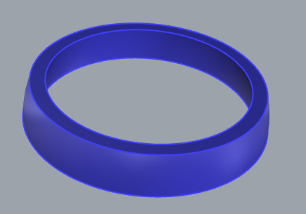

make for each square a stl. (just for visability I made the final result blue)
first hollow out the square, then turn the square over and mill the outside,
do this for all the squares and glue the parts of the spheres together. for a full sphere do it twice and glue the 2 halfs together. make the thickness off the squares the max your mill can handle.
ready

If i use the CNC I’m thinking cutting half circle rings that would nest together better (maybe). Carve the outside of the rings for the radius of the sphere at that ring.
Each ring could be keyed to set on top with the seams 90 degrees to the bottom. So each ring would be like bricks.
