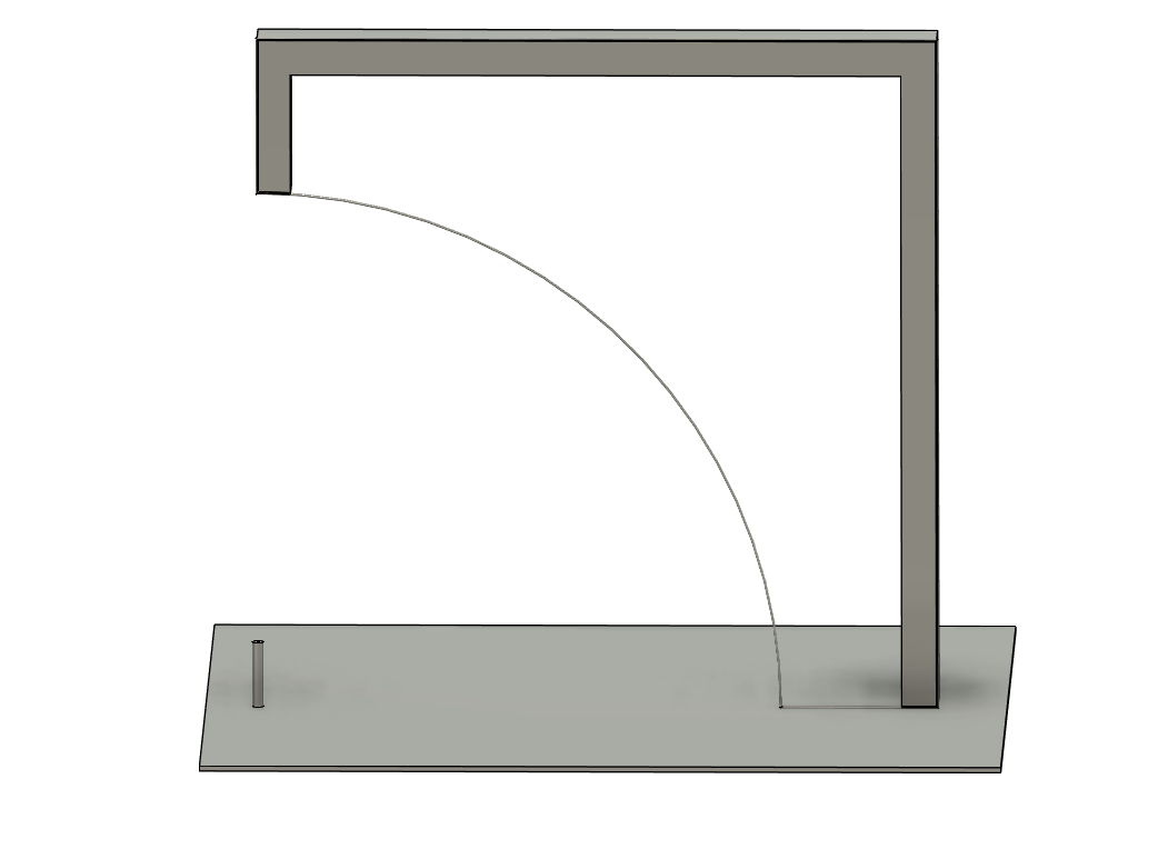

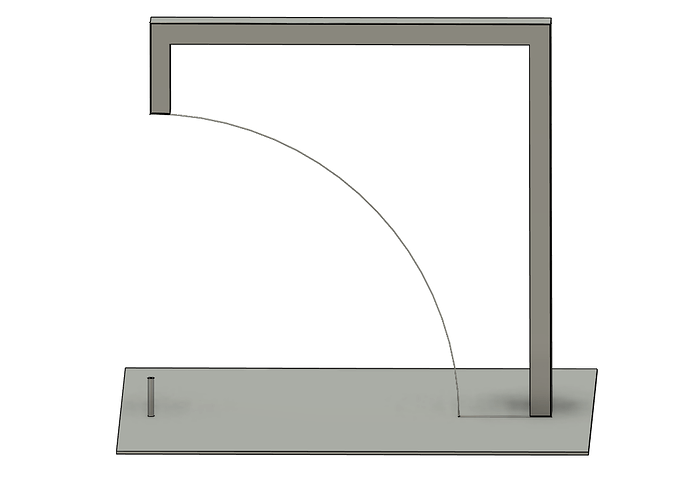

I’ve been thinking if it’s possible to bend a TIG welding wire (don’t know if that is the correct name) i n a curve and electrically heating it. Then put a block of styrofoam under it with a turning point under the highest point of the curve, then you an turn it and get a sphere:
A quick drawing:

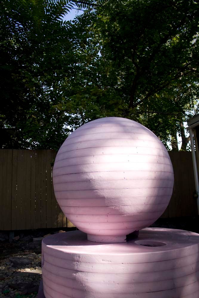

I was thinking of using XPS foam from the big box store.
Let’s assume I use the ring method, I’d make the rings 2-3" wide by however thick the foam is.
There is not specific thickness needed other than not wanting to waste material but need it sturdy.

Wonder if I have a rough cut the sphere with layers then make a wood ring with something like a band saw blades attached (sort of a circular rasp). then I could roughly smooth out the steps from layering by moving it around the sphere and then follow up with hand sanding?

I haven’t completely thrown this idea out yet. I’ve though of it before too. I keep thinking it’d be tough to keep the wire stable as it goes through the foam.

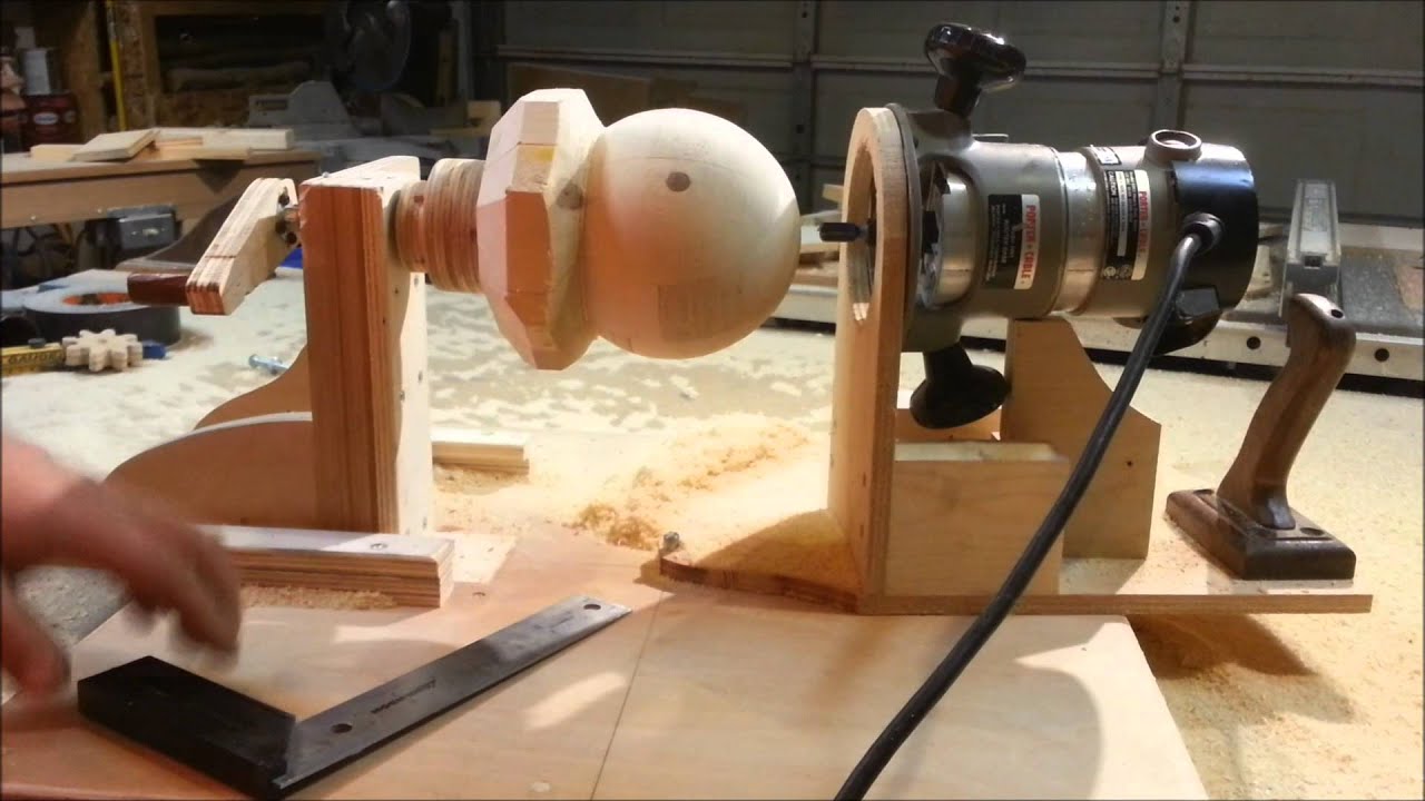

Have a look for the Izzy Swan videos on his ball turning router jig, if you’re interested. That’s what that video is. It’s basically just 2 right angle brackets to make 2 vertical faces. One bracket is fixed in place and has a bolt that rotates in a hole in one of the vertical faces turning a piece of wood to act as a ‘chuck’. The other bracket has a part sticking out the ‘front’ that gets pinned so it can swivel around a point that’s under the face of the chuck piece and then it has a router mounted to it so that the bit sticks out towards the chuck. To use it, the stock gets rotated slowly using the bolt head and the router is advanced by swinging it around the pinned point at the front. Once a full pass has been taken the router can be moved closer, either by changing the height of the router in the base, moving the hole for the pin or moving where the pin is.
For foam, I’d probably just move the router in by hand until it was close and then only pin it in place for the final few passes. It’d depend on how you make the blank a bit, though, I think.

You could also potentially do it with something like a metal pipe (steel brake line?) or some ~1-2mm flat bar or something like that? It’d be a bit more challenging to heat but it’d hold its shape well. I suspect it’d be too hard to heat electrically but with a blowtorch it’d go. You could CNC cut a 1/4 circle to bend/hammer/press it into shape over.

It worked amazingly well for the wooden domes I’ve made before. The nice thing is it also gives you an easy way to sand/finish them because it’s still on the rotary tool.
My thinking is that the challenge is likely getting enough adjustment in the router position to easily go from a rough blank to the sphere, but that depends on how you’re making the blank in the first place. From 2" thick foam pieces cut either by CNC or jigsaw/hand saw/hotwire I suspect you’d end up pretty close, though.
I was thinking you’d also need to make it solid and then hollow it out afterwards, but if you made the chuck face big enough that you could mount the hollow ring directly onto it then you could make it hollow to begin with, which might save you some material if you stacked it up from rings.

The top and bottom of the sphere need to be opened as well. I can just put a flat temporary “cap” on both and use that to mount it. Maybe wood cap for stability.
That seems like it’d work quite well. You could start with just a plywood round, mount it to cut the half sphere, cut the center out afterwards and you’re away. That way the foam could just be glued to the plywood straight up without needing to be cut off after…
The plywood round could be oversized and cut at the same time as the rest of the sphere, giving you perfect registration between them, too.
