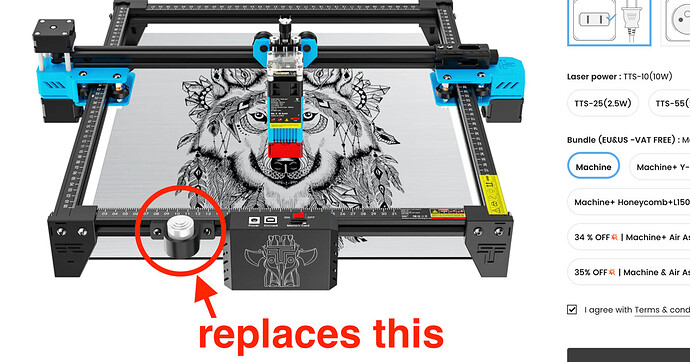

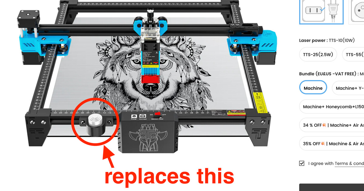

The laser rig comes stock with a nice metal “focal length assist column” and comes with a 3D-printed holder for it. However, the printed holder’s cup was too small to hold the column. So, I designed an improved version of the holder, available here:
Here’s a quick video I made about the new holder, which can also work for the same column on at least three different models of laser rigs from TwoTrees:
