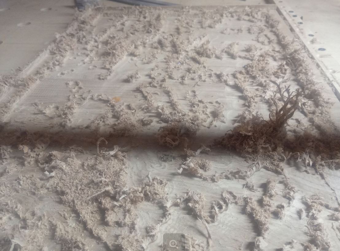

So far I have some experience with roughing 6mm flat end (aliexpress.com/item/32819837274.html).
Mine survived for 25 hours of working. Stepover 40%, 2mm stepdown, 650mm/min, 12000RPM, hard wood (ash-tree). After 25 hours it started to work like you can see attached photo. Actually, I expected it to live 10X times longer and this frustrates me.
I think expecting a $5 endmill to last 250 hours of cutting is very optimistic.
I also have doubts about a $5 endmill actually being carbide as that one is advertised.

Ok, got it. I actually used 2mm stepdown. I’m thinking, maybe I used wrong stepover and/or fast feedrate that has led to fast wearout?
Agree on the glue in MDF. Additionally, the most common routers used for the mpcnc/lowrider spin too fast to make anything other than dust in mdf (since they can’t reach the appropriate feed rate), so you make a lot of dust instead of chips. That is in general for MDF though, Even the Shopbot Buddy we have just makes dust. Dust means heat, heat kills endmills.
I have just read same 30 seconds ago in another local forum :slight_smile: From 2 separate sources I interpolate that with feed of 1 m/min I should reduce RPM to 4800-5000 (while so far I did 12000 and I witnessed dust).

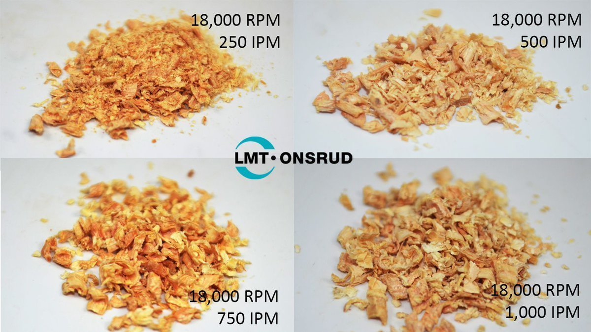

However, which size of particle is dust and which one is chip?
[attachment file=“cxhips onsrud.jpg”]
While I can’t quantify what size makes a “chip”, maybe this graphic will help. The reason it’s more difficult to get chips when cutting MDF (for most hobby routers) is because it’s literally dust and glue.
Yes, I definitely didn’t see such a big particles in my dust…
To be fair those aren’t MDF chips/shavings, but I believe you get the idea.

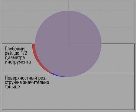

Also should take this into account. When stepover less than 50% then a single cut that a flute makes is thinner than theoretical. So above stated formula should be adjusted correspondingly.
