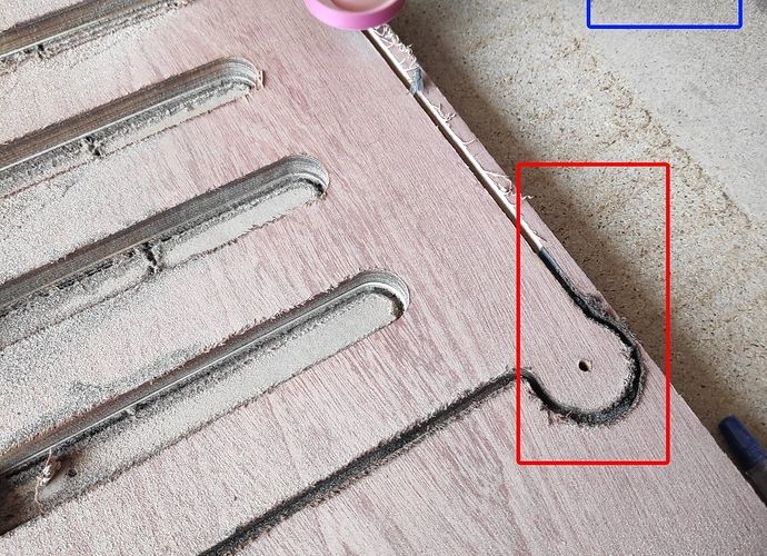

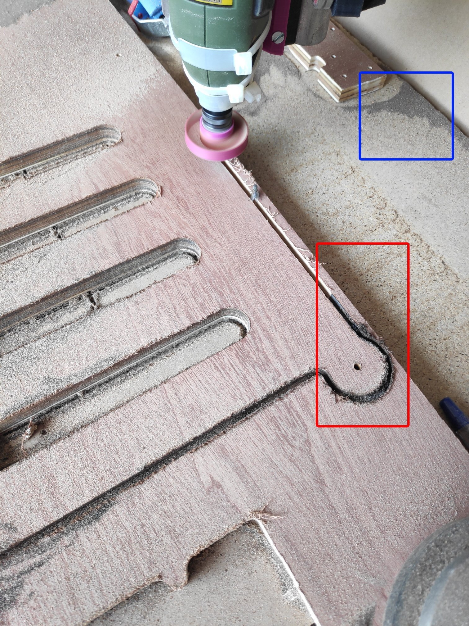

I took it pretty much to the edge this afternoon, had to change the bit on my last part for the MP3DP.
The one I used is a dirt cheap 1/8" bit from Aliexpress, for ~12$ / 10 pcs.
The time I ordered them I didn’t know that it would be better to use a single flute, furthermore the usable length was 12mm, as the multiplex was 12mm as well, I decided to go in 2 passes.
On the picture you can see quite clearly where I changed the bit, the sawdust turns a lot darker on the last hour of the bit too, so that should clearly tell you when it’s time to change.
