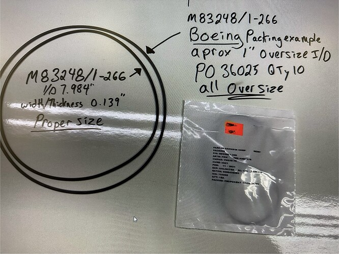

Houston we have a problem, belts
SWEEEEEEEEET!!! :partying_face:
Just curious if they have any batch or cure dates ?
That’s how we track our defective things.
Should also let the vender know as well.
It says Boeing, so don’t pretend you wouldn’t still use it whether it fits or not… :stuck_out_tongue:
Don’t get me started on that company lol. Mc Donnell Douglass dudes messed that all up.
But at least the vender can track it down to a batch defect and correct it.
None I can see to report back to them,
Absolutely.
