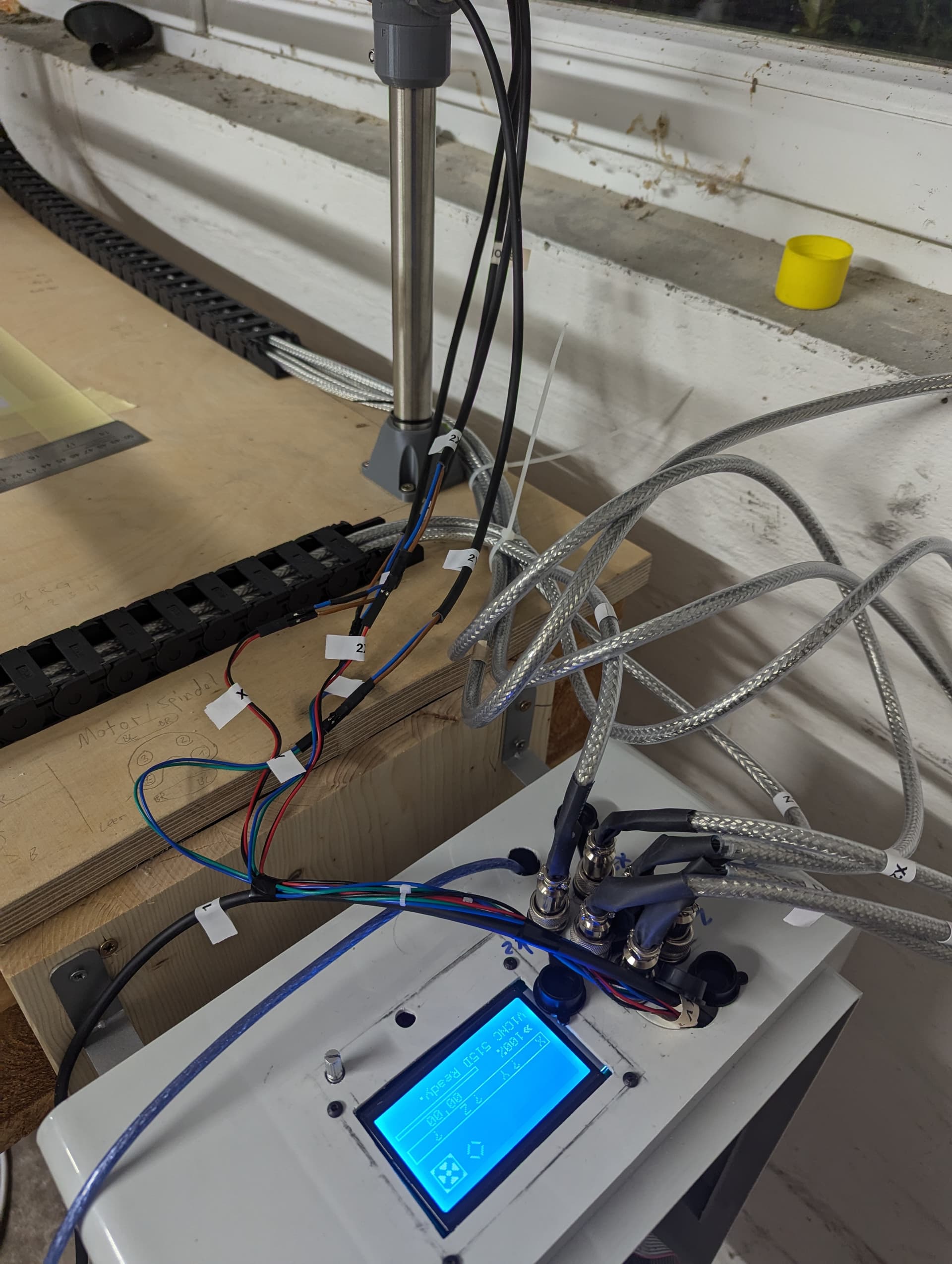

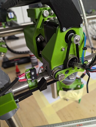

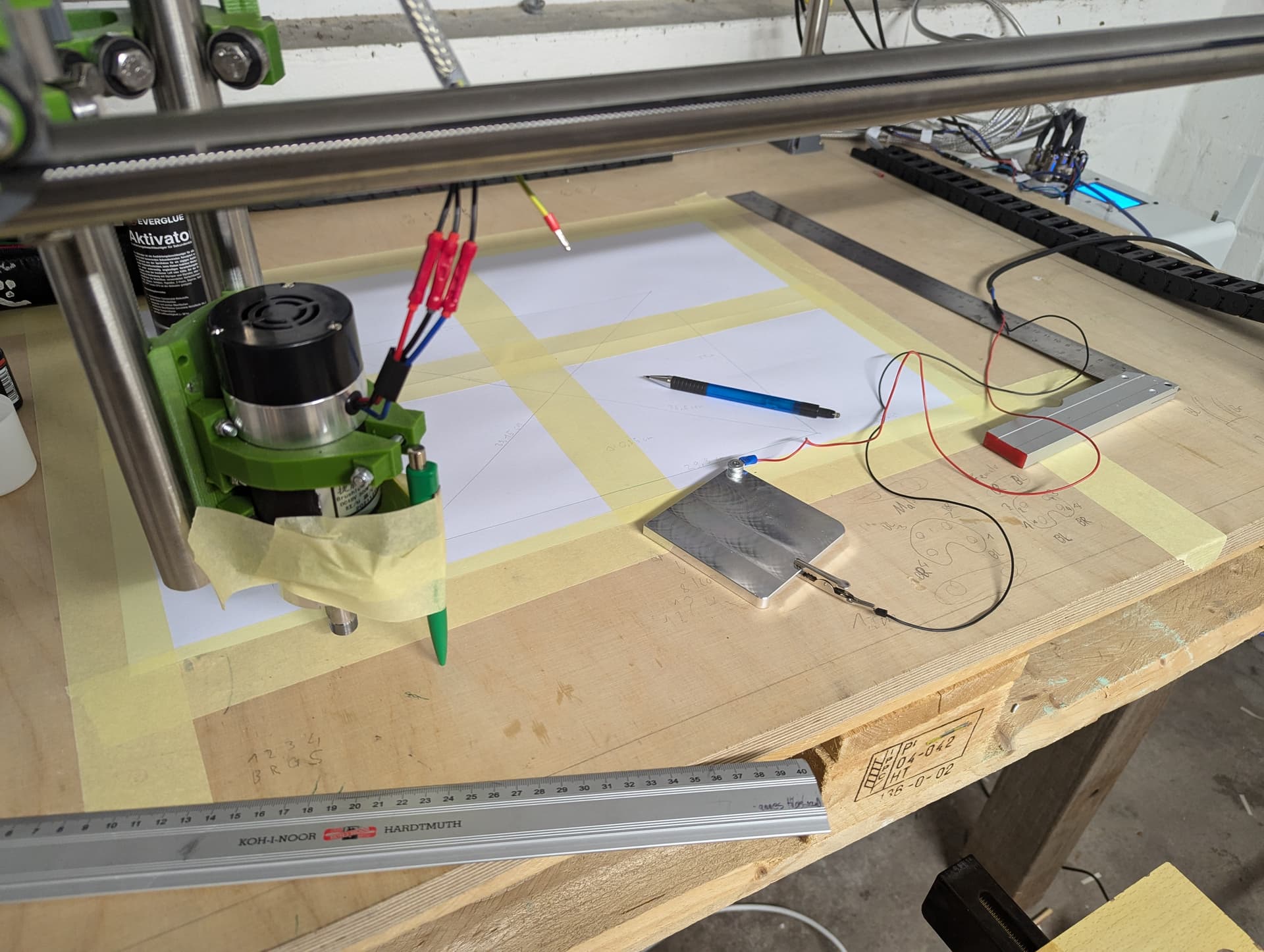

Hello everyone,
I need some help with my mpcnc. The homing function doesn’t work with my dual endstops. Whenever I enter the homing code or click the home icon in Repetier-Host, the machine continues moving even though the endstops are triggered. I have tested the endstops both in open and closed positions, and Repetier-Host correctly shows the status of the switches. I can also turn the Z position on and off with my plate.

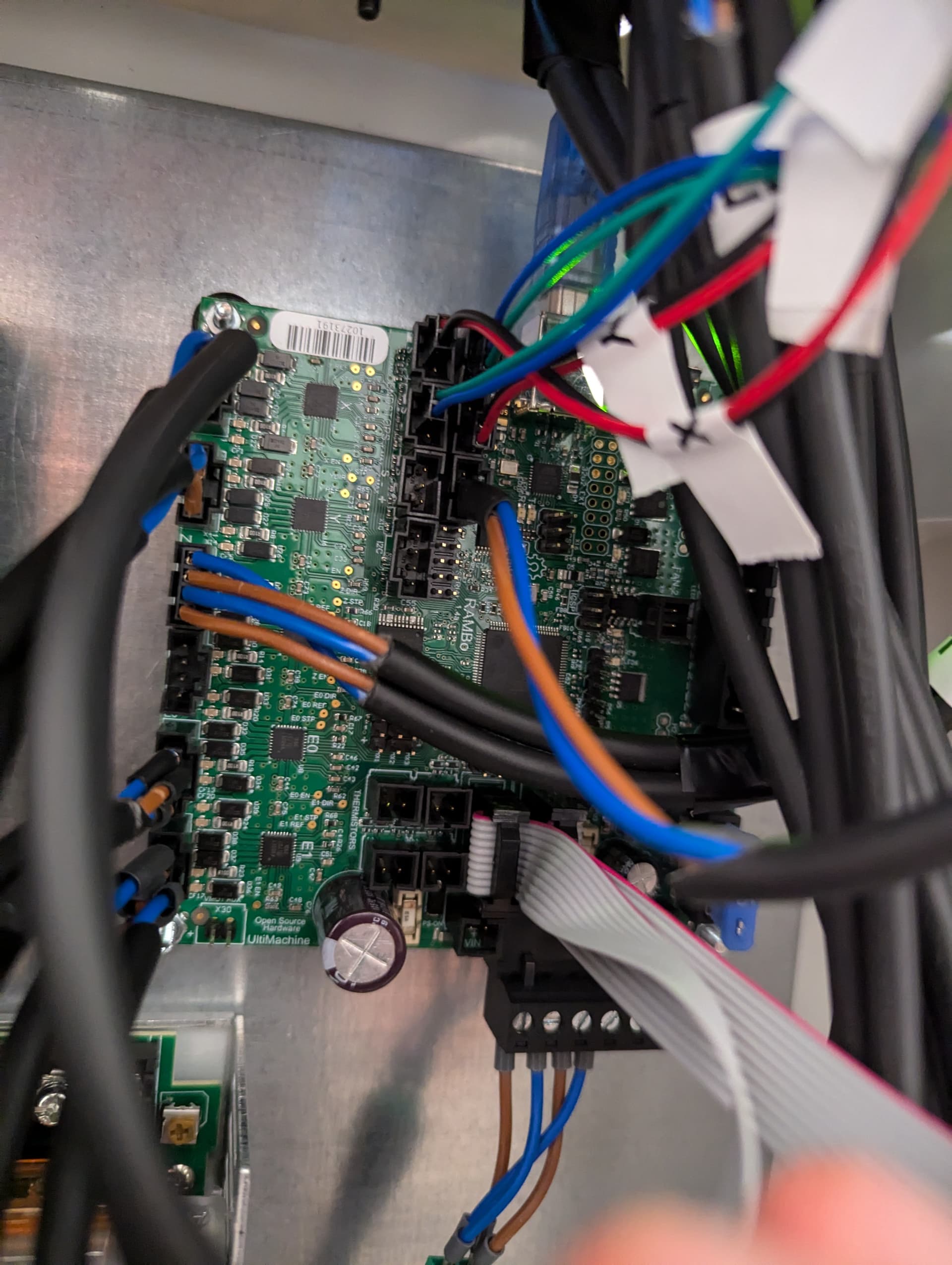

I am using the standard Normally Closed configuration as described in the manual. I usw V1CNC_Rambo_Dual 2.1.1 / 515 and Changed nothin in the configs. I’m using a Rambo board and have followed the wiring instructions but can’t figure out what’s wrong.
Any advice would be greatly appreciated.

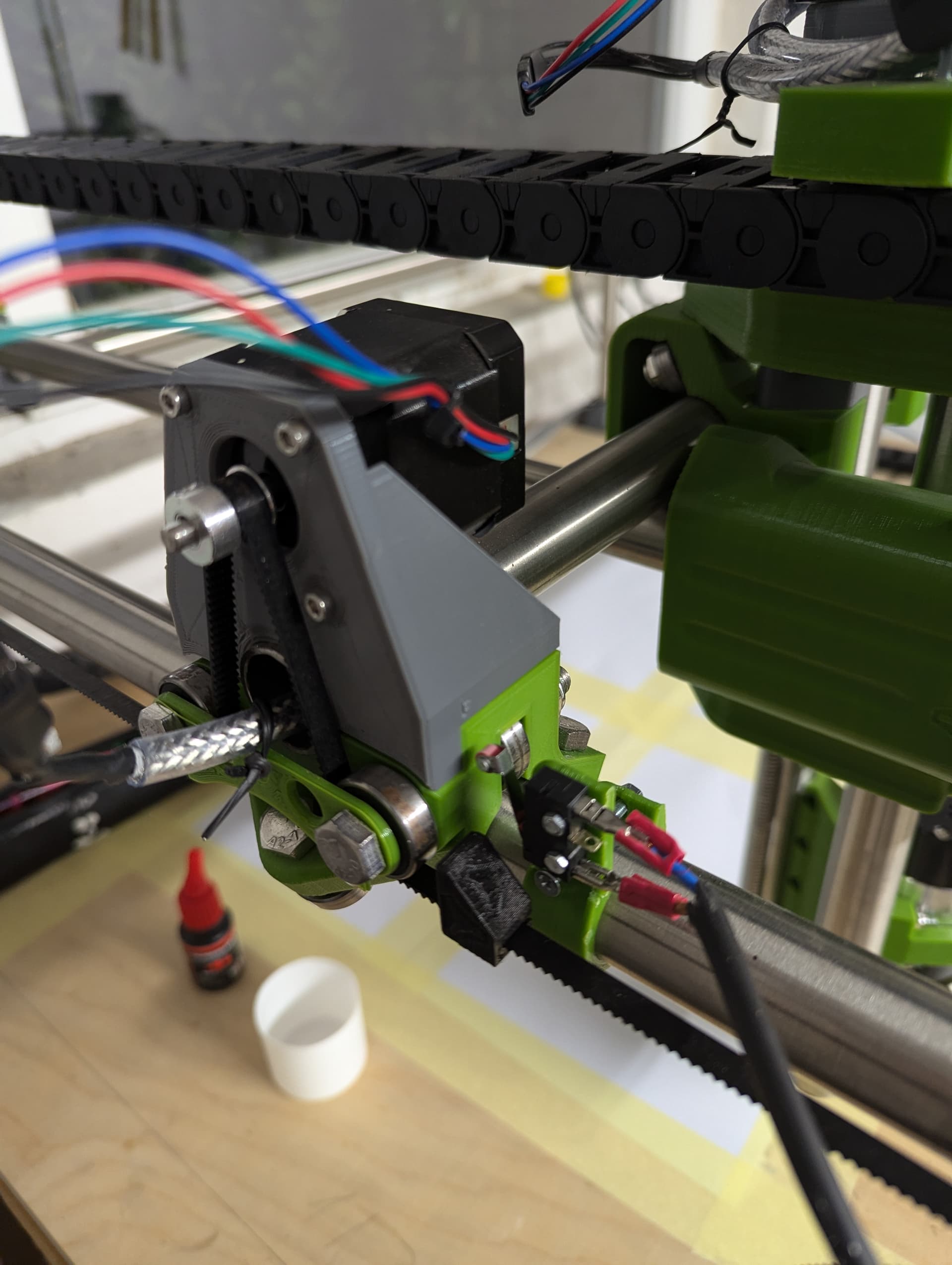

Are you sure the X1 end stop and X1 motor match, etc.? That’s the most common issue as long as the switches themselves are responding properly.
I once manually triggered all the switches during a 10 cm journey, but none of the motors showed any sign of stopping.

That doesn’t apply to a Rambo board, only a very few SKR boards.
This is the most likely issue, mismatched motor/endstop pairs.
Use M119 and verify that the endstop for the X1 motor shows up as such when triggered and queried with M119. Repeat for each motor/endstop combo.
I don’t know what I did wrong. I measured all the endstops at least three times and confirmed they were correct. This morning, I realized that the X and Y endstops were switched. I suspect that I visually assumed the X-axis was correct because Y2 is all the way to the right. I can’t explain my mistake any other way. Thank you very much Tom Traband and MakerJim!
