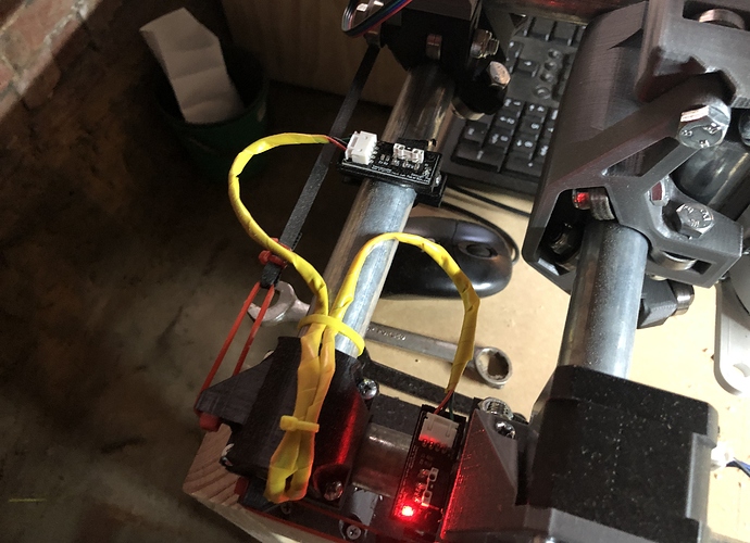

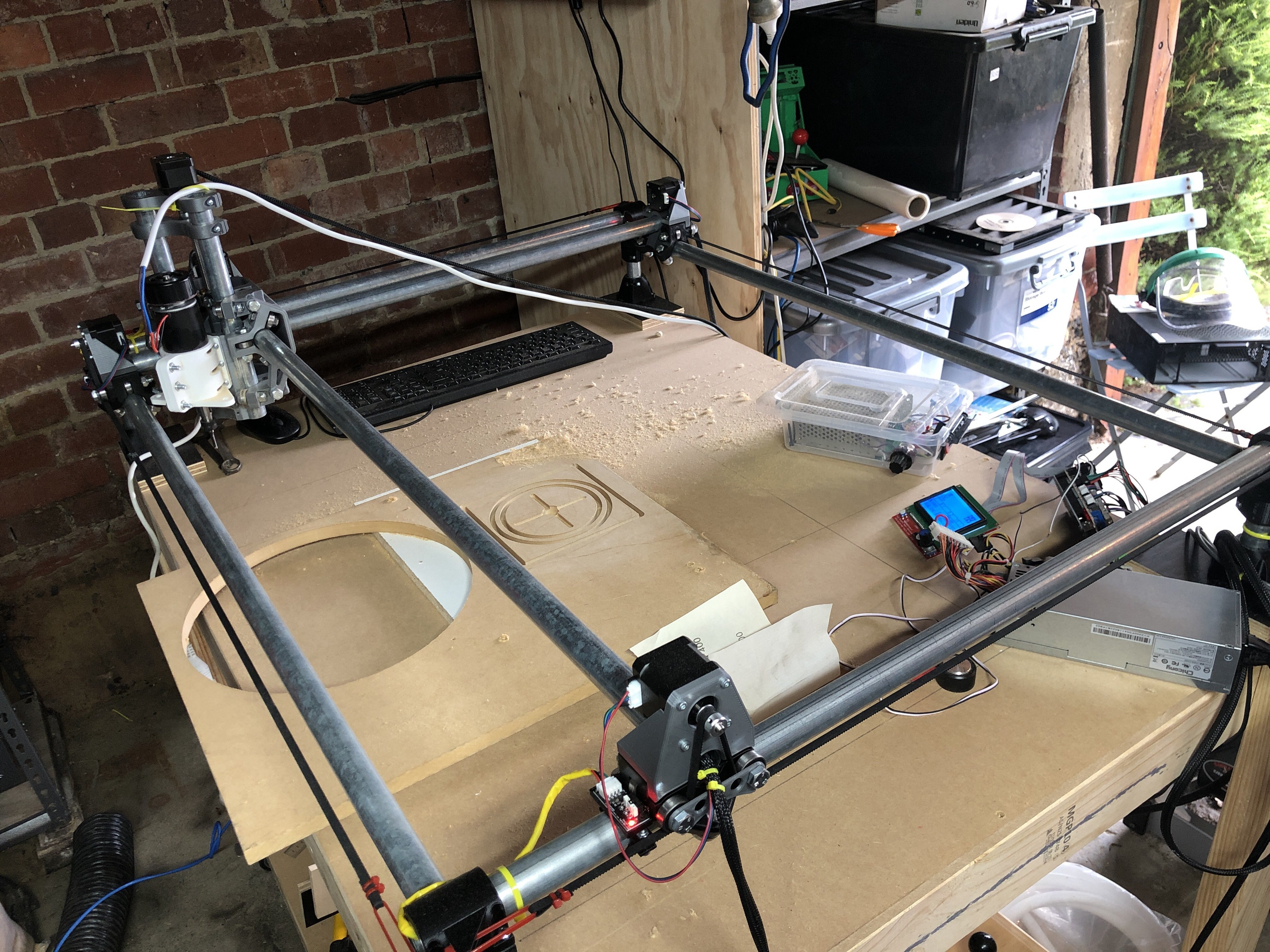

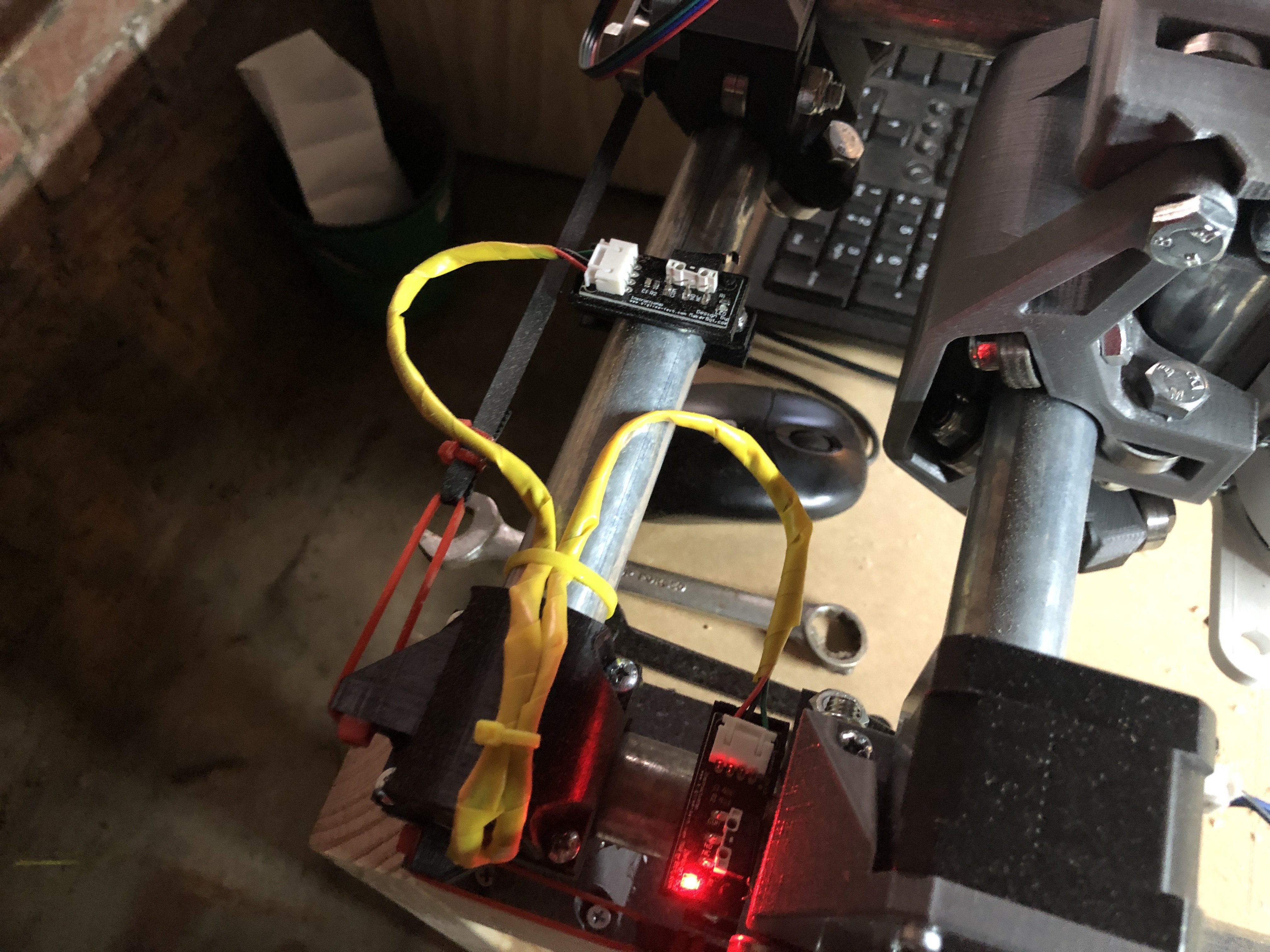

i have an an issue with homing on a Ramps 1.4 dual Endstop with large LCD.
whenever I home from a large distance it halts… eventually after resetting a number of times I can home and auto square.
This happens on all axis.

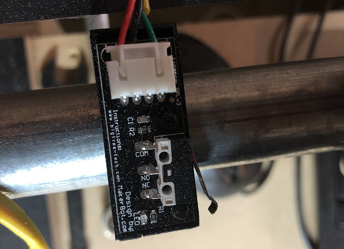

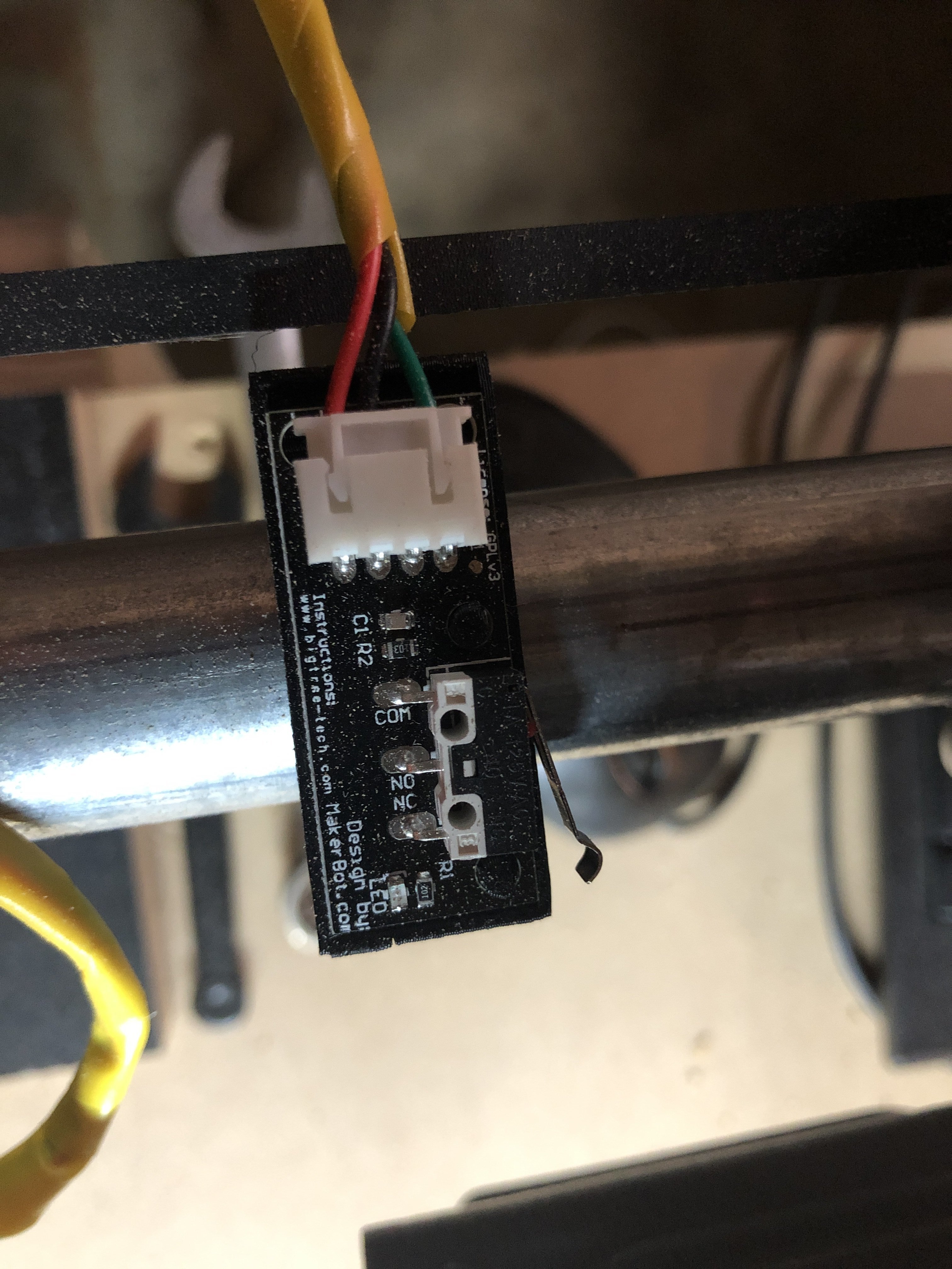

I’m using touch plate for Z, and Makerbot switches.
Carving / CNC WORK IS FINE.
I have read about noise threshold but didn’t seem to help.
It only goes 200mm per “home” unless you set your machine size in the firmware.
Thankyou.
It worked. Was able to home from distance.
I must have missed it in tutorials.
